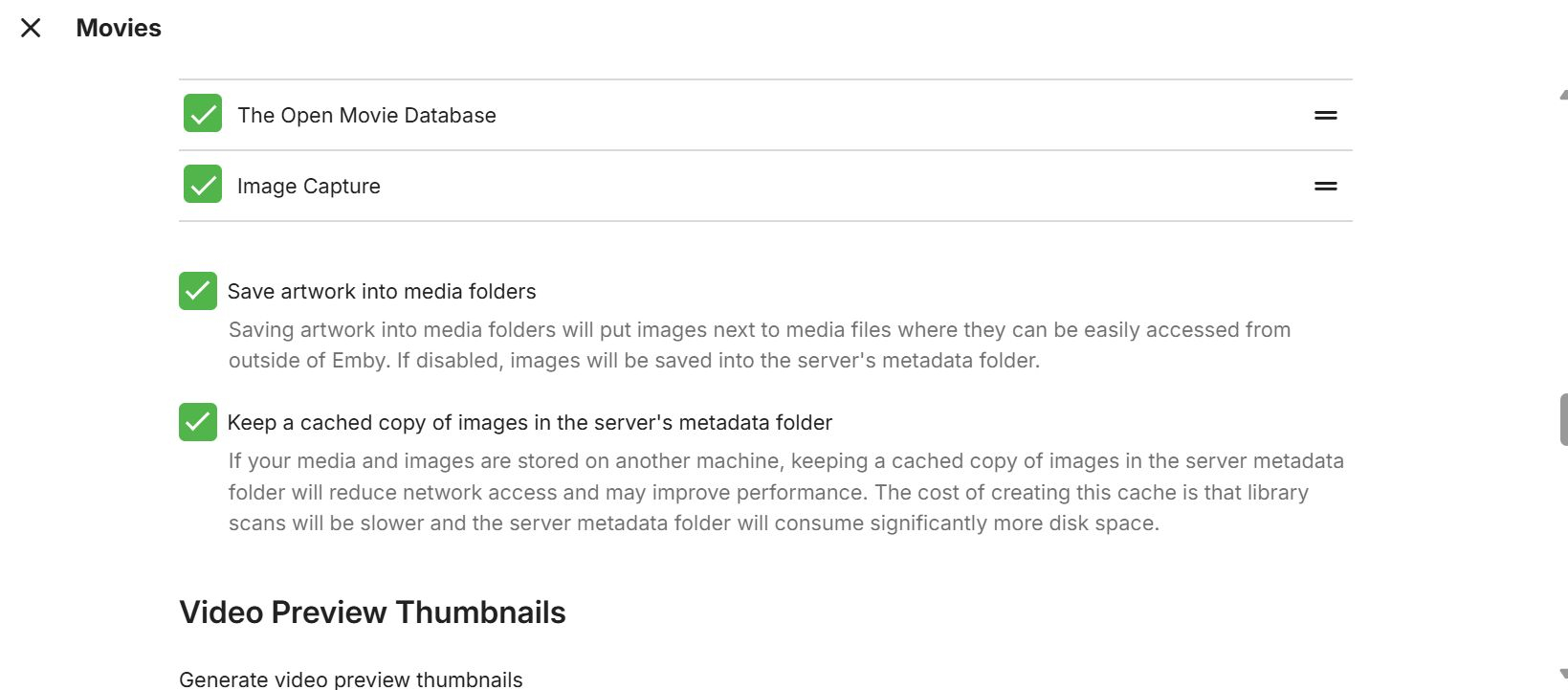

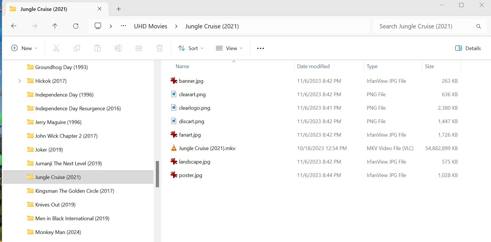

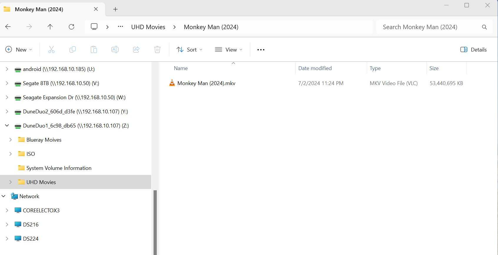

clarkss12 304 Posted July 3, 2024 Posted July 3, 2024 I setup a new server on a Synology NAS, now I don't get any information added to the video folder. I used to get all of the fanart, poster, etc jpg, now the folder is empty except for the video. I think I have set all of the settings correctly.

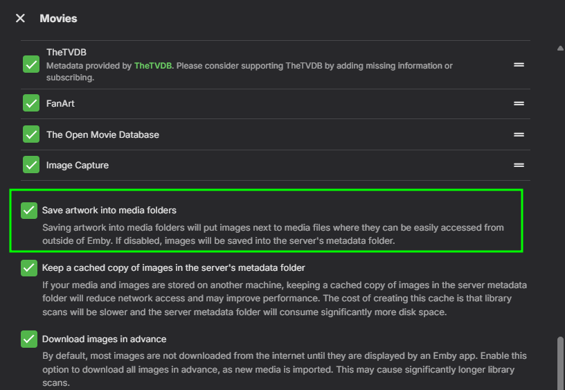

Neminem 1591 Posted July 3, 2024 Posted July 3, 2024 Did you forget to check this in your library settings ? 1

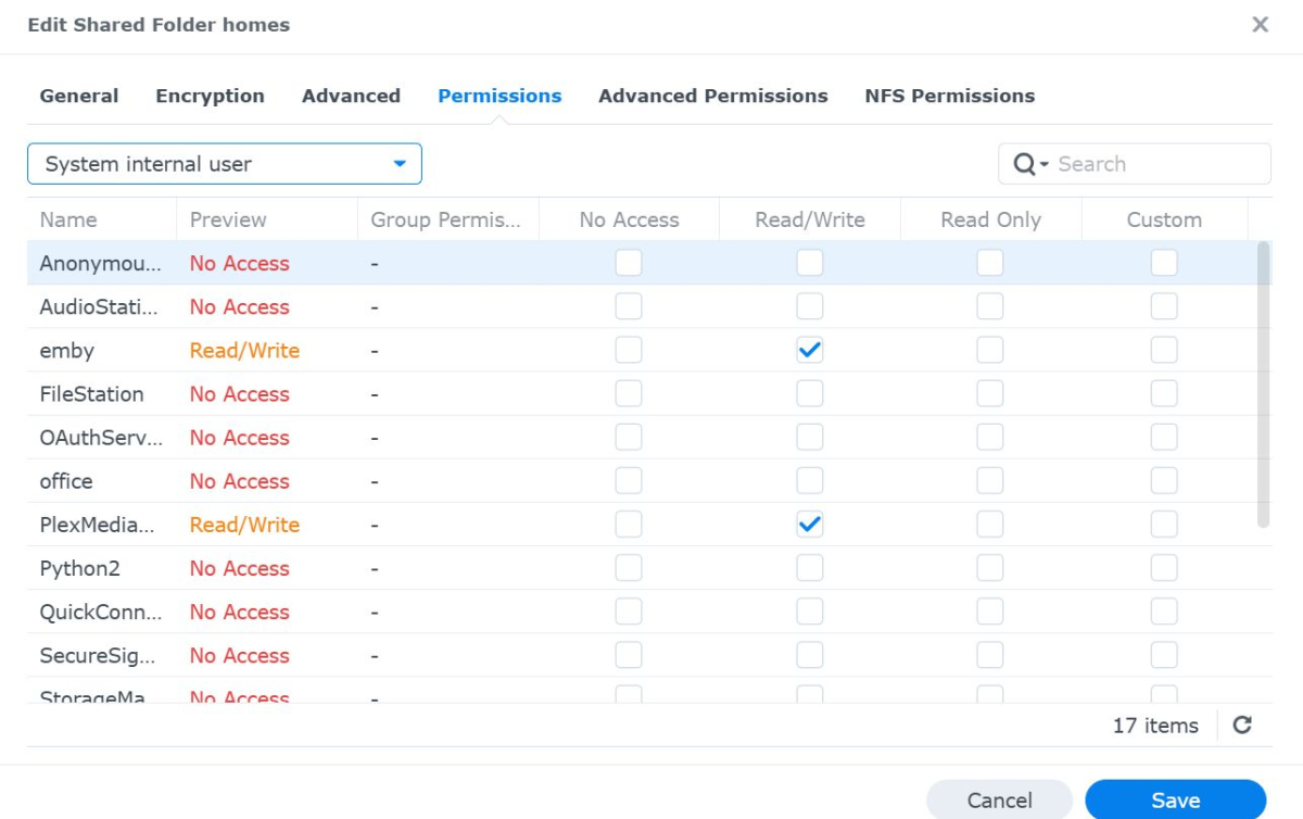

Happy2Play 9798 Posted July 3, 2024 Posted July 3, 2024 (edited) Or maybe a permissions issue of not being able to write to the folders. (notorious Synology issue) May need to see library setting and server log after say updating a image on the movie you showed above with the issue. Edited July 3, 2024 by Happy2Play
clarkss12 304 Posted July 3, 2024 Author Posted July 3, 2024 4 hours ago, jaycedk said: Did you forget to check this in your library settings ? Yes, those settings have been checked.
clarkss12 304 Posted July 3, 2024 Author Posted July 3, 2024 2 hours ago, Happy2Play said: Or maybe a permissions issue of not being able to write to the folders. (notorious Synology issue) May need to see library setting and server log after say updating a image on the movie you showed above with the issue. I think you are correct. Not sure how to give permission for Emby to write to the folders... Here is the server log. embyserver.txt
clarkss12 304 Posted July 3, 2024 Author Posted July 3, 2024 Yes, I added the permissions, it was NOT checked. Even after I checked the permissions, it still did not work. I went ahead and used Kodi to add the meta data to the folders. I removed a UHD movie folder and re-added it, but it still did not work.
Happy2Play 9798 Posted July 3, 2024 Posted July 3, 2024 Looks all related to smb shares. 2024-07-03 02:00:26.970 Error ChapterImagesTask: Error creating thumbnails for smb://192.168.10.107/DuneDuo1_6c98_db65/UHD Movies/Monkey Man (2024)/Monkey Man (2024).mkv *** Error Report *** Version: 4.8.8.0 Command line: /volume1/@appstore/EmbyServer/system/EmbyServer.dll -programdata /var/packages/EmbyServer/var -ffdetect /var/packages/EmbyServer/target/bin/ffdetect -ffmpeg /var/packages/EmbyServer/target/bin/ffmpeg -ffprobe /var/packages/EmbyServer/target/bin/ffprobe -nolocalportconfig -ignore_vaapi_enabled_flag -pidfile /var/packages/EmbyServer/var/EmbyServer.pid -defaultdirectory /volume1/Public -updatepackage emby-server-synology72_{version}_x86_64.spk Operating system: Linux version 4.4.302+ (root@build5) (gcc version 12.2.0 (GCC) ) #69057 SMP Fri Jan 12 17:02:28 CST 2024 Framework: .NET 6.0.25 OS/Process: x64/x64 Runtime: volume1/@appstore/EmbyServer/system/System.Private.CoreLib.dll Processor count: 4 Data path: /var/packages/EmbyServer/var Application path: /volume1/@appstore/EmbyServer/system System.IO.IOException: System.IO.IOException: Create Handle Failed: UHD Movies\Monkey Man (2024). NTStatus: FILE_DOES_NOT_EXIST at EzSmb.Transports.Shares.Handlers.Bases.HandlerBase..ctor(SmbType smbType, ISMBFileStore store, String path, HandleType handleType, NodeType nodeType, HandleArgs args) at EzSmb.Transports.Shares.Smb2Share.GetHandler(String path, HandleType handleType, NodeType nodeType, HandleArgs args) at EzSmb.Transports.Shares.Bases.ShareBase.CreateFolder(Node node, String folderName) at EzSmb.Node.CreateFolder(String folderName, String relatedPath) at Emby.Server.Implementations.IO.SmbFileSystem.CreateDirectory(String path) at Emby.Providers.MediaInfo.ThumbnailGenerator.CreateThumbnailSet(Video item, MediaStream videoStream, LibraryOptions libraryOptions, Int32 width, CancellationToken cancellationToken) at Emby.Providers.MediaInfo.ThumbnailGenerator.CreateThumbnailSets(Video item, MediaStream videoStream, LibraryOptions libraryOptions, CancellationToken cancellationToken) at Emby.Providers.MediaInfo.ThumbnailGenerator.RefreshThumbnailImages(Video item, MediaStream videoStream, LibraryOptions libraryOptions, IDirectoryService directoryService, List`1 chapters, Boolean extractImages, Boolean saveChapters, CancellationToken cancellationToken) Source: Emby.Server.Implementations TargetSite: Void .ctor(EzSmb.Params.Enums.SmbType, SMBLibrary.Client.ISMBFileStore, System.String, EzSmb.Transports.Shares.Handlers.Enums.HandleType, EzSmb.NodeType, EzSmb.Transports.Shares.Handlers.HandleArgs) 2024-07-03 04:34:39.974 Error ProviderManager: Error saving to smb://192.168.10.107/DuneDuo1_6c98_db65/UHD Movies/Monkey Man (2024)/clearlogo.png. Create Handle Failed: UHD Movies\Monkey Man (2024). NTStatus: FILE_DOES_NOT_EXIST. Only other topic with this I could find looks like a Docker topic.
clarkss12 304 Posted July 3, 2024 Author Posted July 3, 2024 The videos play fine, just not getting the metadata.
Solution Happy2Play 9798 Posted July 3, 2024 Solution Posted July 3, 2024 Don't know but Emby is choking on the smb libraries. But most likely will have to mount the shares. @FrostByteany ideas?

clarkss12 304 Posted July 3, 2024 Author Posted July 3, 2024 (edited) 2 hours ago, FrostByte said: I've always mounted shares using CIFS on my NAS in the past whenever the media is external. Not sure how Emby/DSM would gain write access to external storage w/o adding user permissions somehow. Thank you for reminding me. I did have to mount my exterrnal drives. So, maybe I have to add permissions. Now I have to figure out how I mounted those external drives..... Edit: I checked the permissions of each mounted drive and made sure "all users" were selected, some were not. Still does not help. As a test, I am editing images on a movie and selecting a different poster, but that poster does NOT download into that movies folder. It used to work, but not using the Synology NAS. Example, I purchase and rip a lot of 4k movies, and I like the thumbnail to show 4k heading on the movie poster. To get that poster to show up under Kodi, I go to that folder and select that poster with the 4k logo. Also, I don't think Trakt is working either. Edited July 3, 2024 by clarkss12
