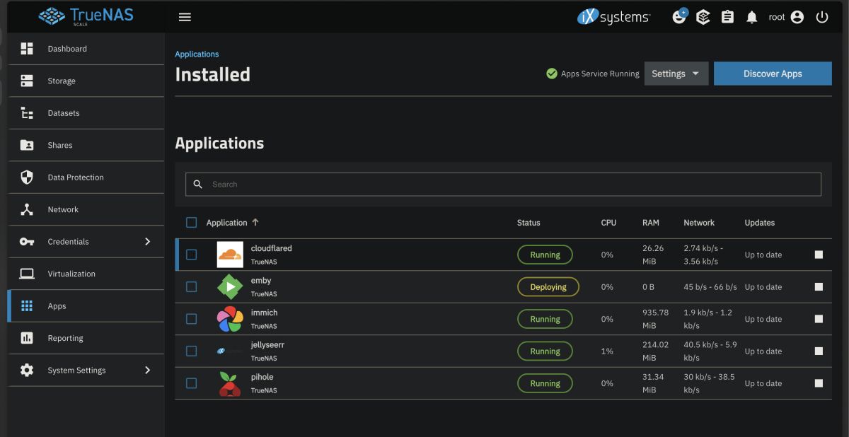

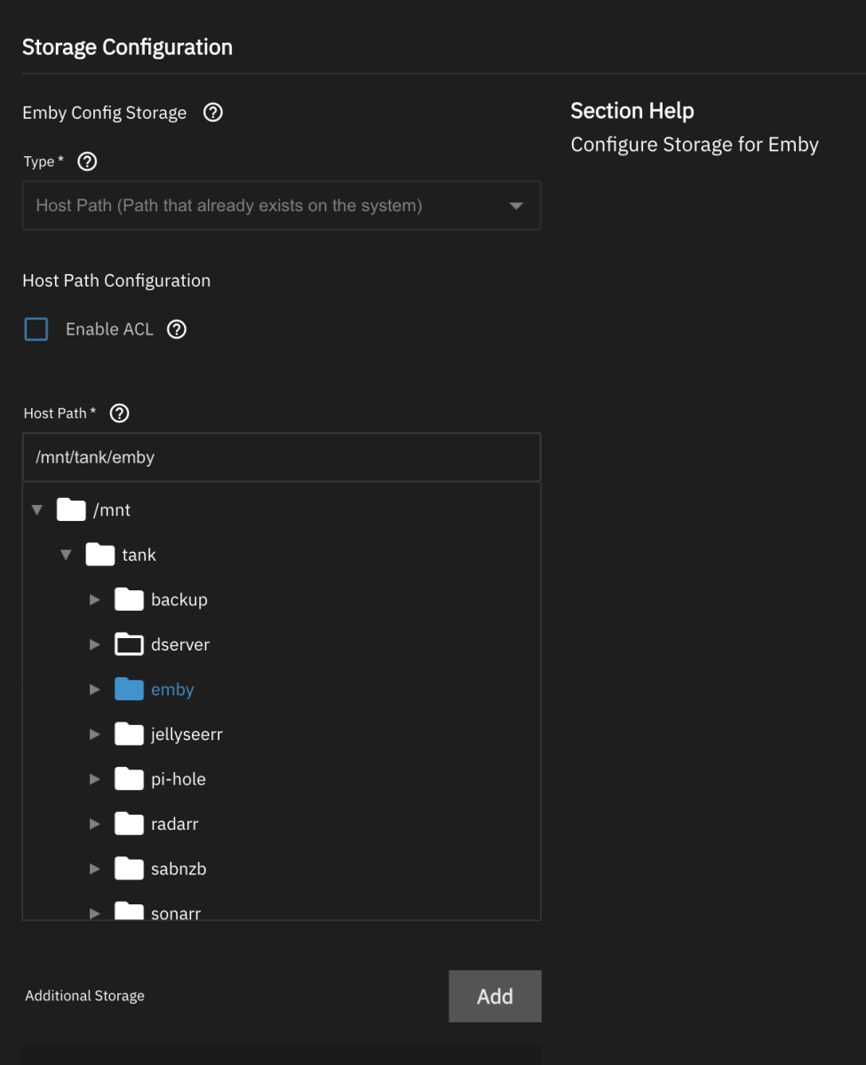

nicholas_davies 15 Posted July 3, 2024 Posted July 3, 2024 Hi all, I'm not sure if anyone on here can help me, but I though I might give it a shot. I have my Emby server on an old MacBook Pro. However, I recently got a mini PC on which I installed TrueNAS Scale and want to switch my Emby server. I installed the official TrueNAS Emby app from the “Discover Apps” section (I have screenshotted my config settings for Emby below). In the settings for the Emby app, I added the dataset “emby” where my backup folder is located (the most recent Emby server backup being yesterday). On the first boot-up of Emby, everything went fine. I was able to access the webpage and set up the server like normal. I activated my Emby Premiere, went to the restore backup section, and added the backup folder with no issues. When I clicked “restore from backup” it gave me the normal pop-up saying that the Emby server would be restarted, to which I clicked ok. However, when I went back to my TrueNAS GUI after telling the server to restore from the backup, Emby was stuck deploying and would be so for hours. I have searched for hours trying to find a solution and nothing has worked. I tried disabling SMB share, I tried creating another dataset specifically for the backup folder, and then adding that to the additional storage in the config settings for Emby, I tried changing permissions on all the datasets to full permissions, and none of these things have worked. Has anyone else experienced this issue? How do I fix this?

nicholas_davies 15 Posted July 6, 2024 Author Posted July 6, 2024 19 hours ago, Luke said: Where does it say deploying? Under apps and deployed

thermanbub 1 Posted October 9, 2024 Posted October 9, 2024 Hi, I had a similar issue (the 0s for cpu and ram are telling). I also had a deleted/moved dataset (your deleted/moved dataset is the outline folder dserver). My Emby instance was working and borked itself with the last update (4.8.10.0). Anyway I followed this post’s recommendation on folder structure and unallocated all the gpu compute nodes. Looking at the Related Kubernetes Events in the history section was key for me. I also started looking here, but the gpu messages solved it for me. I’d advise looking at the logs. 1
