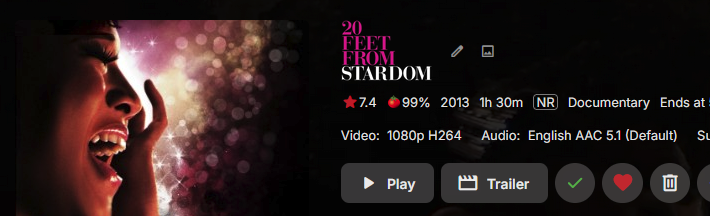

In detail page, we used to have multi genres displayed appropriately.
Now, it only display a single genre (first alphabetical), even though more are present in metadata.
Before (captured 2022)
Now

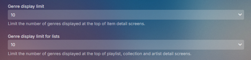

  • Solution
GrimReaper
Settings>Display, you can select how many Genres you prefer displayed on top.
Regardless of that setting, Media Info section at the bottom of the Detail page will list all of them.
  • Like 2
Happy2Play
Order is an issue as eventually it becomes alphabetical if ever saved in the UI.  Pretty sure there are other topics.  Yep your topic as you get initial provider or embedded order then Emby will reorder on any resave/edit.
But number of displayed genre is a user option now.
