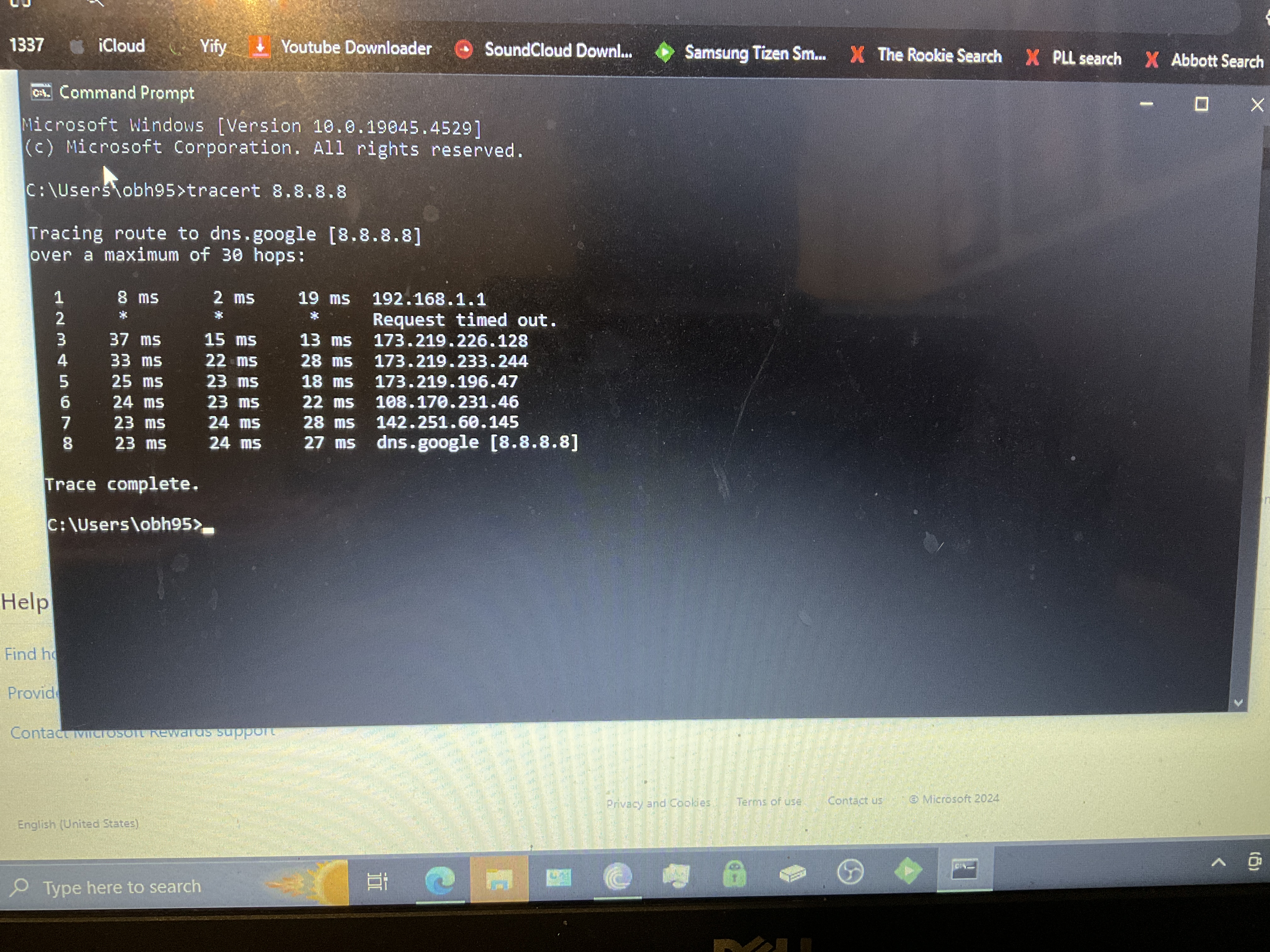

Happy2Play 9840 Posted June 28, 2024 Posted June 28, 2024 Minus your ISP changing something I am not sure as port forwarding is pretty straight forward. Have you deleted and readded the rules? What does a traceroute test show from the link above?
Brandon 2 Posted June 28, 2024 Author Posted June 28, 2024 1 minute ago, Happy2Play said: Minus your ISP changing something I am not sure as port forwarding is pretty straight forward. Have you deleted and readded the rules? What does a traceroute test show from the link above? Yeah I re did the port forward. What is a traceroute test?

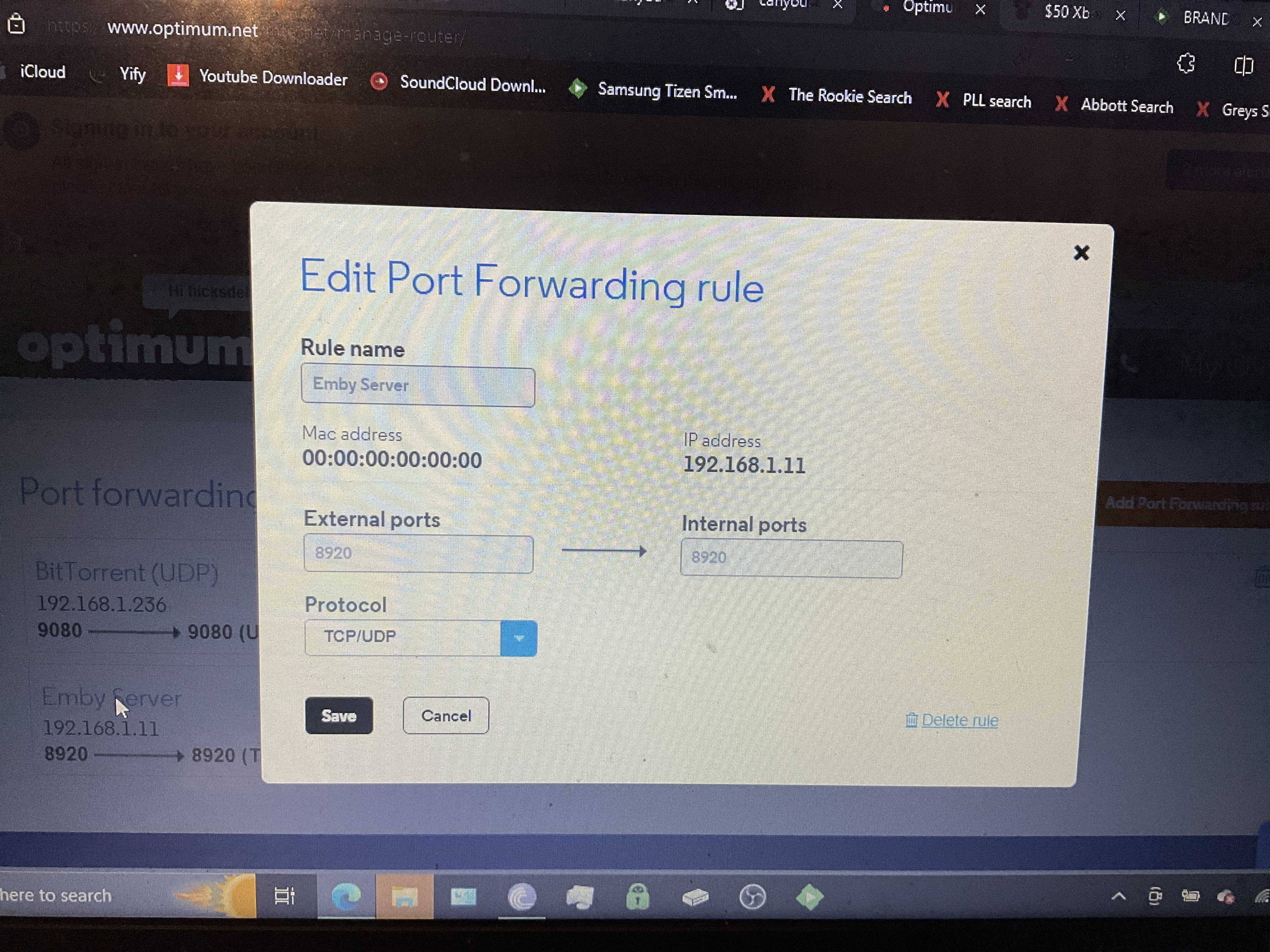

Luke 43409 Posted June 28, 2024 Posted June 28, 2024 1 minute ago, Brandon said: Yeah I re did the port forward. What is a traceroute test? Can you show us how you setup your port forwarding?
Happy2Play 9840 Posted June 28, 2024 Posted June 28, 2024 Might need to see a server startup log also. 4 minutes ago, Brandon said: What is a traceroute test? It is the link I provided you but test the route to that DNS server. To show if your ISP is using CGNAT. Test Your External Address
Brandon 2 Posted June 28, 2024 Author Posted June 28, 2024 9 minutes ago, Luke said: Can you show us how you setup your port forwarding? The MAC address wasn’t zeroed out like this earlier
Brandon 2 Posted June 28, 2024 Author Posted June 28, 2024 9 minutes ago, Happy2Play said: Might need to see a server startup log also. It is the link I provided you but test the route to that DNS server. To show if your ISP is using CGNAT. Test Your External Address
darkassassin07 690 Posted June 28, 2024 Posted June 28, 2024 Is the local ip of the server still 192.168.1.11 ? If you didn't set a static ip, that may have changed with a router reboot.

Brandon 2 Posted June 28, 2024 Author Posted June 28, 2024 1 minute ago, darkassassin07 said: Is the local ip of the server still 192.168.1.11 ? If you didn't set a static ip, that may have changed with a router reboot. It did change. I had it as an override to go to 192.168.1.11. So I am able to connect to it now on different devices on my WiFi. But still nothing on the remote ip

Solution darkassassin07 690 Posted June 28, 2024 Solution Posted June 28, 2024 19 minutes ago, Brandon said: It did change. I had it as an override to go to 192.168.1.11. So I am able to connect to it now on different devices on my WiFi. But still nothing on the remote ip You'll have to change the port forwarding rule to the new address then. (I got the old one from your forwarding rule screenshot)

Brandon 2 Posted June 28, 2024 Author Posted June 28, 2024 11 minutes ago, darkassassin07 said: You'll have to change the port forwarding rule to the new address then. (I got the old one from your forwarding rule screenshot) This worked! Had to delete and make new forwarding rules with the new local IP as it got changed with the modem reset. I shall remember this if it happens again. Thank you everyone for your assistance this late at night! 1 1
