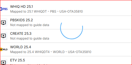

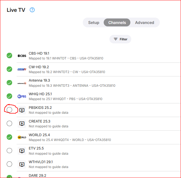

justinrh 263 Posted June 27, 2024 Posted June 27, 2024 Server 4.8.8.0 / Windows 10 / Firefox browse to admin > Live TV > Channels check on a channel that is currently unchecked click the channel to open the Edit dialog - observe the dialog is empty and the spinner never goes away X close the dialog - observe the spinner remains I get an uncaught promise error in the console.

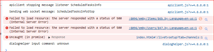

Luke 42184 Posted July 1, 2024 Posted July 1, 2024 OK can you try this again and supply the contents of the browser's debug console? thanks.
justinrh 263 Posted July 1, 2024 Author Posted July 1, 2024 (edited) Are you saying it is only me? from Edge: Edited July 1, 2024 by justinrh
Luke 42184 Posted July 2, 2024 Posted July 2, 2024 Can you try clearing browsing data and seeing if that helps?
sa2000 690 Posted July 2, 2024 Posted July 2, 2024 (edited) @LukeThis is reproducible - I did a test in a browser private incognito session. The Edit channel for a deselected channel goes to metadata edit screen which is not the right one for channel editing. After deselecting a mapped Live TV channel, and clicking on it to edit, we lose the mapping and the edit loads the edit media metadata screen and the spinner shows The test I did was on 4.8.8.0 I have wireshark capture plus logs and json and db files which I will make available Edited July 2, 2024 by sa2000 2

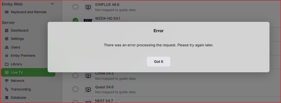

justinrh 263 Posted July 27, 2024 Author Posted July 27, 2024 (edited) @Luke, add to this: go into Live TV > Channel, uncheck a channel - get error: Console says "Uncaught (in promise) undefined " Edited July 27, 2024 by justinrh
Luke 42184 Posted August 14, 2024 Posted August 14, 2024 On 7/27/2024 at 2:20 PM, justinrh said: @Luke, add to this: go into Live TV > Channel, uncheck a channel - get error: Console says "Uncaught (in promise) undefined " Hi, please attach the emby server log from when the problem occurred: How to Report a Problem Thanks !

Luke 42184 Posted September 13, 2024 Posted September 13, 2024 OK the issue is that when you re-enable, it kicks off a guide refresh. Once it gets far enough that the channel has been recreated, then t will be editable. So that part needs improvement. Thanks. 1
