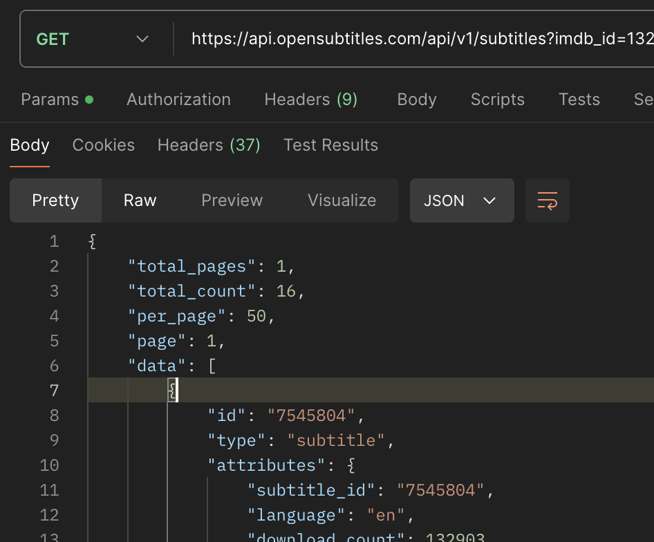

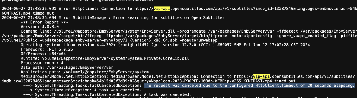

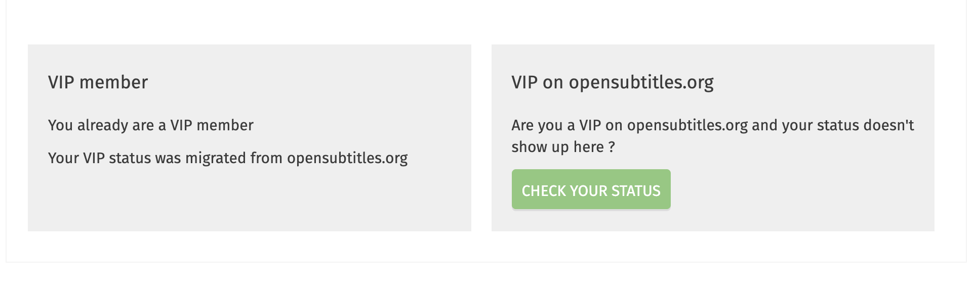

thanet31756 0 Posted June 27, 2024 Posted June 27, 2024 Hello guys, My emby is failed on subtitle loading recently. I tried to debug and find out that the request to opensubtitles is timeout everytime You can check the screenshot below. I Then I test by calling api directly. and the result is https://vip-api.opensubtitles.com/api/v1/subtitles?imdb_id=13287846&languages=en&moviehash=54b15d03f3d89e82&query=Napoleon.2023.PROPER.1080p.WEBRip.x265-KONTRAST.mp4 { "errors": [ "Invalid domain" ], "status": 401 } but when I change from vip-api to api, it's working normal. I've already been the VIP member of opensubtitle long time ago. Anyone know what happen?
thanet31756 0 Posted June 27, 2024 Author Posted June 27, 2024 2 minutes ago, jaycedk said: Did you move your account from .org to .com ? yes, I already created account and already download some subtitle.

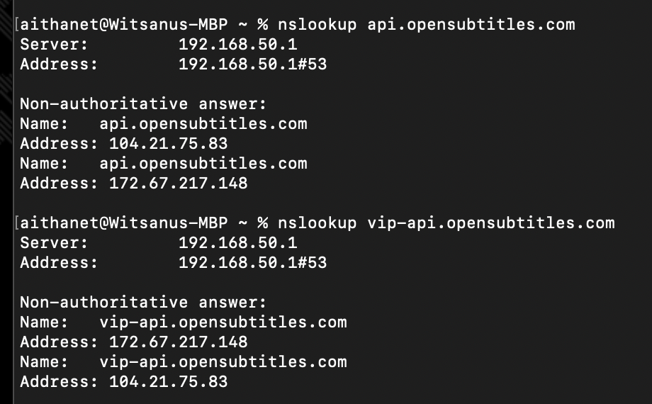

rbjtech 5417 Posted June 27, 2024 Posted June 27, 2024 (edited) "nslookup vip-api.opensubtitles.com" returns a valid ip for me - are you sure your DNS lookup is good ? edit "nslookup api.opensubtitles.com" returns the same IP's .. Edited June 27, 2024 by rbjtech 1
Neminem 2007 Posted June 27, 2024 Posted June 27, 2024 (edited) From you limited logs, I think you have network issues ( Using VPN / DNS / Firewall ) But cant tell. Devs would need the complete logs. Edited June 27, 2024 by jaycedk
thanet31756 0 Posted June 27, 2024 Author Posted June 27, 2024 it's also point to same ip. I don't know why I call api endpoint and got result but vip-api endpoint got invalid domain.
thanet31756 0 Posted June 27, 2024 Author Posted June 27, 2024 embyserver.txthere, I look through it many time but it always return timeout
Happy2Play 9840 Posted June 27, 2024 Posted June 27, 2024 But your issue is almost all external communications timing out. Embyadmin Podnapisi Open Subtitle (api and vip-api) Moviedb OMDB So maybe VPN/Firewall/Security software? 2
Neminem 2007 Posted June 27, 2024 Posted June 27, 2024 Opensubtitles are not you only issues. 2024-06-27 21:23:49.026 Error HttpClient: Connection to https://www.mb3admin.com/admin/service/EmbyPackages.json timed out 2024-06-27 21:23:49.037 Error App: Error getting available plugin updates And later 2024-06-27 21:27:52.925 Error HttpClient: Connection to https://www.podnapisi.net/subtitles/search/old?sXML=1&sL=en&sK=Napoleon&sY=1480 timed out 2024-06-27 21:27:52.934 Error SubtitleManager: Error searching for subtitles on Podnapisi 39 minutes ago, jaycedk said: I think you have network issues ( Using VPN / DNS / Firewall ) Something is blocking you outgoing requests. 1

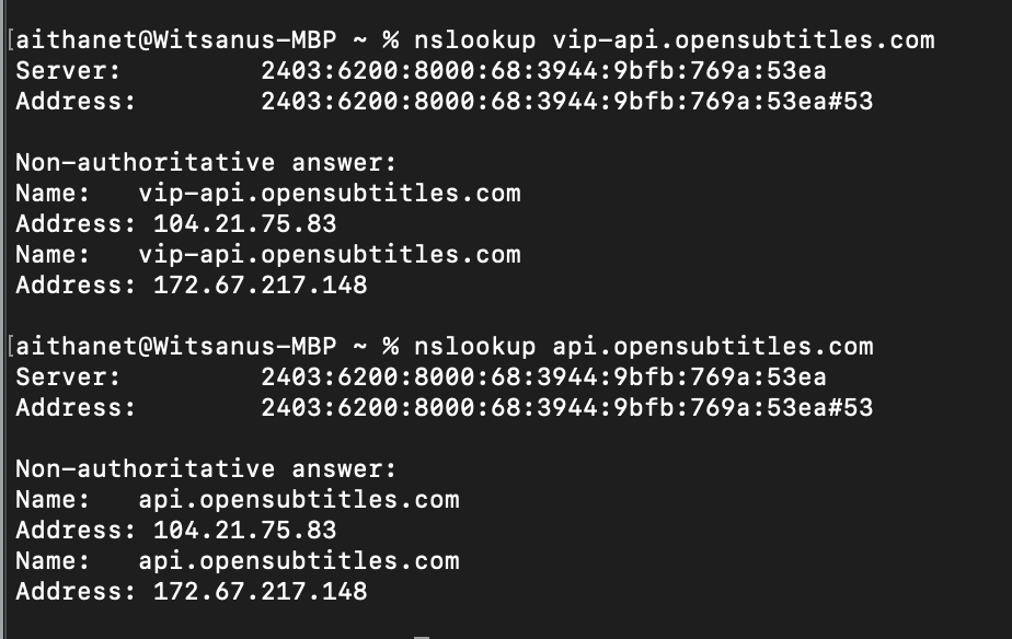

thanet31756 0 Posted June 27, 2024 Author Posted June 27, 2024 I just check all the setting VPN - not using any DNS - 8.8.8.8 Firewall - just tried turn off it’s still not working

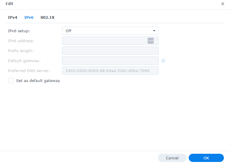

thanet31756 0 Posted July 20, 2024 Author Posted July 20, 2024 On 15/07/2024 at 23:11, Luke said: OK let us know what you find. Thanks. @LukeHi Luke, I just found the root cause. It just because IPv6 is turn on in synology nas network setting. @jaycedkmentioned about this problem before but I just turn IPv6 off only in router setting, I didn't turn it off in my nas network setting.
