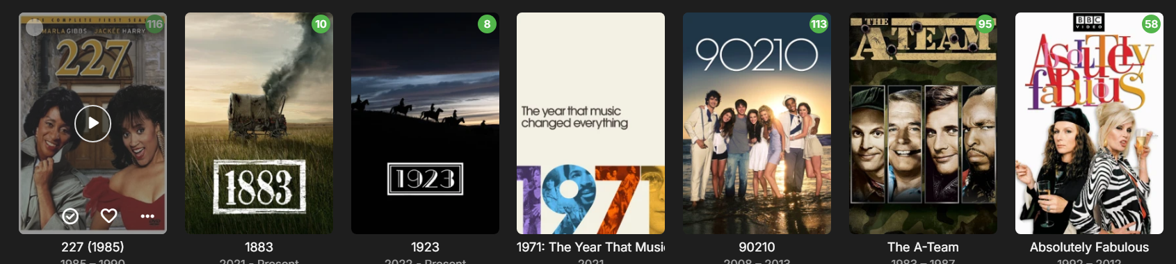

RanmaCanada 503 Posted June 24, 2024 Posted June 24, 2024 Now that my Mythbusters has been solved, I have another issue. I have an extensive TV library that is on my NAS on a mapped drive, that has worked since I built the darn thing in 2014. During the last update it appears that my TV shows have decided to not be populated in Emby. They have .nfo files with full descriptions, but the shows themselves in the Emby library show them as emtpy. What's odd, is it is not every single show that is doing this. If I go into a season that has a poster but no episodes listed and I try to press play I getembyserver (3).rar "No playable items were found. Are you trying to play an empty folder?" I have even attempted to remove directories and put them back in and do a library scan, and nothing. Some TV shows are populated, others just have their posters with 0 entries. All files are fine, all paths are available. The OG path was to the actual server which has worked for every other library, so I changed it to the actual mapped drive letter (\\Tower\tv vs U:\ the mapped drive letter, I've also added the direct network path) and still not doing what it should be. As you can see files are named correctly, directories are named correctly, and the tvshow.nfo is from 2022, when the series was last updated. I've included my server log. Thanks a bunch.

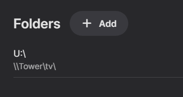

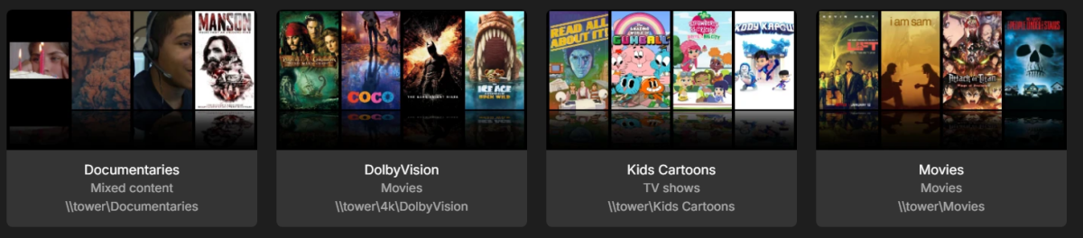

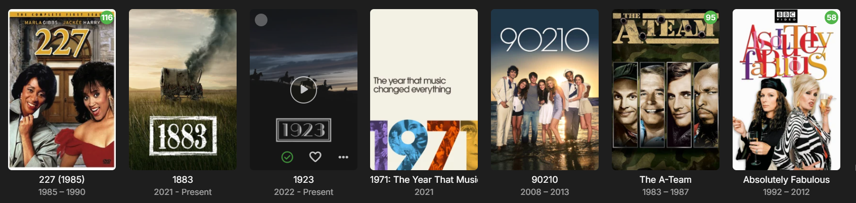

RanmaCanada 503 Posted June 24, 2024 Author Posted June 24, 2024 This was my TV library. Only one folder was created for the library. Since I have moved it to the mapped drive instead of a direct path, it now appears to be functioning as it is STILL scanning the library 8 hours later. I don't know why this would suddenly break when it was fine for years. As you can see, titles are populating with shows again.

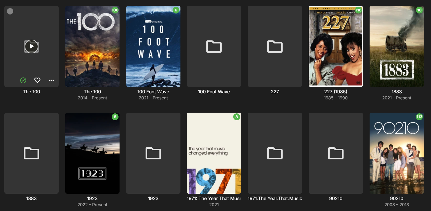

RanmaCanada 503 Posted June 24, 2024 Author Posted June 24, 2024 The scan is finally complete and now my TV library is completely, totally F'd. What the heck has happened? embyserver (4).rar
Solution sa2000 703 Posted June 25, 2024 Solution Posted June 25, 2024 13 hours ago, RanmaCanada said: The scan is finally complete and now my TV library is completely, totally F'd. What the heck has happened? Do you now have both "U:\" and "\\tower\TV" as library folder paths for libraries ? The TV shows are doubling up in your view 2024-06-24 00:00:58.102 Debug SqliteItemRepository: GetitemById Folder 1054521 \\tower\TV 2024-06-24 00:00:58.102 Debug SqliteItemRepository: GetitemById Folder 1591591 U:\ So do you have both as separate folder paths in the library settings ? Make sure you only have one or the other - but you could add the UNC path in the optional Shared Network Folder field in library setup I tested out where you have a mapped drive path and the UNC path in the optional field in library folder setup and that did not give rise to both paths appearing as separate folder ID's in the log. Could you give details of which libraries have these paths and also give screenshots of the library folder paths and if you are making use of the optional UNC path to supplement the direct path? In my tests, I had the following which would show as
RanmaCanada 503 Posted June 25, 2024 Author Posted June 25, 2024 I only have one as per my picture. This is frustrating as every tv show that had missing data, are now the ones that are blanks and I have no means to remove them at all. it doesn't make sense with what has happened. Why would a path that has worked for years suddenly stop and cause data to "go missing" and then duplicate. Do I need to just remove the entire tv library and start it over from scratch?

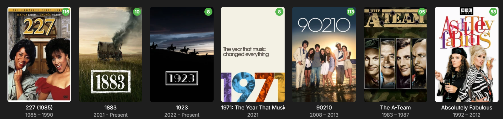

RanmaCanada 503 Posted June 26, 2024 Author Posted June 26, 2024 I believe both folders were as I had no TV Shows Library at all when it was successfully removed. I currently have a functional library for TV shows. It did take a few hours for it to rescan but as it stands right now there are no duplicates and from a quick glance nothing is "broken". Thank you for all your help @Happy2Playand @sa2000I am not sure what to mark as the solution as it was solved by removing the library altogether and then waiting and waiting, then re-adding it.

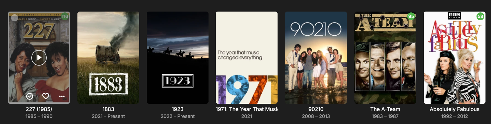

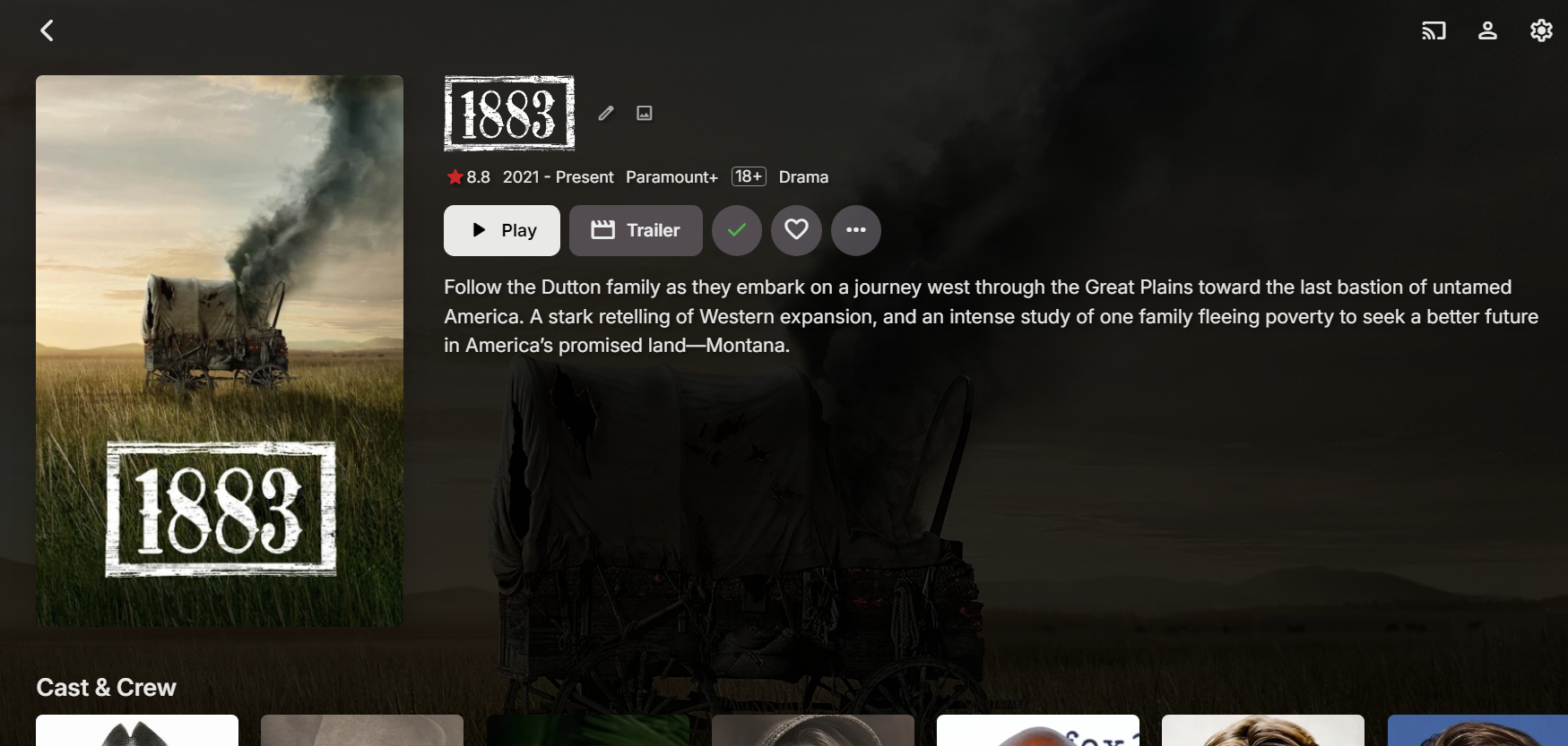

RanmaCanada 503 Posted July 3, 2024 Author Posted July 3, 2024 Well it's back again. I have no idea wtf is going on but this is ridiculous. I would really like to know what exactly is causing this. I am attempting to rescan my library to get my items back, but if I have to do this every single time something breaks, it's an unfeasible option. embyserver (2).7z
Luke 42289 Posted July 3, 2024 Posted July 3, 2024 1 minute ago, RanmaCanada said: Well it's back again. I have no idea wtf is going on but this is ridiculous. I would really like to know what exactly is causing this. I am attempting to rescan my library to get my items back, but if I have to do this every single time something breaks, it's an unfeasible option. embyserver (2).7z 1.61 MB · 0 downloads Hi, what exactly is back? What issue do these screenshots indicate?

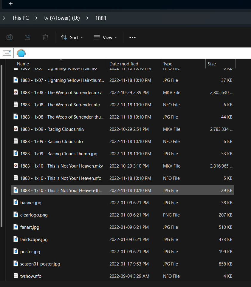

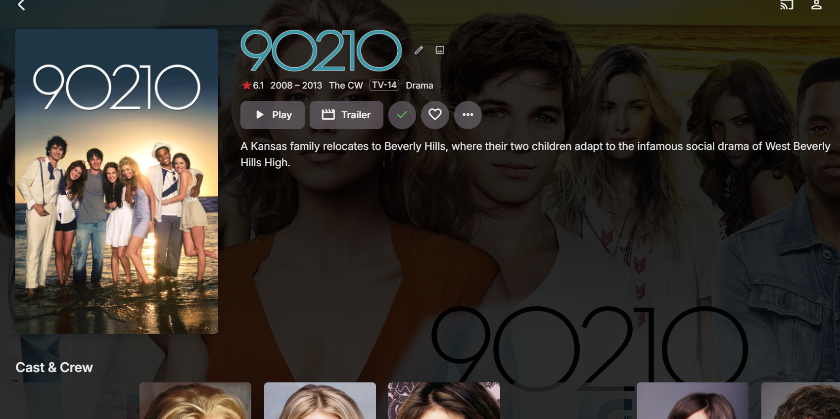

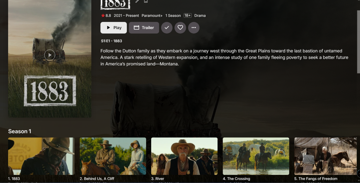

RanmaCanada 503 Posted July 3, 2024 Author Posted July 3, 2024 Library items are recognized, but there no contents in the folder. For example, 90210 is recognized as a series, but there is nothing listed on Emby when you click on the series itseslf. The files are still on my server, still have their .nfo and xml content and are recognized in Plex fine, but Emby has decided that this item exists, but none of the content is there.
Luke 42289 Posted July 3, 2024 Posted July 3, 2024 OK Now I see, the seasons and episodes are empty for that series. Can you please respond to the question that was asked earlier: Quote HI there, how many emby libraries are created, and what folder paths are added to each one?
