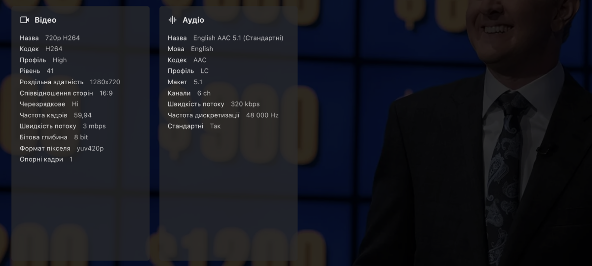

Emby can't see subtitles inside the mkv file
It seems that Emby doesn't recognize vtt subtitles the are inside the mkv file. I've attached screenshots for a file as the Emby server sees it (first one) and then the same file opened in MKVToolNIX (2nd screenshot) and VLC (3rd screenshot).
I am running Emby server 4.8.8.0 on Synology NAS DS218.
  • Agree 1
HI, please try refreshing the metadata on it and see if that helps.
Unfortunately, neither metadata refreshing nor folder scanning helped subtitle track to appear in Emby.

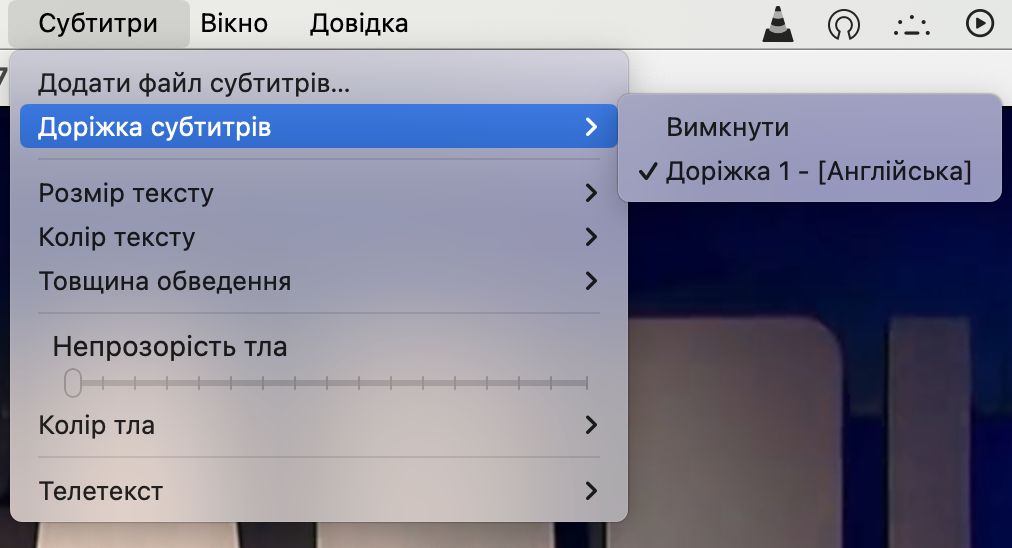

3 minutes ago, Happy2Play said:
Looks like they are unsupported.
The funniest thing is that these subtitles were made by Emby.
My NAS doesn't have a strong CPU to transcode on the fly, so I convert files to AAC in advance. And while converting it always exports embedded SRT subtitles to an external VTT file. So these VTT subtitles that are now inside MKV file were once external VTT subtitles created by Emby from embedded SRT subs.
That's why it is so surprising for me that they are unsupported.
Happy2Play
Yes I am pretty sure I have seen other topics the show these webvtt subs in images for conversions.  But have not tested this myself.  But adding this file to release and beta don't show the sub.  But I am sure Luke will know what the issue is.  Will look for other topics on subs though.
Happy2Play
Topic I was thinking of show them as external subs.  But can say Media Player does not see these internal subs either so I would guess lots of players don't support them yet but will say they work as external subs.
Now I don't know much about these subs but can they be internal subs as they display fine as external subs? @Luke
Yea I guess ffprobe does not detect them. Embedded vtt is not something you see very often.
