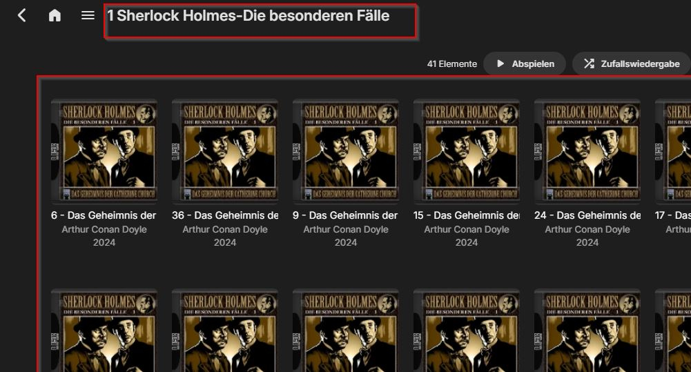

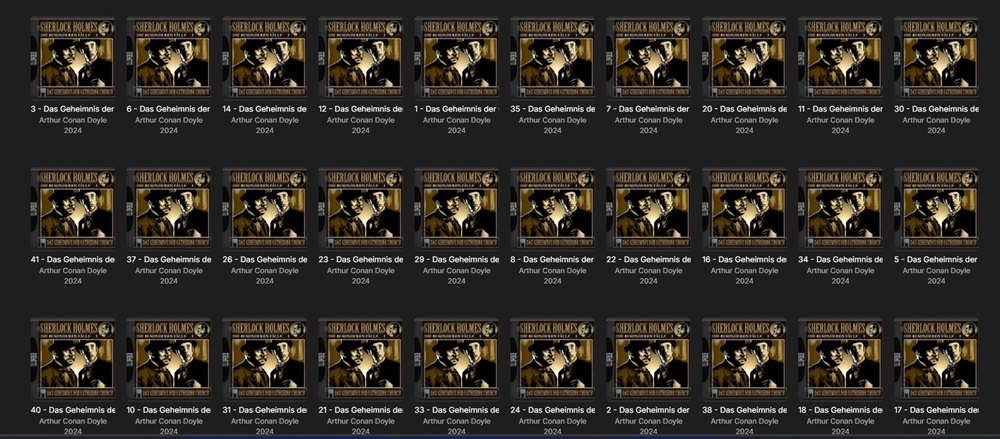

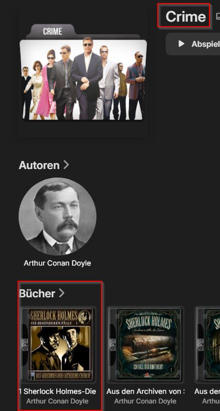

paddy75 16 Posted June 21, 2024 Posted June 21, 2024 (edited) hi, i have the following problems. I use mediamonkey to tag and organize audiobooks and music If I add a genre in the mp3 tag for an audiobook the normal behavior is this: The whole audiobook is grouped then with this genre. Everything is fine In mediamonkey I also can add a tag "grouping" which is the same in emby called "tag". If I use this, and open the audiobook, it looks like this: each track is listed separately and they are not grouped. I think the normal behavior should be the same as it is for genre. this happens for audiobooks and music. second problem: If I update/change the genre and do a library scan, they are not updated. The only way to solve this problem is to remove the files from the storage, rescan the library and then remove them back to the library with a following rescan. Edited June 21, 2024 by paddy75

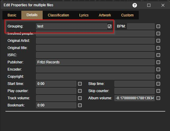

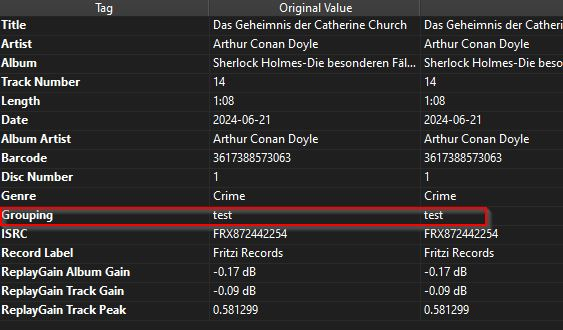

paddy75 16 Posted June 22, 2024 Author Posted June 22, 2024 10 hours ago, Luke said: How did you get to the second screenshot? everything looks grouped to me. Here an example: in media monkey i added for the whole audiobook the grouping "test" here a screenshot from musicbrainz for crosschecking: after the scan a new tag in emby is created: Here is the result after you clicked on the new tag:
Luke 42184 Posted June 22, 2024 Posted June 22, 2024 What do the screenshots tell us? I don't quite understand, sorry.
Happy2Play 9798 Posted June 22, 2024 Posted June 22, 2024 Looks correct to me as it is showing you every item with that TAG. But sounds like you only want the book to show via tag not individual items.
Happy2Play 9798 Posted June 22, 2024 Posted June 22, 2024 (edited) But testing this it displays all tracks with tag as expected. As Book itself never gets the Tag but even if it did you would have the book and all tracks. I guess should book level get the tag also just like it gets genre from tracks? @Luke But the end result is not what OP expects. 15 hours ago, paddy75 said: second problem: If I update/change the genre and do a library scan, they are not updated. The only way to solve this problem is to remove the files from the storage, rescan the library and then remove them back to the library with a following rescan. What exactly are you doing? As I updated genre the same way I applied grouping field and they were both seen. But yes sometime a Refresh is needed vs a library scan when changing tags in my testing. Edited June 22, 2024 by Happy2Play
paddy75 16 Posted June 22, 2024 Author Posted June 22, 2024 59 minutes ago, Happy2Play said: Looks correct to me as it is showing you every item with that TAG. But sounds like you only want the book to show via tag not individual items. correct. if you tag an music album for example, and each item has a different genre, they are also not listed separately because they are part of the album right?
Happy2Play 9798 Posted June 22, 2024 Posted June 22, 2024 Just now, paddy75 said: correct. if you tag an music album for example, and each item has a different genre, they are also not listed separately because they are part of the album right? Personally you can't compare genres and tags even though they really do pretty much the same thing it is just from the devs design level on how they will propagate. So if I tag one track to be block I don't want the entire album blocked. So it really comes back to purpose.
Happy2Play 9798 Posted June 22, 2024 Posted June 22, 2024 Also from a Genre aspect it will show multiple levels so yes it will show Author, Book, and Chapters as it technically propagates to all level from track data.
paddy75 16 Posted June 22, 2024 Author Posted June 22, 2024 so at the end i can't use the mp3 ID TAG "Group" then and must set it in the album/audiobook directly
Happy2Play 9798 Posted June 22, 2024 Posted June 22, 2024 Just now, paddy75 said: so at the end i can't use the mp3 ID TAG "Group" then and must set it in the album/audiobook directly Correct as I don't know of a way outside of Emby to get what you want.
