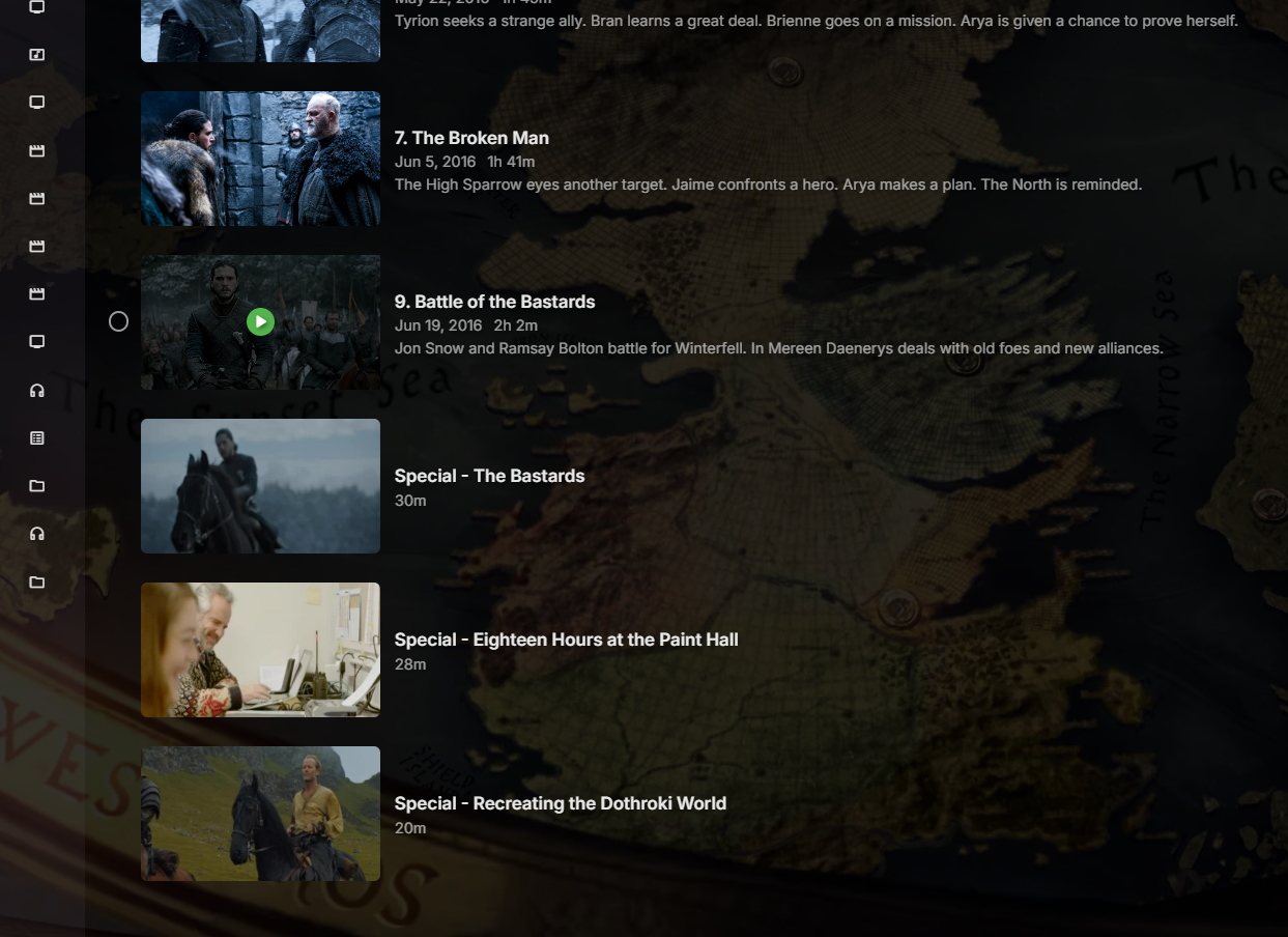

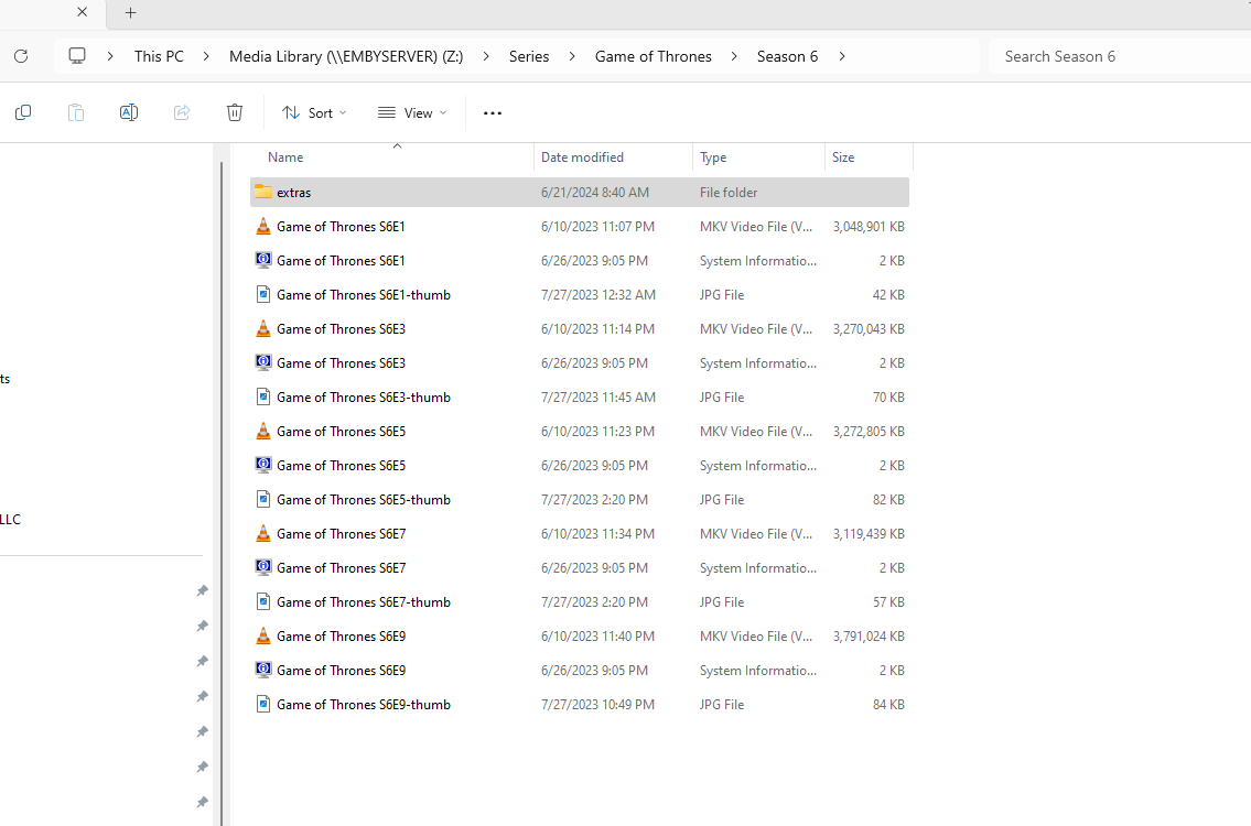

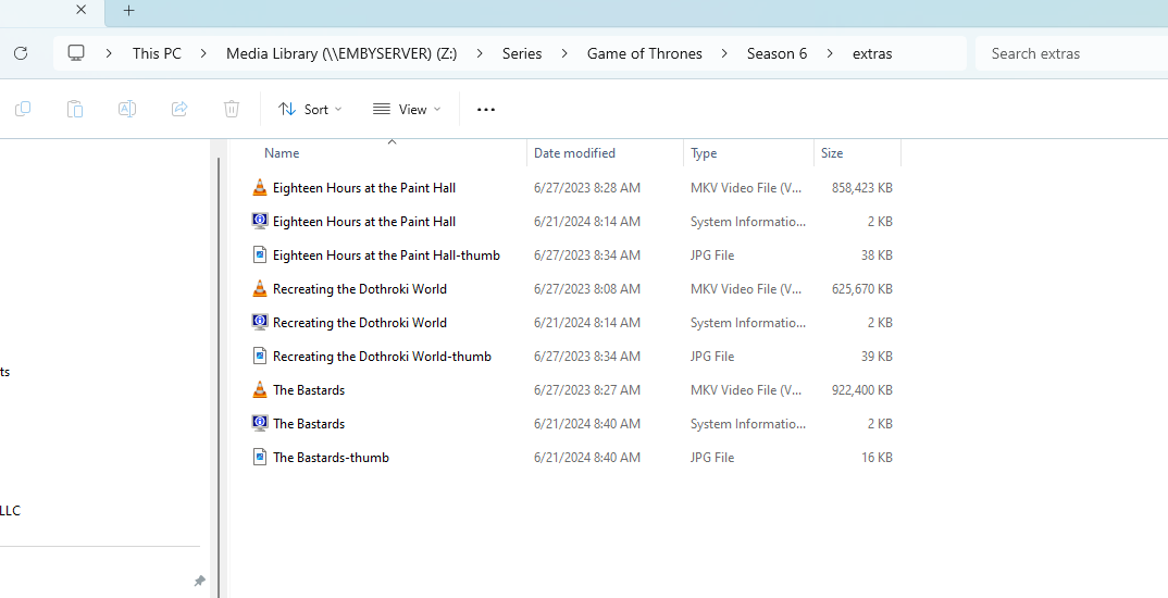

dcruff 15 Posted June 21, 2024 Posted June 21, 2024 Server: Unraid 6.12.10 Clent: Android Samsung S2+ Testing: When selecting Episode 9 of Game of Thrones, Emby gets confused and selects a file from the 'extras' folder of the same name as the name of the episode 'Battle of the Bastards'. This does not happen when I am on my local network using the Wifi (which also has the Unraid Emby Server). But when I turn off my wifi and go through the internet over the air, the extras file is pulled up instead of the episode file. I learned about this problem when my nephew contacted me to tell me that he could not bring up Episode 9. Through my testing, I found that everything works fine if I remove the 'extras' folder. My last test was also successful, when I put the 'extras' folder back on the server in the 'Season 6' folder, but changed the file name of the 'extra' file to just "The Bastards". Now when I pull up Episode 9, it plays correctly. Here are the file paths that I'm using: \\EMBYSERVER\Series\Game of Thrones\Season 6\extras - with all of the files stored as MKV and all of the episodes on the 'Season 6' folder and all of the extras in the 'extras' folder. Again, this is weird that the correct files are pulled up when accessed locally over my Wifi, but now when accessed remotely. Additional note: When accessing my Emby Server on Windows through the IP Address, I have the same problem as when accessing it over the internet on my phone - the file from the extras folder is accessed instead of the correct episode file. Here's the address that I use from Windows: '192.168.146.29.8096/web/Index.html#!/item?id=131834&serverId=5ef73016eeb6482dbaf272865d2c01c6'
GrimReaper 4896 Posted June 21, 2024 Posted June 21, 2024 Wild guess would be your extras are being multi-versioned as related episodes and Emby is picking version that'll play most efficiently under current circumstances (network, client etc.), but without server log and screenshot of your filefolder structure/naming - it'd be anyone's guess. Did you have multi-version dropdown in episode 9 detail screen under original conditions? 52 minutes ago, dcruff said: When selecting Episode 9 of Game of Thrones, Emby gets confused and selects a file from the 'extras' folder of the same name as the name of the episode 'Battle of the Bastards'.
Luke 42242 Posted June 21, 2024 Posted June 21, 2024 HI there, can you show us exactly your folder and file organization and naming? Thanks.
dcruff 15 Posted June 21, 2024 Author Posted June 21, 2024 The episodes are grouped in 2's, meaning that S6E1 is episodes 1&2 and so on. This shows what I got after I renamed one of the 'extras' to "The Bastards". Now it works fine. Bit it didn't work fine when the file was named, "Battle of the Bastards", which is the same name that came from the acquired metadata for episode 9. 1

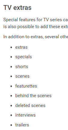

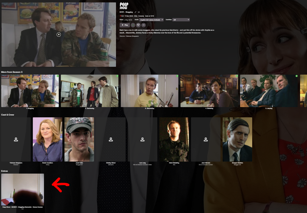

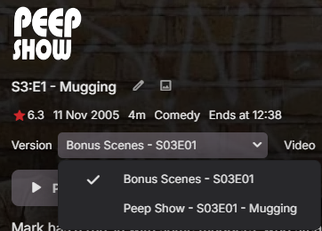

ginjaninja 605 Posted July 20, 2024 Posted July 20, 2024 I have the same issue. I notice Emby TV Naming wiki, shows folder 'extras' is supported. so i have \\x99\x99i\tv03\Peep Show\Extras\Bonus Scenes - S03E01.mkv But Emby is interpreting the extra as a version of the episode. Worse selecting it as the default episode. Trying to be season folder agnostic is an admirable goal, a la I assume my version semi cleverness example was not intended? but if it was, shouldn't files (versions) which are actually in season folders (when present) take priority as the real primary episode content... But isnt a fuller solution needed for TV Extras more to the point?.... ie. Prevent files in subfolders which are not prescribed season subfolder names, from muddying the waters, and just present them as flat filenames to begin with. or prescribe 1 failsafe sub folder name that can be used that will never muddy the waters and contaminate the real episode list and just present the filenames. And if in time the client UIs can be upgraded to fully support TV Extras Folders as per the wiki... then show the files in those respective folders , in their respective seasons for navigation/selection and playback. There will always be extra content which is related to a particular episode so i dont think extras with SXXEYY in their filename can go away..

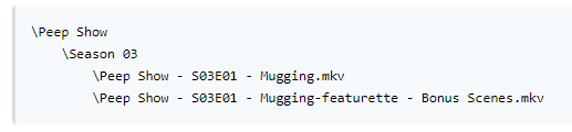

sa2000 697 Posted July 26, 2024 Posted July 26, 2024 On 20/07/2024 at 13:02, ginjaninja said: \\x99\x99i\tv03\Peep Show\Extras\Bonus Scenes - S03E01.mkv As this is season specific / episode specific, could you try out these variations \Peep Show \Season 03 \Peep Show - S03E01 - Mugging.mkv \Extras \Bonus Scenes - S03E01.mkv \Peep Show \Season 03 \Peep Show - S03E01 - Mugging.mkv \featurettes \Peep Show - S03E01 - Bonus Scenes.mkv \Peep Show \Season 03 \Peep Show - S03E01 - Mugging.mkv \Peep Show - S03E01 - Mugging-featurette - Bonus Scenes.mkv and see if they make a difference

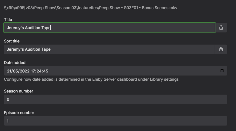

ginjaninja 605 Posted July 26, 2024 Posted July 26, 2024 sure tested on 4.9.0.28 \Peep Show \Season 03 \Peep Show - S03E01 - Mugging.mkv \Extras \Bonus Scenes - S03E01.mkv detected as S00E01 \Peep Show \Season 03 \Peep Show - S03E01 - Mugging.mkv \featurettes \Peep Show - S03E01 - Bonus Scenes.mkv detected as s00e01 Bingo!! So what is the conclusion?
sa2000 697 Posted July 29, 2024 Posted July 29, 2024 On 26/07/2024 at 14:55, ginjaninja said: Bingo!! Thanks for doing all the tests - So it only worked when it was added at the episode level. Could you give me the whole directory structure for the Peep Show. Would like to see how the link to S00E01 arose for the other variations.
ginjaninja 605 Posted July 29, 2024 Posted July 29, 2024 (edited) 2 hours ago, sa2000 said: Thanks for doing all the tests - So it only worked when it was added at the episode level. Could you give me the whole directory structure for the Peep Show. Would like to see how the link to S00E01 arose for the other variations. sure I:\TV03\Peep Show\featurettes I:\TV03\Peep Show\Season 01 I:\TV03\Peep Show\Season 02 I:\TV03\Peep Show\Season 03 I:\TV03\Peep Show\Season 04 I:\TV03\Peep Show\Season 05 I:\TV03\Peep Show\Season 06 I:\TV03\Peep Show\Season 07 I:\TV03\Peep Show\Season 08 I:\TV03\Peep Show\Season 09 I:\TV03\Peep Show\backdrop.jpg I:\TV03\Peep Show\backdrop1.jpg I:\TV03\Peep Show\backdrop2.jpg I:\TV03\Peep Show\backdrop3.jpg I:\TV03\Peep Show\backdrop4.jpg I:\TV03\Peep Show\backdrop5.jpg I:\TV03\Peep Show\backdrop6.jpg I:\TV03\Peep Show\backdrop7.jpg I:\TV03\Peep Show\banner.jpg I:\TV03\Peep Show\clearart.png I:\TV03\Peep Show\folder.jpg I:\TV03\Peep Show\logo.png I:\TV03\Peep Show\Poster.jpg I:\TV03\Peep Show\season-specials-poster.jpg I:\TV03\Peep Show\season01-poster.jpg I:\TV03\Peep Show\season02-poster.jpg I:\TV03\Peep Show\season03-poster.jpg I:\TV03\Peep Show\season04-poster.jpg I:\TV03\Peep Show\season05-poster.jpg I:\TV03\Peep Show\season06-poster.jpg I:\TV03\Peep Show\season07-poster.jpg I:\TV03\Peep Show\season08-poster.jpg I:\TV03\Peep Show\season09-landscape.jpg I:\TV03\Peep Show\season09-poster.jpg I:\TV03\Peep Show\Theme.mp3 I:\TV03\Peep Show\thumb.jpg I:\TV03\Peep Show\tvshow.nfo I:\TV03\Peep Show\featurettes\S03E01 - Bonus Scenes-thumb.jpg I:\TV03\Peep Show\featurettes\S03E01 - Bonus Scenes.mkv I:\TV03\Peep Show\featurettes\S03E01 - Bonus Scenes.nfo I:\TV03\Peep Show\featurettes\season.nfo I:\TV03\Peep Show\Season 01\Peep Show - S01E01 - Warring Factions-thumb.jpg I:\TV03\Peep Show\Season 01\Peep Show - S01E01 - Warring Factions.mkv I:\TV03\Peep Show\Season 01\Peep Show - S01E01 - Warring Factions.nfo I:\TV03\Peep Show\Season 01\Peep Show - S01E02 - The Interview-thumb.jpg I:\TV03\Peep Show\Season 01\Peep Show - S01E02 - The Interview.mkv I:\TV03\Peep Show\Season 01\Peep Show - S01E02 - The Interview.nfo I:\TV03\Peep Show\Season 01\Peep Show - S01E03 - On the Pull-thumb.jpg I:\TV03\Peep Show\Season 01\Peep Show - S01E03 - On the Pull.mkv I:\TV03\Peep Show\Season 01\Peep Show - S01E03 - On the Pull.nfo I:\TV03\Peep Show\Season 01\Peep Show - S01E04 - Mark Makes a Friend-thumb.jpg I:\TV03\Peep Show\Season 01\Peep Show - S01E04 - Mark Makes a Friend.mkv I:\TV03\Peep Show\Season 01\Peep Show - S01E04 - Mark Makes a Friend.nfo I:\TV03\Peep Show\Season 01\Peep Show - S01E05 - Dream Job-thumb.jpg I:\TV03\Peep Show\Season 01\Peep Show - S01E05 - Dream Job.mkv I:\TV03\Peep Show\Season 01\Peep Show - S01E05 - Dream Job.nfo I:\TV03\Peep Show\Season 01\Peep Show - S01E06 - Funeral-thumb.jpg I:\TV03\Peep Show\Season 01\Peep Show - S01E06 - Funeral.mkv I:\TV03\Peep Show\Season 01\Peep Show - S01E06 - Funeral.nfo I:\TV03\Peep Show\Season 01\season.nfo I:\TV03\Peep Show\Season 02\Peep Show - S02E01 - Dance Class-thumb.jpg I:\TV03\Peep Show\Season 02\Peep Show - S02E01 - Dance Class.mkv I:\TV03\Peep Show\Season 02\Peep Show - S02E01 - Dance Class.nfo I:\TV03\Peep Show\Season 02\Peep Show - S02E02 - Jeremy Makes It-thumb.jpg I:\TV03\Peep Show\Season 02\Peep Show - S02E02 - Jeremy Makes It.mkv I:\TV03\Peep Show\Season 02\Peep Show - S02E02 - Jeremy Makes It.nfo I:\TV03\Peep Show\Season 02\Peep Show - S02E03 - Local Zero-thumb.jpg I:\TV03\Peep Show\Season 02\Peep Show - S02E03 - Local Zero.mkv I:\TV03\Peep Show\Season 02\Peep Show - S02E03 - Local Zero.nfo I:\TV03\Peep Show\Season 02\Peep Show - S02E04 - University Challenge-thumb.jpg I:\TV03\Peep Show\Season 02\Peep Show - S02E04 - University Challenge.mkv I:\TV03\Peep Show\Season 02\Peep Show - S02E04 - University Challenge.nfo I:\TV03\Peep Show\Season 02\Peep Show - S02E05 - The Man Show-thumb.jpg I:\TV03\Peep Show\Season 02\Peep Show - S02E05 - The Man Show.mkv I:\TV03\Peep Show\Season 02\Peep Show - S02E05 - The Man Show.nfo I:\TV03\Peep Show\Season 02\Peep Show - S02E06 - Wedding-thumb.jpg I:\TV03\Peep Show\Season 02\Peep Show - S02E06 - Wedding.mkv I:\TV03\Peep Show\Season 02\Peep Show - S02E06 - Wedding.nfo I:\TV03\Peep Show\Season 02\season.nfo I:\TV03\Peep Show\Season 03\Peep Show - S03E01 - Mugging-thumb.jpg I:\TV03\Peep Show\Season 03\Peep Show - S03E01 - Mugging.mkv I:\TV03\Peep Show\Season 03\Peep Show - S03E01 - Mugging.nfo I:\TV03\Peep Show\Season 03\Peep Show - S03E02 - Sectioning-thumb.jpg I:\TV03\Peep Show\Season 03\Peep Show - S03E02 - Sectioning.mkv I:\TV03\Peep Show\Season 03\Peep Show - S03E02 - Sectioning.nfo I:\TV03\Peep Show\Season 03\Peep Show - S03E03 - Shrooming-thumb.jpg I:\TV03\Peep Show\Season 03\Peep Show - S03E03 - Shrooming.mkv I:\TV03\Peep Show\Season 03\Peep Show - S03E03 - Shrooming.nfo I:\TV03\Peep Show\Season 03\Peep Show - S03E04 - Sistering-thumb.jpg I:\TV03\Peep Show\Season 03\Peep Show - S03E04 - Sistering.mkv I:\TV03\Peep Show\Season 03\Peep Show - S03E04 - Sistering.nfo I:\TV03\Peep Show\Season 03\Peep Show - S03E05 - Jurying-thumb.jpg I:\TV03\Peep Show\Season 03\Peep Show - S03E05 - Jurying.mkv I:\TV03\Peep Show\Season 03\Peep Show - S03E05 - Jurying.nfo I:\TV03\Peep Show\Season 03\Peep Show - S03E06 - Quantocking-thumb.jpg I:\TV03\Peep Show\Season 03\Peep Show - S03E06 - Quantocking.mkv I:\TV03\Peep Show\Season 03\Peep Show - S03E06 - Quantocking.nfo I:\TV03\Peep Show\Season 03\season.nfo I:\TV03\Peep Show\Season 04\Peep Show - S04E01 - Sophie's Parents-thumb.jpg I:\TV03\Peep Show\Season 04\Peep Show - S04E01 - Sophie's Parents.mkv I:\TV03\Peep Show\Season 04\Peep Show - S04E01 - Sophie's Parents.nfo I:\TV03\Peep Show\Season 04\Peep Show - S04E02 - Conference-thumb.jpg I:\TV03\Peep Show\Season 04\Peep Show - S04E02 - Conference.mkv I:\TV03\Peep Show\Season 04\Peep Show - S04E02 - Conference.nfo I:\TV03\Peep Show\Season 04\Peep Show - S04E03 - Gym-thumb.jpg I:\TV03\Peep Show\Season 04\Peep Show - S04E03 - Gym.mkv I:\TV03\Peep Show\Season 04\Peep Show - S04E03 - Gym.nfo I:\TV03\Peep Show\Season 04\Peep Show - S04E04 - Handyman-thumb.jpg I:\TV03\Peep Show\Season 04\Peep Show - S04E04 - Handyman.mkv I:\TV03\Peep Show\Season 04\Peep Show - S04E04 - Handyman.nfo I:\TV03\Peep Show\Season 04\Peep Show - S04E05 - Holiday-thumb.jpg I:\TV03\Peep Show\Season 04\Peep Show - S04E05 - Holiday.mkv I:\TV03\Peep Show\Season 04\Peep Show - S04E05 - Holiday.nfo I:\TV03\Peep Show\Season 04\Peep Show - S04E06 - Wedding-thumb.jpg I:\TV03\Peep Show\Season 04\Peep Show - S04E06 - Wedding.mkv I:\TV03\Peep Show\Season 04\Peep Show - S04E06 - Wedding.nfo I:\TV03\Peep Show\Season 04\season.nfo I:\TV03\Peep Show\Season 05\Peep Show - S05E01 - Burgling-thumb.jpg I:\TV03\Peep Show\Season 05\Peep Show - S05E01 - Burgling.mkv I:\TV03\Peep Show\Season 05\Peep Show - S05E01 - Burgling.nfo I:\TV03\Peep Show\Season 05\Peep Show - S05E02 - Spin War-thumb.jpg I:\TV03\Peep Show\Season 05\Peep Show - S05E02 - Spin War.mkv I:\TV03\Peep Show\Season 05\Peep Show - S05E02 - Spin War.nfo I:\TV03\Peep Show\Season 05\Peep Show - S05E03 - Jeremy's Broke-thumb.jpg I:\TV03\Peep Show\Season 05\Peep Show - S05E03 - Jeremy's Broke.mkv I:\TV03\Peep Show\Season 05\Peep Show - S05E03 - Jeremy's Broke.nfo I:\TV03\Peep Show\Season 05\Peep Show - S05E04 - Jeremy's Mummy-thumb.jpg I:\TV03\Peep Show\Season 05\Peep Show - S05E04 - Jeremy's Mummy.mkv I:\TV03\Peep Show\Season 05\Peep Show - S05E04 - Jeremy's Mummy.nfo I:\TV03\Peep Show\Season 05\Peep Show - S05E05 - Jeremy's Manager-thumb.jpg I:\TV03\Peep Show\Season 05\Peep Show - S05E05 - Jeremy's Manager.mkv I:\TV03\Peep Show\Season 05\Peep Show - S05E05 - Jeremy's Manager.nfo I:\TV03\Peep Show\Season 05\Peep Show - S05E06 - Mark's Women-thumb.jpg I:\TV03\Peep Show\Season 05\Peep Show - S05E06 - Mark's Women.mkv I:\TV03\Peep Show\Season 05\Peep Show - S05E06 - Mark's Women.nfo I:\TV03\Peep Show\Season 05\season.nfo I:\TV03\Peep Show\Season 06\Peep Show - S06E01 - Jeremy at JLB-thumb.jpg I:\TV03\Peep Show\Season 06\Peep Show - S06E01 - Jeremy at JLB.mkv I:\TV03\Peep Show\Season 06\Peep Show - S06E01 - Jeremy at JLB.nfo I:\TV03\Peep Show\Season 06\Peep Show - S06E02 - The Test-thumb.jpg I:\TV03\Peep Show\Season 06\Peep Show - S06E02 - The Test.mkv I:\TV03\Peep Show\Season 06\Peep Show - S06E02 - The Test.nfo I:\TV03\Peep Show\Season 06\Peep Show - S06E03 - Jeremy in Love-thumb.jpg I:\TV03\Peep Show\Season 06\Peep Show - S06E03 - Jeremy in Love.mkv I:\TV03\Peep Show\Season 06\Peep Show - S06E03 - Jeremy in Love.nfo I:\TV03\Peep Show\Season 06\Peep Show - S06E04 - The Affair-thumb.jpg I:\TV03\Peep Show\Season 06\Peep Show - S06E04 - The Affair.mkv I:\TV03\Peep Show\Season 06\Peep Show - S06E04 - The Affair.nfo I:\TV03\Peep Show\Season 06\Peep Show - S06E05 - The Party-thumb.jpg I:\TV03\Peep Show\Season 06\Peep Show - S06E05 - The Party.mkv I:\TV03\Peep Show\Season 06\Peep Show - S06E05 - The Party.nfo I:\TV03\Peep Show\Season 06\Peep Show - S06E06 - Das Boot-thumb.jpg I:\TV03\Peep Show\Season 06\Peep Show - S06E06 - Das Boot.mkv I:\TV03\Peep Show\Season 06\Peep Show - S06E06 - Das Boot.nfo I:\TV03\Peep Show\Season 06\season.nfo I:\TV03\Peep Show\Season 07\Peep Show - S07E01 - St. Hospitals-thumb.jpg I:\TV03\Peep Show\Season 07\Peep Show - S07E01 - St. Hospitals.mkv I:\TV03\Peep Show\Season 07\Peep Show - S07E01 - St. Hospitals.nfo I:\TV03\Peep Show\Season 07\Peep Show - S07E02 - Man Jam-thumb.jpg I:\TV03\Peep Show\Season 07\Peep Show - S07E02 - Man Jam.mkv I:\TV03\Peep Show\Season 07\Peep Show - S07E02 - Man Jam.nfo I:\TV03\Peep Show\Season 07\Peep Show - S07E03 - A Beautiful Mind-thumb.jpg I:\TV03\Peep Show\Season 07\Peep Show - S07E03 - A Beautiful Mind.mkv I:\TV03\Peep Show\Season 07\Peep Show - S07E03 - A Beautiful Mind.nfo I:\TV03\Peep Show\Season 07\Peep Show - S07E04 - Nether Zone-thumb.jpg I:\TV03\Peep Show\Season 07\Peep Show - S07E04 - Nether Zone.mkv I:\TV03\Peep Show\Season 07\Peep Show - S07E04 - Nether Zone.nfo I:\TV03\Peep Show\Season 07\Peep Show - S07E05 - Seasonal Beatings-thumb.jpg I:\TV03\Peep Show\Season 07\Peep Show - S07E05 - Seasonal Beatings.mkv I:\TV03\Peep Show\Season 07\Peep Show - S07E05 - Seasonal Beatings.nfo I:\TV03\Peep Show\Season 07\Peep Show - S07E06 - New Year's Eve-thumb.jpg I:\TV03\Peep Show\Season 07\Peep Show - S07E06 - New Year's Eve.mkv I:\TV03\Peep Show\Season 07\Peep Show - S07E06 - New Year's Eve.nfo I:\TV03\Peep Show\Season 07\season.nfo I:\TV03\Peep Show\Season 08\Peep Show - S08E01 - Jeremy Therapised-thumb.jpg I:\TV03\Peep Show\Season 08\Peep Show - S08E01 - Jeremy Therapised.mkv I:\TV03\Peep Show\Season 08\Peep Show - S08E01 - Jeremy Therapised.nfo I:\TV03\Peep Show\Season 08\Peep Show - S08E02 - Business Secrets of the Pharaohs-thumb.jpg I:\TV03\Peep Show\Season 08\Peep Show - S08E02 - Business Secrets of the Pharaohs.mkv I:\TV03\Peep Show\Season 08\Peep Show - S08E02 - Business Secrets of the Pharaohs.nfo I:\TV03\Peep Show\Season 08\Peep Show - S08E03 - The Love Bunker-thumb.jpg I:\TV03\Peep Show\Season 08\Peep Show - S08E03 - The Love Bunker.mkv I:\TV03\Peep Show\Season 08\Peep Show - S08E03 - The Love Bunker.nfo I:\TV03\Peep Show\Season 08\Peep Show - S08E04 - Big Mad Andy-thumb.jpg I:\TV03\Peep Show\Season 08\Peep Show - S08E04 - Big Mad Andy.mkv I:\TV03\Peep Show\Season 08\Peep Show - S08E04 - Big Mad Andy.nfo I:\TV03\Peep Show\Season 08\Peep Show - S08E05 - Chairman Mark-thumb.jpg I:\TV03\Peep Show\Season 08\Peep Show - S08E05 - Chairman Mark.mkv I:\TV03\Peep Show\Season 08\Peep Show - S08E05 - Chairman Mark.nfo I:\TV03\Peep Show\Season 08\Peep Show - S08E06 - Quantocking II-thumb.jpg I:\TV03\Peep Show\Season 08\Peep Show - S08E06 - Quantocking II.mkv I:\TV03\Peep Show\Season 08\Peep Show - S08E06 - Quantocking II.nfo I:\TV03\Peep Show\Season 08\season.nfo I:\TV03\Peep Show\Season 09\Peep Show - S09E01 - The William Morris Years-thumb.jpg I:\TV03\Peep Show\Season 09\Peep Show - S09E01 - The William Morris Years.mkv I:\TV03\Peep Show\Season 09\Peep Show - S09E01 - The William Morris Years.nfo I:\TV03\Peep Show\Season 09\Peep Show - S09E02 - Gregory's Beard-thumb.jpg I:\TV03\Peep Show\Season 09\Peep Show - S09E02 - Gregory's Beard.mkv I:\TV03\Peep Show\Season 09\Peep Show - S09E02 - Gregory's Beard.nfo I:\TV03\Peep Show\Season 09\Peep Show - S09E03 - Threeism-thumb.jpg I:\TV03\Peep Show\Season 09\Peep Show - S09E03 - Threeism.mkv I:\TV03\Peep Show\Season 09\Peep Show - S09E03 - Threeism.nfo I:\TV03\Peep Show\Season 09\Peep Show - S09E04 - Mole-Mapping-thumb.jpg I:\TV03\Peep Show\Season 09\Peep Show - S09E04 - Mole-Mapping.mkv I:\TV03\Peep Show\Season 09\Peep Show - S09E04 - Mole-Mapping.nfo I:\TV03\Peep Show\Season 09\Peep Show - S09E05 - Kid Farm-thumb.jpg I:\TV03\Peep Show\Season 09\Peep Show - S09E05 - Kid Farm.mkv I:\TV03\Peep Show\Season 09\Peep Show - S09E05 - Kid Farm.nfo I:\TV03\Peep Show\Season 09\Peep Show - S09E06 - Are We Going to Be Alright-thumb.jpg I:\TV03\Peep Show\Season 09\Peep Show - S09E06 - Are We Going to Be Alright.mkv I:\TV03\Peep Show\Season 09\Peep Show - S09E06 - Are We Going to Be Alright.nfo I:\TV03\Peep Show\Season 09\season.nfo The library has folder TV03 specified (via UNC) I cant 100% reliably reproduce the S00E01 detection today....I did it once today but cant repeat, so none the wiser what causes it. Peep Show\Extras\... and Peep Show\Featurettes....seems to cause the NFO writer to appreciate these subfolders as Season 00 (that is reproducible). <?xml version="1.0" encoding="utf-8" standalone="yes"?> <season> <plot /> <outline /> <lockdata>false</lockdata> <dateadded>2024-07-29 10:11:24</dateadded> <title>Specials</title> <year>1</year> <sorttitle>Specials</sorttitle> <premiered>0001-01-01</premiered> <releasedate>0001-01-01</releasedate> <seasonnumber>0</seasonnumber> </season> I think the nature of testing it in quick succession (clearing out old nfos and changing file names and paths and rescanning the show) is perhaps yielding results that normal usage would not normally show. \Peep Show \Season 03 \Peep Show - S03E01 - Mugging.mkv \Peep Show - S03E01 - Mugging-featurette - Bonus Scenes.mkv reliably detects as an extra for S03E01. Edited July 29, 2024 by ginjaninja 1
sa2000 697 Posted July 29, 2024 Posted July 29, 2024 3 hours ago, ginjaninja said: Peep Show\Extras\... and Peep Show\Featurettes....seems to cause the NFO writer to appreciate these subfolders as Season 00 (that is reproducible). This may be by design. i.e. working as expected for extras and featurettes at the top level - But I would not expect it to affect the season level extras I will look further into what should be supported when these subfolders are under the season folder
sa2000 697 Posted July 30, 2024 Posted July 30, 2024 21 hours ago, ginjaninja said: I cant 100% reliably reproduce the S00E01 detection today....I did it once today but cant repeat, so none the wiser what causes it I have not been able to reproduce this. Testing on beta 4.9.0.28 Would need consistent repro steps. Debug logs covering period when it happened for you may shed some light. Any extras applicable to a specific episode would need to be named as the episode but also have the suffix of "-featurette" or "-scene" etc eg Peep Show - S03E01 - Mugging.mp4 Peep Show - S03E01 - Mugging-featurette Bonus Scenes.mp4 or Peep Show - S03E01 - Mugging.mp4 Peep Show - S03E01 - Mugging-scene Bonus Scenes.mp4 Both of the the following variations resulted in the extra being detected as a second version of the episode \Peep Show \featurettes Peep Show - S03E01 - Bonus Scenes.mp4 \Season 03 Peep Show - S03E01 - Mugging.mp4 \Peep Show \featurettes Bonus Scenes - S03E01.mp4 \Season 03 Peep Show - S03E01 - Mugging.mp4 I will discuss with the devs to confirm what should be working and what is deemed as correct behavior and working as designed. 1

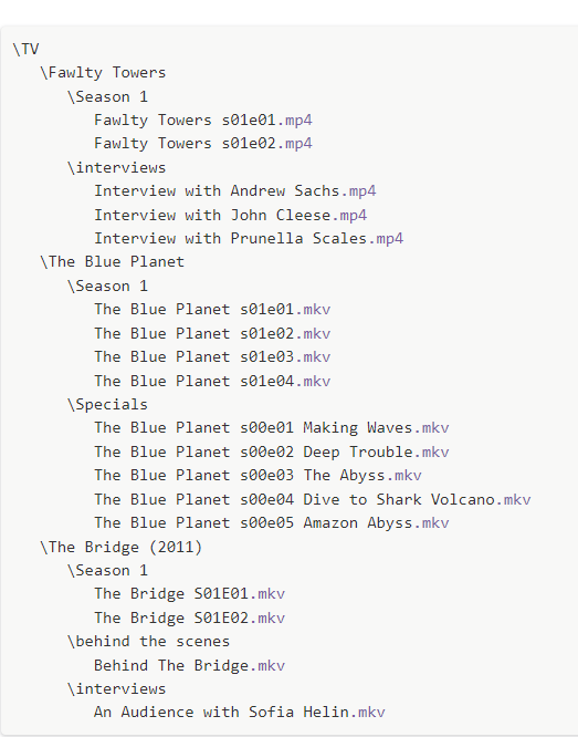

Happy2Play 9811 Posted July 30, 2024 Posted July 30, 2024 On 7/29/2024 at 7:02 AM, sa2000 said: On 7/29/2024 at 3:58 AM, ginjaninja said: Peep Show\Extras\... and Peep Show\Featurettes....seems to cause the NFO writer to appreciate these subfolders as Season 00 (that is reproducible). This may be by design. i.e. working as expected for extras and featurettes at the top level - But I would not expect it to affect the season level extras Exact same discussion in other topic as all the additional folders are just Alias for Season 0/Specials at Series or Season level and nfo written that way. So the only way to not get multi-version is episode level folders or the dash method added to file alongside episode. Better explanation of feature need or change in behavior at Season level. 1 1
ginjaninja 605 Posted July 30, 2024 Posted July 30, 2024 2 hours ago, Happy2Play said: Exact same discussion in other topic as all the additional folders are just Alias for Season 0/Specials at Series or Season level and nfo written that way. So the only way to not get multi-version is episode level folders or the dash method added to file alongside episode. Better explanation of feature need or change in behavior at Season level. Whilst the devs potential position being "you must conform to the naming scheme" (eg you must use dash method) is understandable and hard to argue with; theres something about extras being a bit of a wild west; the value in a dumping ground that just works is very attractive. So i make the case that it would be great if we could have a folder that files can just be dumped into, safe in the knowledge that they wont try to be identified but are still playable by their filename. And the dash method reserved for people that really want to curate their extras to the nth degree and have them associated to the episode in the ui.

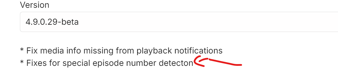

ginjaninja 605 Posted August 18, 2024 Posted August 18, 2024 On 12/08/2024 at 19:25, Luke said: We'll be adjusting this so that the episode numbers are not parsed from the file name. Thanks. nice one..thanks for considering .is this what this is about in the version history? i deleted all my nfos and rescanned/refreshed metadata. "I:\TV03\Peep Show\Season 00\S03E01 - Bonus Scenes.mkv" but still detected as S03E01. have i jumped the gun? or do i need to do something 'else' to prevent episode numbers being detected in my specials? use a specific sub folder name other than 'Season 00'?
Luke 42242 Posted August 20, 2024 Posted August 20, 2024 Hi, I would try adding a new file and see how things compare. Existing ones will probably need to be fixed up manually.
