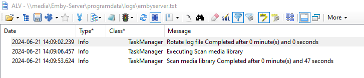

rbjtech 5335 Posted June 21, 2024 Posted June 21, 2024 11 minutes ago, Lessaj said: If using a hard drive for the OS yes that can certainly have an impact on the performance of the DB as other parts of the OS fight for disk access at the same time, though I don't believe that's the case here since based on what I looked at the majority of the time is against probing the media files, which from what I recall in other topics are held within a large number of hard drives connected via USB and using Drive Pool. While this setup may work, in my opinion this has many performance implications which I expressed my thoughts in another topic about. Agreed - and I mentioned this in my response also. Drivepool is not the problem, as I use it myself, but USB connected drives (even USB 3.x) are simply not designed for high I/O @ just over 30K items, my scan takes 47 seconds with zero new items to add. That's using Drivepool with local SATA disks and Emby/DB on NVME. A decent log viewer will read the emby logs, parse them and allow you to filter - I so wish emby would include one in the core product. Emby have one already in their own 'Emby Support Tools' so really not sure what is stopping them. This may help people find and attempt to resolve their own problems. 1
