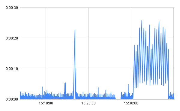

Lessaj 477 Posted June 20, 2024 Posted June 20, 2024 It's copying the existing BIF files into the cache directory as it scans. Overall the scan is chugging along nicely but sometimes ffprobe takes 15-25 seconds to get a result on a file, such as between 15:30 and 15:40. Your disks might have been a little busy during those periods. There were a couple outliers that I removed data points for to better view the graph. You'll just have to wait for it to finish, as long as there is activity in the log it should be progressing even if the % is not reflective.

Lessaj 477 Posted June 20, 2024 Posted June 20, 2024 The BIF files really didn't have anything to do with it, they were being copied into the server cache directory which yes does add a little time but overall the slowest part is ffprobe which seems to slow down at certain points. Just be patient and let it finish.

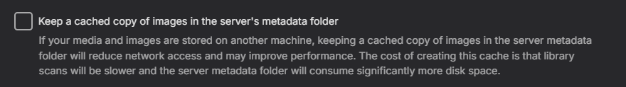

Happy2Play 9798 Posted June 21, 2024 Posted June 21, 2024 5 minutes ago, darkassassin07 said: Cache; is it being cleared for some reason? External cleanup of some sort, so emby has to repopulate its cache during scans? No a per library cache options for with media and server. So duplication. So initial process will be time consuming for every item. No different then a brand new install initial scan.

Happy2Play 9798 Posted June 21, 2024 Posted June 21, 2024 Well everything has been said you changed options and addition processes are added to library scan it will be slow until it completes. All the log really tells us is Emby is working hard to copy cache images/bifs for every items directly to their /metadata/library/xx/xxxxxxxxxxxxxxxxxx folders. So a SLOW time consuming process.

Happy2Play 9798 Posted June 21, 2024 Posted June 21, 2024 (edited) All I can say is what the original log shows. example 2024-06-20 15:40:11.702 Info App: Caching file from P:\Active TV\Criminal Minds\Season 01\Criminal Minds - s01e14 - Riding the Lightning-320-10.bif to C:\Users\jt\AppData\Roaming\Emby-Server\programdata\metadata\library\8d\8dc817a303c5386b5bb04057493e8db7\thumbnailcache\Criminal Minds - s01e14 - Riding the Lightning-320-10.bif 2024-06-20 15:40:11.805 Info ProviderManager: Caching file from P:\Active TV\Criminal Minds\Season 01\Criminal Minds - s01e14 - Riding the Lightning-thumb.jpg to C:\Users\jt\AppData\Roaming\Emby-Server\programdata\metadata\library\8d\8dc817a303c5386b5bb04057493e8db7\imagecache\Criminal Minds - s01e14 - Riding the Lightning-thumb.jpg Quote Keep a cached copy of images in the server's metadata folder If your media and images are stored on another machine, keeping a cached copy of images in the server metadata folder will reduce network access and may improve performance. The cost of creating this cache is that library scans will be slower and the server metadata folder will consume significantly more disk space. Until this process completes scan will be slower. As your posted log only got to C for TV Shows copying almost 4500 images/bif files from library to /metadata to that point. Edited June 21, 2024 by Happy2Play
Gilgamesh_48 1243 Posted June 21, 2024 Author Posted June 21, 2024 (edited) 20 minutes ago, Happy2Play said: Until this process completes scan will be slower. As your posted log only got to C for TV Shows copying almost 4500 images/bif files from library to /metadata to that point. But most if not all images were cached weeks ago and the server has been running with the cached images quite well. Are you saying those images have to be recached every time there is a scan? That seems quite counter productive. But I am quite tired of discussing this as it is clear that none of my questions actually get answered in such a way so I know what to do to fix anything so I guess I am quitting fighting about It is quite unproductive and time wasting to do so so i will leave this here and simply accept that nobody really understands Emby's scans. I find myself getting angry for no real reason except frustration. That is not good for my health and I am sure that others also are getting frustrated either for me or with me. I think I may try and find another, simpler media manager for video and pictures as that is all I use Emby for. I do NOT need fancy I just want simple and as easy as possible. I do not think there are any alternatives that would work for me but I feel that Emby has made their program much too complex so nobody, even the developers, know how it works any more. Edited June 21, 2024 by Gilgamesh_48
Luke 42184 Posted June 21, 2024 Posted June 21, 2024 Quote But most if not all images were cached weeks ago and the server has been running with the cached images quite well. Are you saying those images have to be recached every time there is a scan? No they don't, but you said you deleted the library and added it back, so many things are happening for the first time all over again. 1
