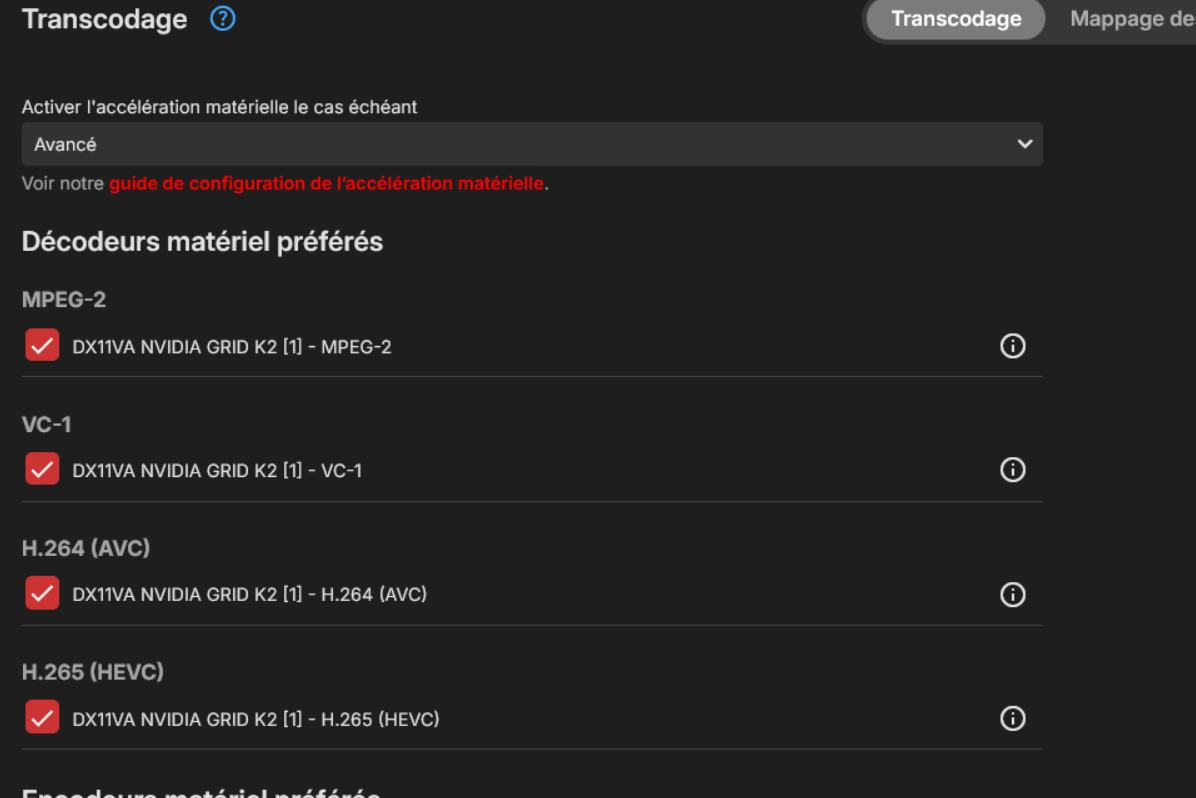

izard_endok 0 Posted June 19, 2024 Posted June 19, 2024 Hi everybody I recently purchase an NVIDIA Grid K2 par my server to make hardware acceleration for Emby but i've got a problem this is my configuration: ESXi 7 Emby was setup on a windows VM with graphic card in pass through I have setup nvidia driver on windows At the end i see my graphic car in emby when i go to trnascoding advance option but it still not use only the cpu work can anyone help me please

Luke 42184 Posted June 20, 2024 Posted June 20, 2024 @izard_endok Hi there, let's look at an example. Please attach the information requested in how to report a media playback issue. Thanks!
izard_endok 0 Posted June 25, 2024 Author Posted June 25, 2024 here you can found my log files embyserver.txt hardware_detection-63854940411.txt embyserver-63854940375.txt

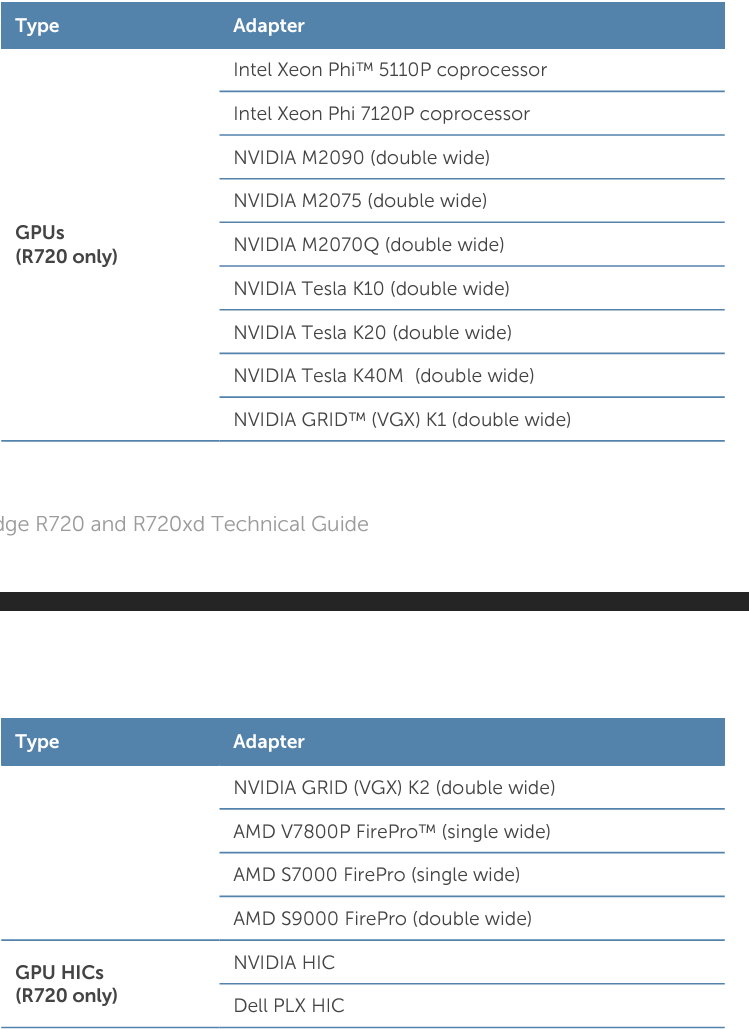

izard_endok 0 Posted June 26, 2024 Author Posted June 26, 2024 yes it's 2013 video card it's mounted on a dell R720xd i'm not sure a nvidia P400 is supported by a dell R720 So i have tout found another one if someone can help me to chose it, you're welcome thanks
izard_endok 0 Posted June 26, 2024 Author Posted June 26, 2024 what do you think about a NVIDIA Tesla P40?

RanmaCanada 500 Posted June 27, 2024 Posted June 27, 2024 Should just be a standard PCI Express slot. You are limited in the form factor. On /r/homelab on reddit there is a person who mounted an AMD HD6850 in theirs (OLD post..ancient), newer posts with a 1070, Personally I would replace that old hardware as it uses more power than it's worth. Apparently they limited the xd to "no graphics cards" because of airflow, but the R270 and R270xd are extremely similar and will both take graphics cards. P400 can be bought for cheap $40 USD. The P400 is limited to 8 concurrent encodes, but you can easily unlock that with the driver hacks. high profile or low profile
