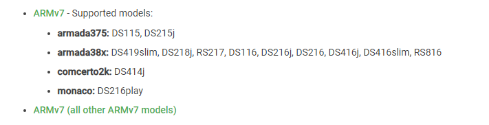

icegood 12 Posted June 19, 2024 Author Posted June 19, 2024 (edited) Please, find logs attached. Note, that my device DS414slim doesn't run code natively as stated here. Use case: just try to open video online More information about failed videos (from VLC): server_logs.zip Edited June 19, 2024 by icegood
Luke 42241 Posted June 20, 2024 Posted June 20, 2024 Hi, I see you installed the armv7 package but are you sure this is an armv7 NAS?
Happy2Play 9811 Posted June 20, 2024 Posted June 20, 2024 3 minutes ago, Luke said: Hi, I see you installed the armv7 package but are you sure this is an armv7 NAS? It is a Marvell Armada 370 88F6707 1.2 GHz CPU which suggests our Armv7_Legacy build. And the others guys chart. I can only assume it falls under the all others Legacy builds.
Luke 42241 Posted June 20, 2024 Posted June 20, 2024 Are you able to run the 4.7 version from Synology package center? Before attempting to use an older version you'll need to delete the server data folder to make a fresh start: /var/packages/EmbyServer/var
