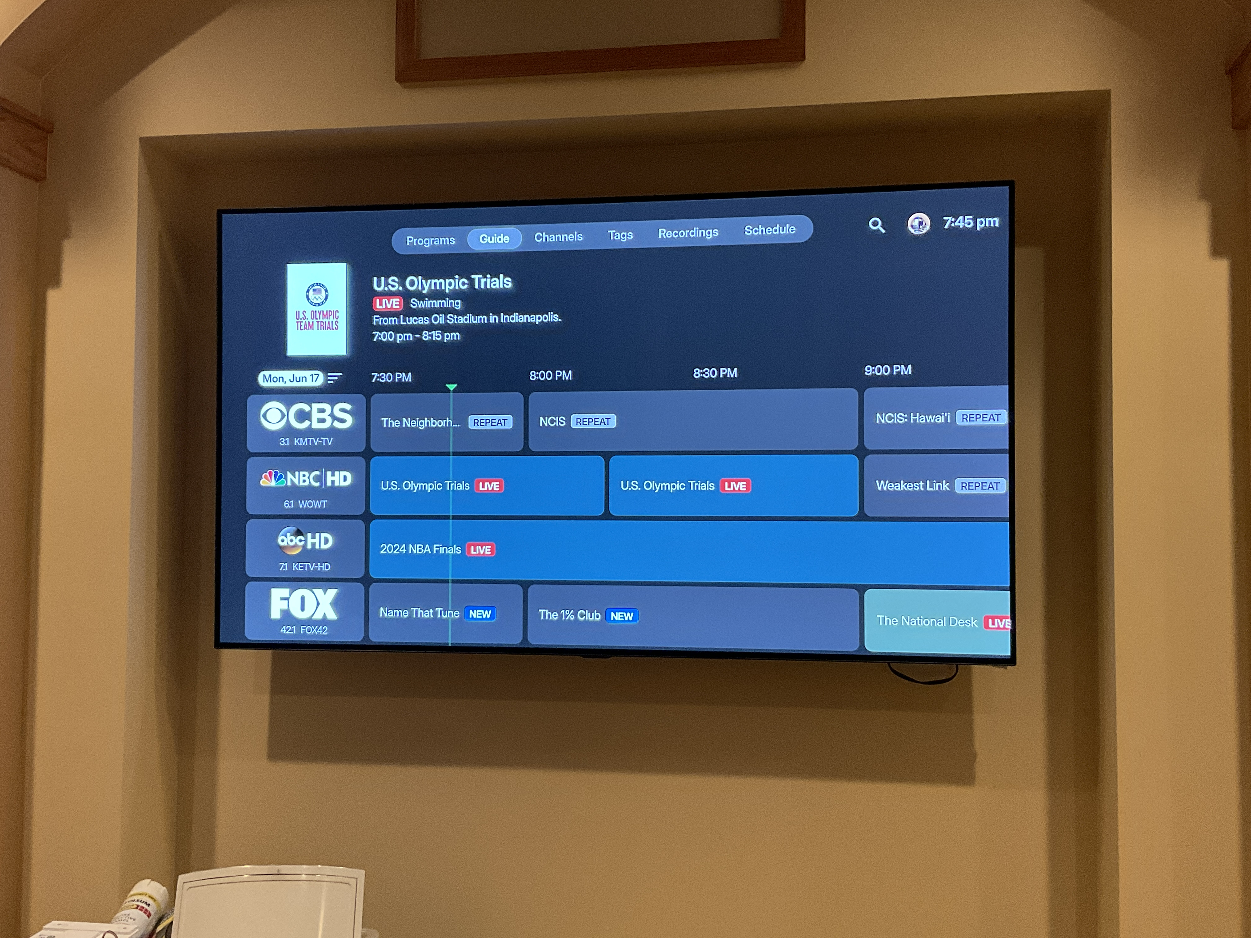

rendermandan 2 Posted June 18, 2024 Posted June 18, 2024 Is there any way to change how many channels appear on the screen at once in the guide? No matter what I do, it only shows four at a time. If I scroll down the highlighted channel goes of screen for two channels and then started to scroll. If that makes sense. Basically it’s like it should be showing 6, but it only shows four.

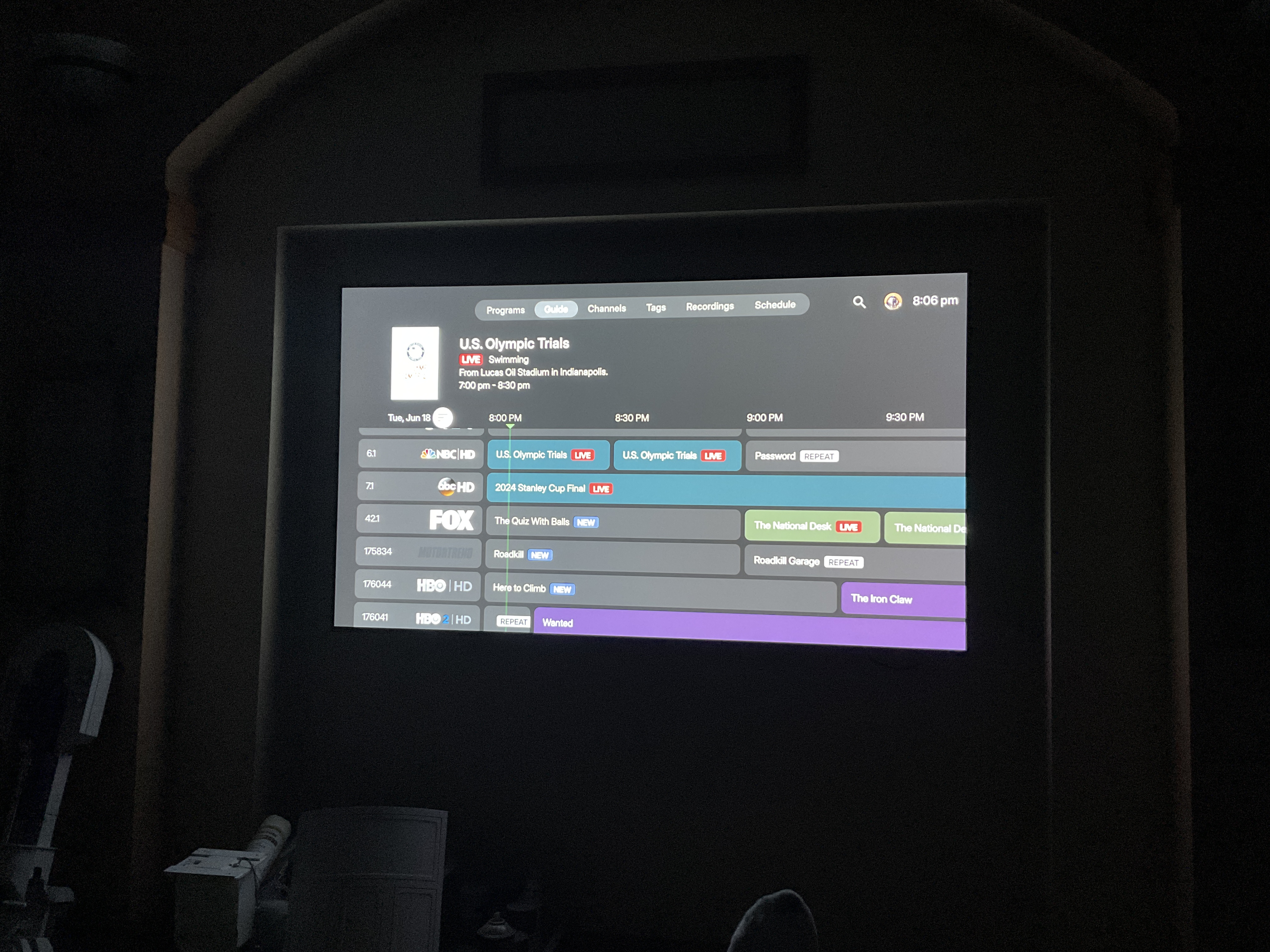

Solution Luke 42235 Posted June 18, 2024 Solution Posted June 18, 2024 Hi, I do agree that those rows are bit too large vertically. They can be trimmed a little bit, perhaps by about 10-15%, so we'll do that. That's not going to get you to six rows though. What you can do is click the sort icon and configure the display to not show both the channel image and name together. When you eliminate one, the layout will change and the rows will become much shorter.
rendermandan 2 Posted June 19, 2024 Author Posted June 19, 2024 Thanks. That is a little bit better. 1
