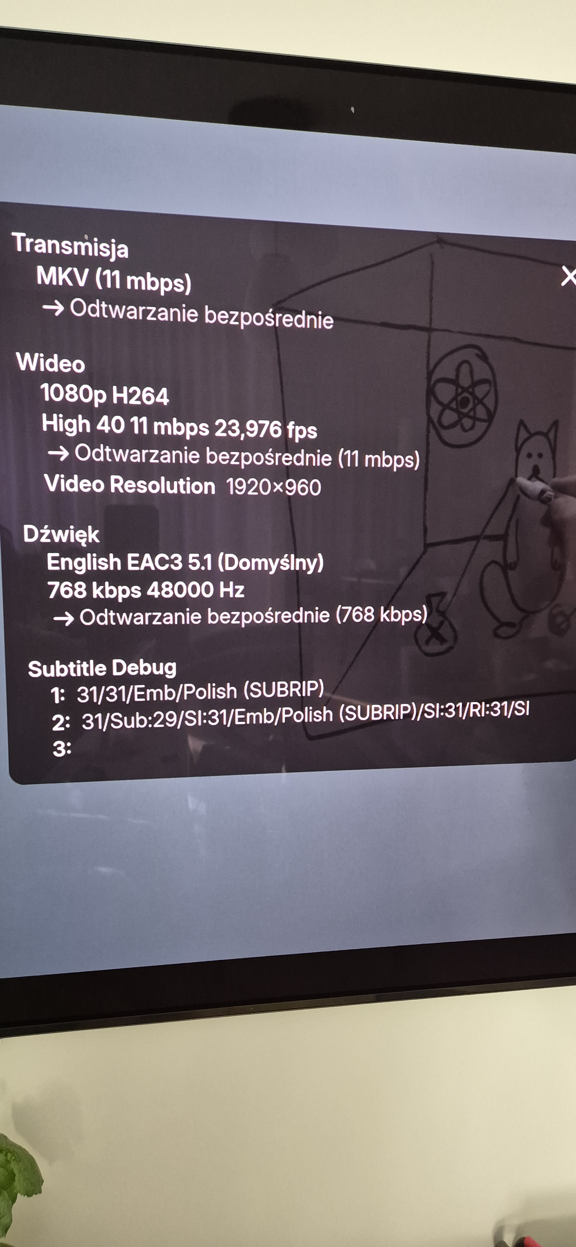

fiolet 5 Posted June 18, 2024 Author Posted June 18, 2024 Hi, it looks that this is "direct play". Here I see also info regards subtitles, but as you already know, it's not displayed 2
SamES 1084 Posted June 18, 2024 Posted June 18, 2024 Yes, it looks like DirectPlay. I assume you are using the USB Beta version, so you should have the latest code. The Beta version also has the subtitle debug, and it does look like it is selecting the 31 subtitle, but I need to recheck that it is showing me exactly the correct info. Can you please do the same screenshot whit the last subtitle that it does play (ie: number 30?) As it is DirectPlay, then I suspect that Samsung may have added a limit in the number of valid track selections

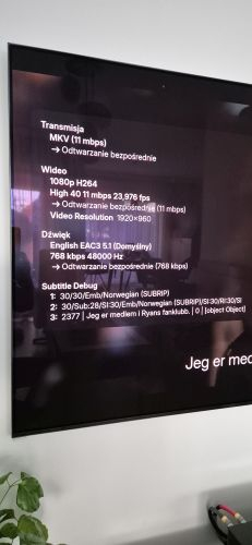

fiolet 5 Posted June 19, 2024 Author Posted June 19, 2024 Hi Guys, Please see attached with Norwegian language which is number 30th and works normally. I did some additional test, so to sum up. 1. I checked this video file with Xiaomi TV box and Kodi player. Works fine 2. I installed Plex server on synology and client on my Samsung TV. Subtitles works fine. (but of course I prefer to stick with Emby:) ) 3. I checked once again this file with emby server and client on my android samsung mobile. Works fine. So my conslusion after those test is: *mkv container is fine, emby server on synology is fine, samsung TV is fine (as Plex works). In my opinion there is some bug in Emby Tizen client. Regards Emby for Tizen. I have installed from Samsung shop version 1.7 as it is latest availalble and I had this problem. So I found that forum and installed newest version 1.8.3 hoping that bug is fixed. So both those version do not work with subtitle >30. So......what can we do? 1
