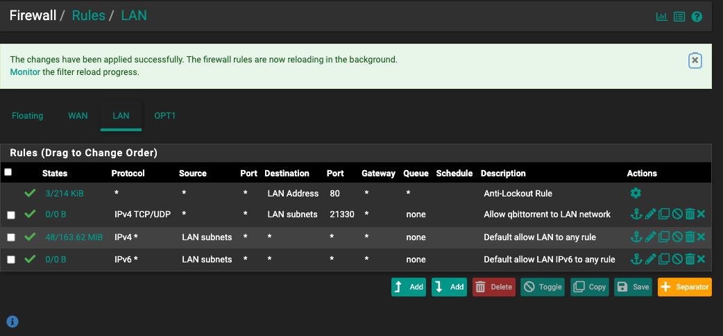

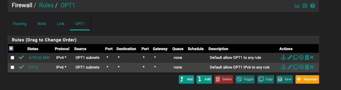

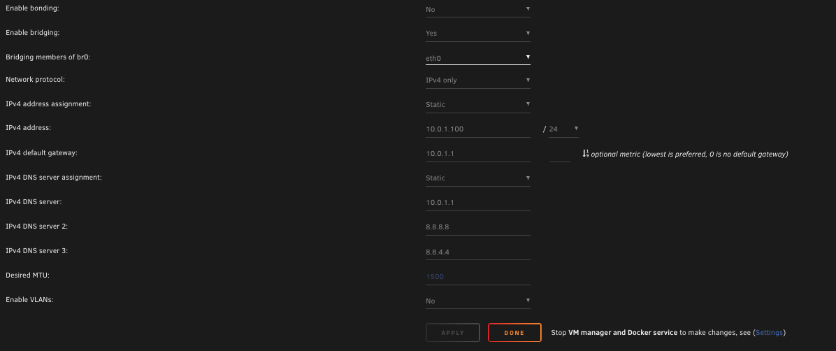

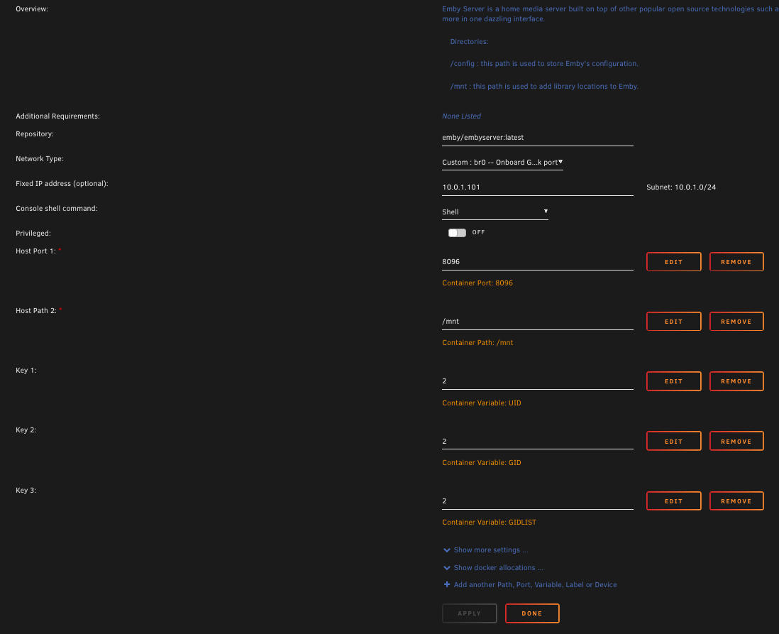

chard1988 0 Posted June 17, 2024 Author Posted June 17, 2024 No additional network settings. 10.0.1.1, 20.20.0.1 and 192.168.68.1 are all local networks. On unRaid, I left the default settings. Network for docker Emby is set to bridge and can be accessed via LAN. Here is the Emby docker settings: my pfSense rules: and lastly, unRaid network settings: Emby network is as follows:
