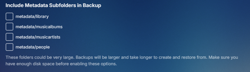

K1ng_Lear 240 Posted September 5, 2024 Posted September 5, 2024 32 minutes ago, Happy2Play said: Sounds like you did not copy/backup the Emby metadata folder. But probably need to see the server log as it should show errors of the path to what the db is looking for. Yup, I didn't copy anything. I only pressed the restore from backup button. Was this a fault?
Happy2Play 9811 Posted September 5, 2024 Posted September 5, 2024 3 minutes ago, K1ng_Lear said: Yup, I didn't copy anything. I only pressed the restore from backup button. Was this a fault? Depend on the options you enabled for backup but default no.
K1ng_Lear 240 Posted September 5, 2024 Posted September 5, 2024 (edited) 1 hour ago, Happy2Play said: Depend on the options you enabled for backup but default no. I tagged every one of this checkboxes before I made the backup. Edited September 5, 2024 by K1ng_Lear
Happy2Play 9811 Posted September 5, 2024 Posted September 5, 2024 1 hour ago, K1ng_Lear said: I tagged every one of this checkboxes before I made the backup. Then may need to see server log for the Restore and to see the errors you are getting via the broken image display.
