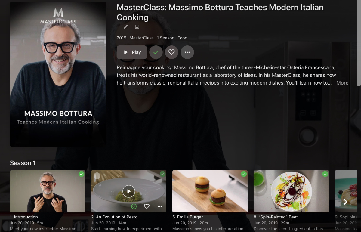

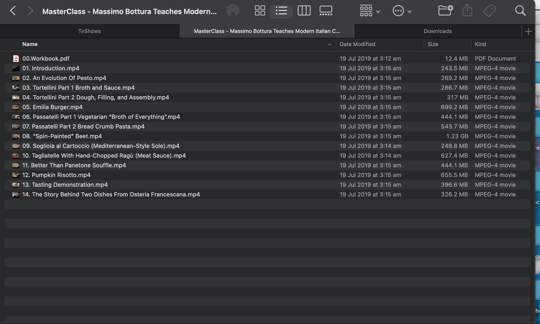

pattang_21 4 Posted June 15, 2024 Author Posted June 15, 2024 Thank you for your prompt response. I will hopefully get all the information in the following: Specific Example TV Show: MasterClass: Massimo Bottura Teaches Modern Italian Cooking Named and organisation: Shown in attached Screenshot. What I am expecting to see: All the episodes from 1-14 What I actuall see: Episodes 3,4 6 and 7 are missing. Screenshot provided. Hopefully the correct server log is attached. If not please let me know what I will need to do to provide the correct one. embyserver.txt

Solution GrimReaper 4895 Posted June 15, 2024 Solution Posted June 15, 2024 (edited) 30 minutes ago, pattang_21 said: What I actuall see: Episodes 3,4 6 and 7 are missing. Screenshot provided. 14 minutes ago, jaycedk said: MasterClass - Massimo Bottura Teaches Modern Italian Cooking (2019) - S01EXX - Episode name.mp4 It appears issue is with those episodes (3, 4, 6, 7) naming, as all 4 of them contain "part x" and no season identifier and/or Season 1 subfolder and likely breaking parser as File stacking (multi-part videos) naming convention used. You should rename those as @jaycedksuggested - as S01EXX - or any other supported naming convention of your preference except the one you're currently using or simply remove those Part 1 and Part 2 parts from the name as episode titles are irrelevant anyway. @Lukethough OP's naming convention used should be supported, it appears breaking on having "part x" in the filename in that scenario: Quote Episode naming conventions A number of naming conventions are supported: 02 Episode Name.ext Edited June 15, 2024 by GrimReaper 1
