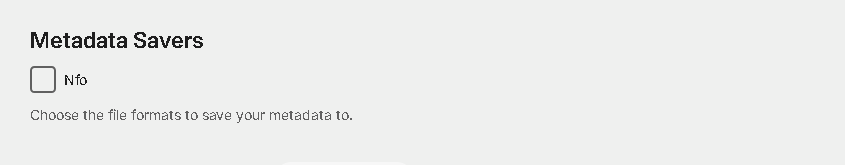

mickle026 653 Posted June 14, 2024 Posted June 14, 2024 Which Interface to enable a metadata saver here? I have tried the following but it doesnt appear in the selectable options. namespace LocalMetadataSaver.saver { public abstract class LocalMetadataSaver : IMetadataSaver { protected IFileSystem FileSystem { get; private set; } protected IServerConfigurationManager ConfigurationManager { get; private set; } protected ILibraryManager LibraryManager { get; private set; } protected IUserManager UserManager { get; private set; } protected IUserDataManager UserDataManager { get; private set; } public string Name =>"Local Info Saver"; public LocalMetadataSaver(IFileSystem fileSystem, IServerConfigurationManager configurationManager, ILibraryManager libraryManager, IUserManager userManager, IUserDataManager userDataManager) { FileSystem = fileSystem; ConfigurationManager = configurationManager; LibraryManager = libraryManager; UserManager = userManager; UserDataManager = userDataManager; } public bool IsEnabledFor(BaseItem item, ItemUpdateType updateType) { return item is Movie && updateType >= ItemUpdateType.MetadataEdit; } public Task Save(BaseItem item, LibraryOptions libraryOptions, CancellationToken cancellationToken) { } } } Can you give me a clue which is the correct interface for my own metadata saver? Thanks you

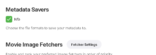

mickle026 653 Posted June 16, 2024 Author Posted June 16, 2024 I dont see anything different to my code, but it still will not show up as a metadata saver in library edit to be able to enable it. I changed the code, but still nothing is appears as a metadata saver! public bool IsEnabledFor(BaseItem item, ItemUpdateType updateType) { if (!item.IsFileProtocol) { return false; } if (item.GetType() == typeof(Movie)) { return item is Movie && updateType >= ItemUpdateType.MetadataDownload; } else if (item.GetType() == typeof(Video)) { return item is Video && updateType >= ItemUpdateType.MetadataDownload; } else if (item.GetType() == typeof(MusicVideo)) { return item is MusicVideo && updateType >= ItemUpdateType.MetadataDownload; } else { return false; } } I dont see any missing interrface components, but what is wrong?
mickle026 653 Posted June 16, 2024 Author Posted June 16, 2024 The basic interface, I am missing what it needs to enable it as a saver - I cannot see anything other than IsEnabledFor ? - other plugins have the public bool supports, but this doesnt seem to apply here.. public Task Save(BaseItem item, LibraryOptions libraryOptions, CancellationToken cancellationToken) { // do stuff } public bool IsEnabledFor(BaseItem item, ItemUpdateType updateType) { // eanable it for movies ?? return item is Movie && updateType >= ItemUpdateType.MetadataDownload; } public string Name { // display the name that shows in library edit return "PluginName"; } I am looking for the information/c# code to make it appear here:
