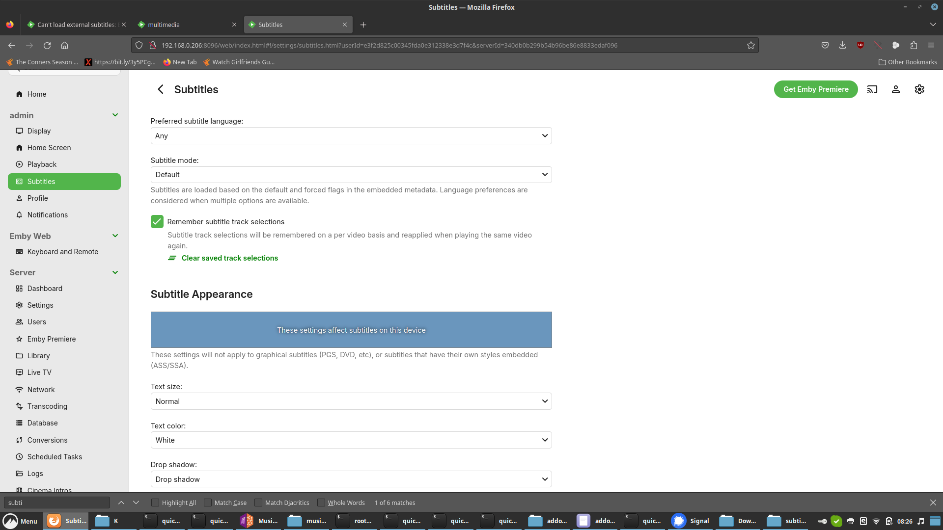

quickmic 1709 Posted June 14, 2024 Posted June 14, 2024 43 minutes ago, toomanynights said: Hi @quickmic, sure. Vexed - S01E01 - Episode 1 WEBDL-1080p.ru.srt 92.48 kB · 0 downloads I run a test with your subtitle. Works fine here, but I assume it also depends on your subtitle settings on Emby. I use default
quickmic 1709 Posted June 14, 2024 Posted June 14, 2024 I forgot to mention, plugin: -> I used latest 10.X (public testing version)
toomanynights 13 Posted June 14, 2024 Author Posted June 14, 2024 3 minutes ago, quickmic said: I run a test with your subtitle. Works fine here, but I assume it also depends on your subtitle settings on Emby. I have the exact same settings as yours. I don't think it's Emby though. Emby "sees" this sub and I can watch with it through Emby interface. Emby for Kodi though - doesn't. As for the plugin, mine is 9.4.21.
