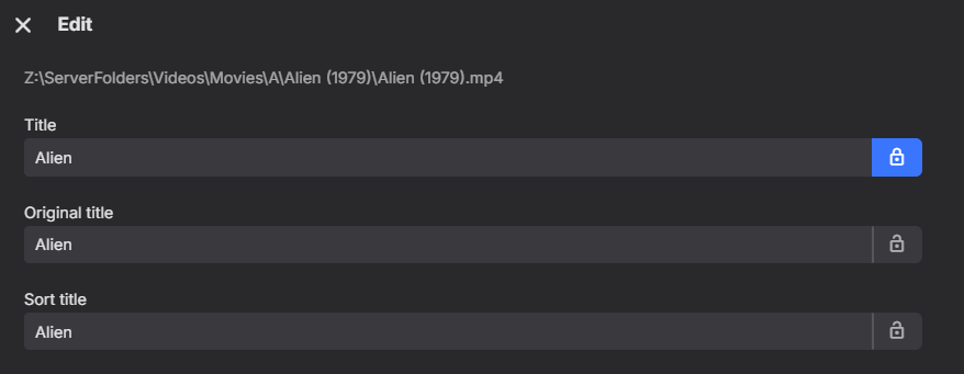

Shepard 2 Posted September 26, 2024 Author Posted September 26, 2024 Thanks for the fast reply! I first added the lockdata=true tag to my nfo, however, I got a bit confused by the mechanics. After adding the tag and running a library rescan, all metadata but the one defined in the nfo was gone, so I guess using lockdata leads to only considering the data from the nfo and does not fetch anything from remote. I checked what emby exports when fields are locked with the medatata manager from your example and added this to my nfo file: <lockedfields>Name|Tags|ProviderIds</lockedfields> Now fields title and tags are shown as locked, and the other metadata is fetched from tmdb. Also a rescan with "replace all metadata" nowkeeps the custom name. I don't see an option to lock the tmdb/imdb etc. IDs in the metadata manager, I got the fieldname ProviderIds from the DB schema and added it as well. Does it make sense to have this, or is this field not considered for the lockedfields?

Shepard 2 Posted September 28, 2024 Author Posted September 28, 2024 12 hours ago, Luke said: Has this answered your questions and helped resolve your issue? Yes. I have updated my nfo files with the lockedfields attribute and did a rescan of my library, everything looks good, also if I use the "Replace all metadata" option on an individual movie the custom names remain. I'll have another look after the 30 day automated library scan, but I'm confident adding lockedfields to the nfo resolves my issue. 1
