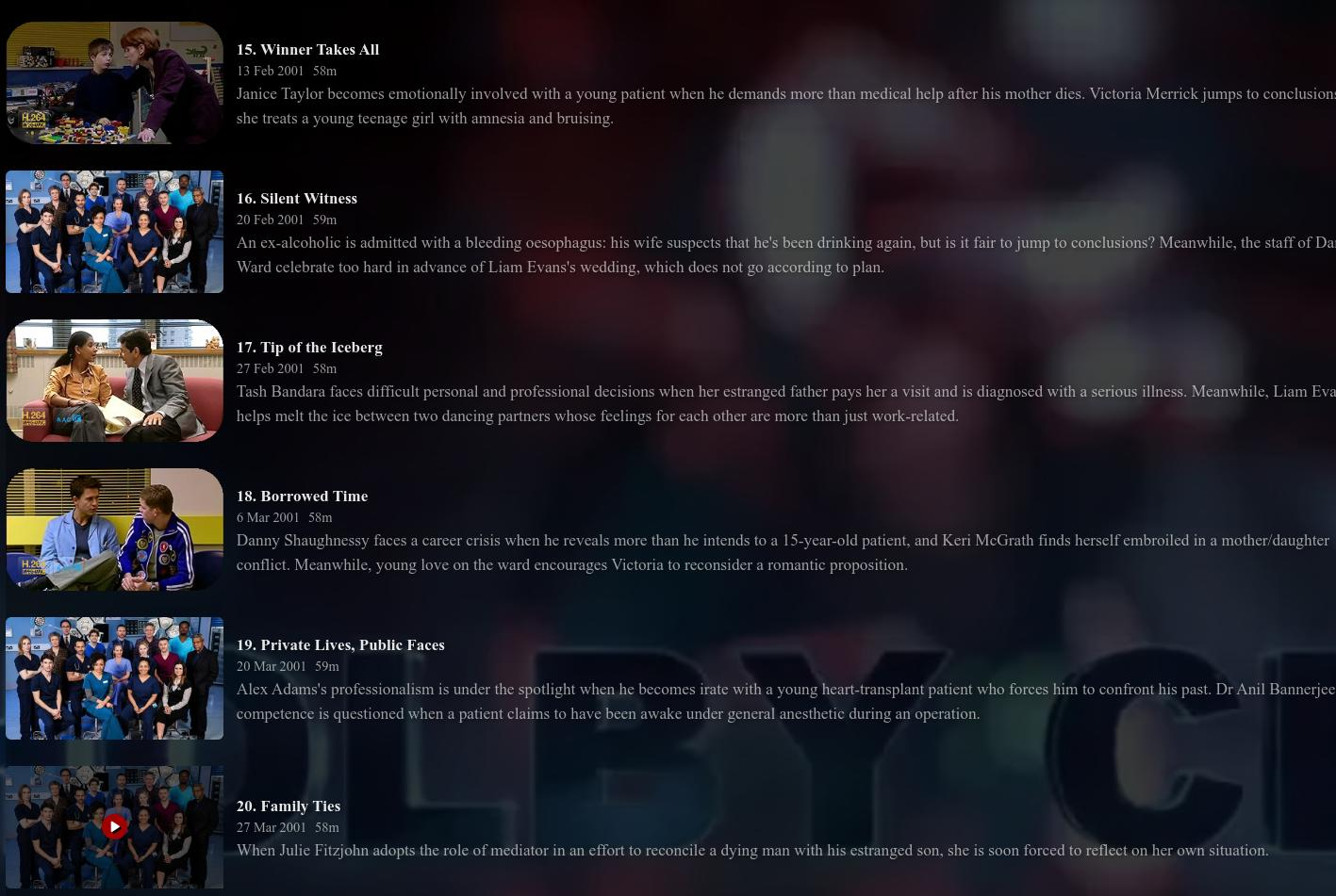

Normanos 13 Posted June 10, 2024 Posted June 10, 2024 Sorry about hijacking topic, but no point to start new one. @Luke Not sure if it's good to post here, but for some Tv shows still random extraction works. bif files created, but for some episodes it's not adding images. 24h past, but still nothing. Tried to "Identify" to reset images, but random images created. Looks, it's trying download only from internet. It's old show, so nothing is in internet. Added log file, but it's no point as files added. embyserver.txt

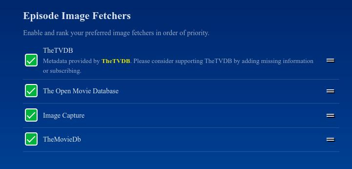

Happy2Play 9798 Posted June 11, 2024 Posted June 11, 2024 @Normanoswhat is your library episode image options? Note episode image has nothing to do with bif file.
Luke 42184 Posted June 12, 2024 Posted June 12, 2024 7 hours ago, Luke said: @NormanosHi, what example are we focusing on here? The reason I asked is because all of those episodes appear to have thumbnails, no?
Happy2Play 9798 Posted June 12, 2024 Posted June 12, 2024 16 minutes ago, Luke said: The reason I asked is because all of those episodes appear to have thumbnails, no? I will guess 16, 19, and 20 are inherited images.
Normanos 13 Posted June 12, 2024 Author Posted June 12, 2024 7 hours ago, Luke said: @NormanosHi, what example are we focusing on here? Sorry, as usual, struggling to explain... in image, episode 15, 17, 18 have extracted image. For others it's using default thumb image. yes, had to enable Image Capture
Happy2Play 9798 Posted June 12, 2024 Posted June 12, 2024 Only saw ffprobe for 16, 19, and 20 in the server log above, no extraction or errors. If you Refresh the episodes with Search for miss or Replace all w/replace existing image does it correct the issue?
