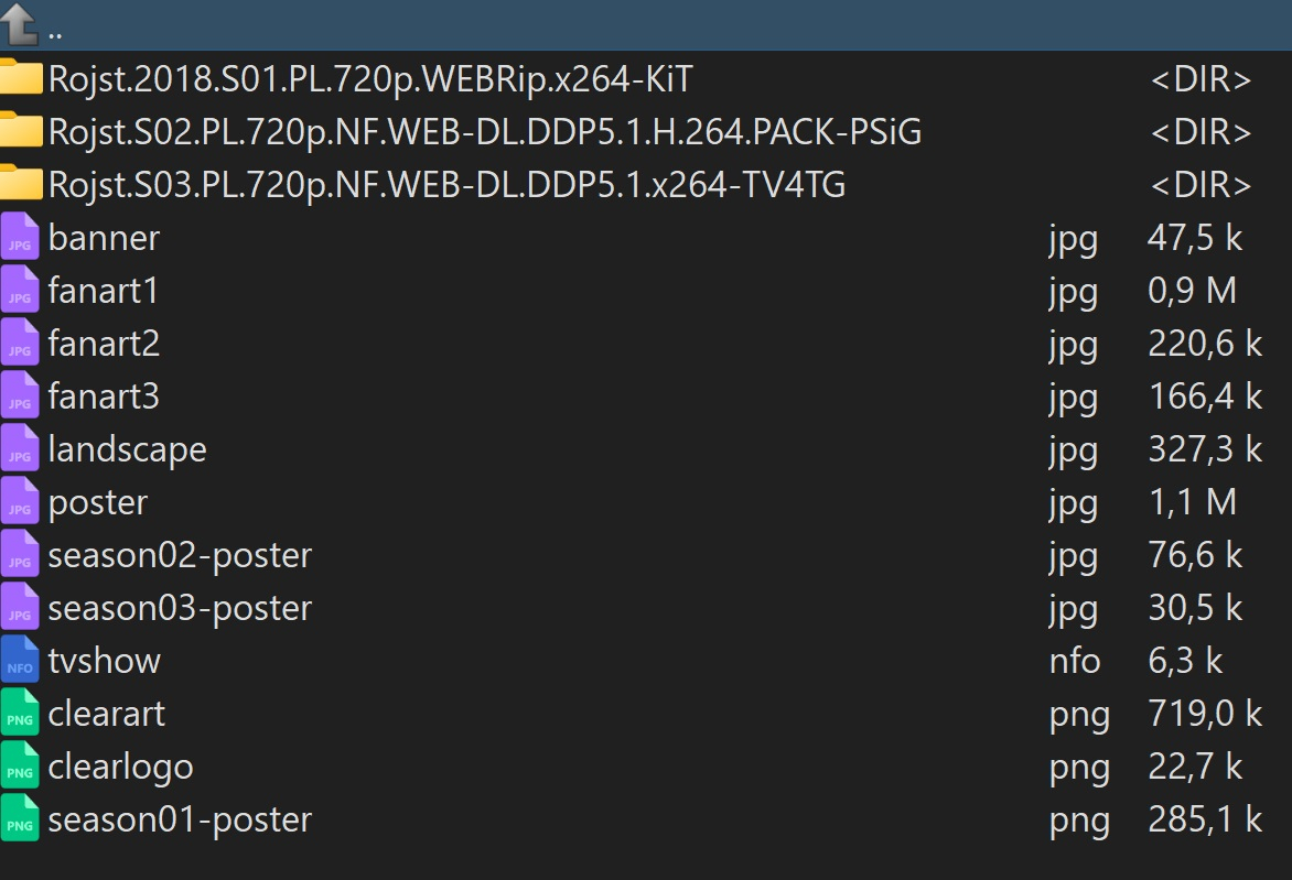

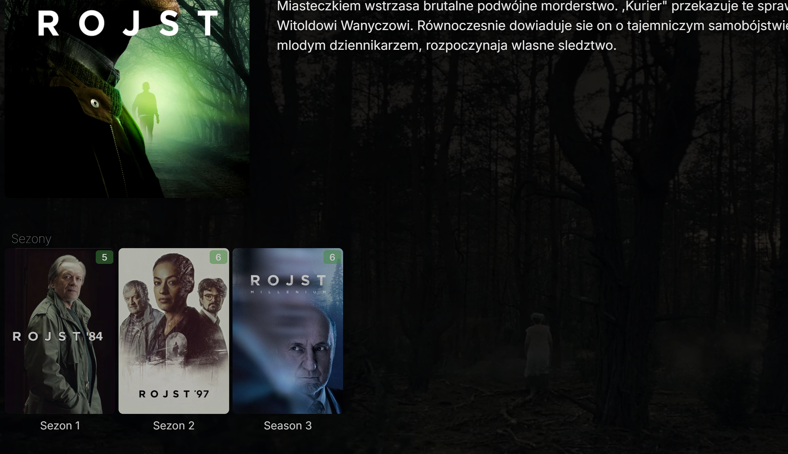

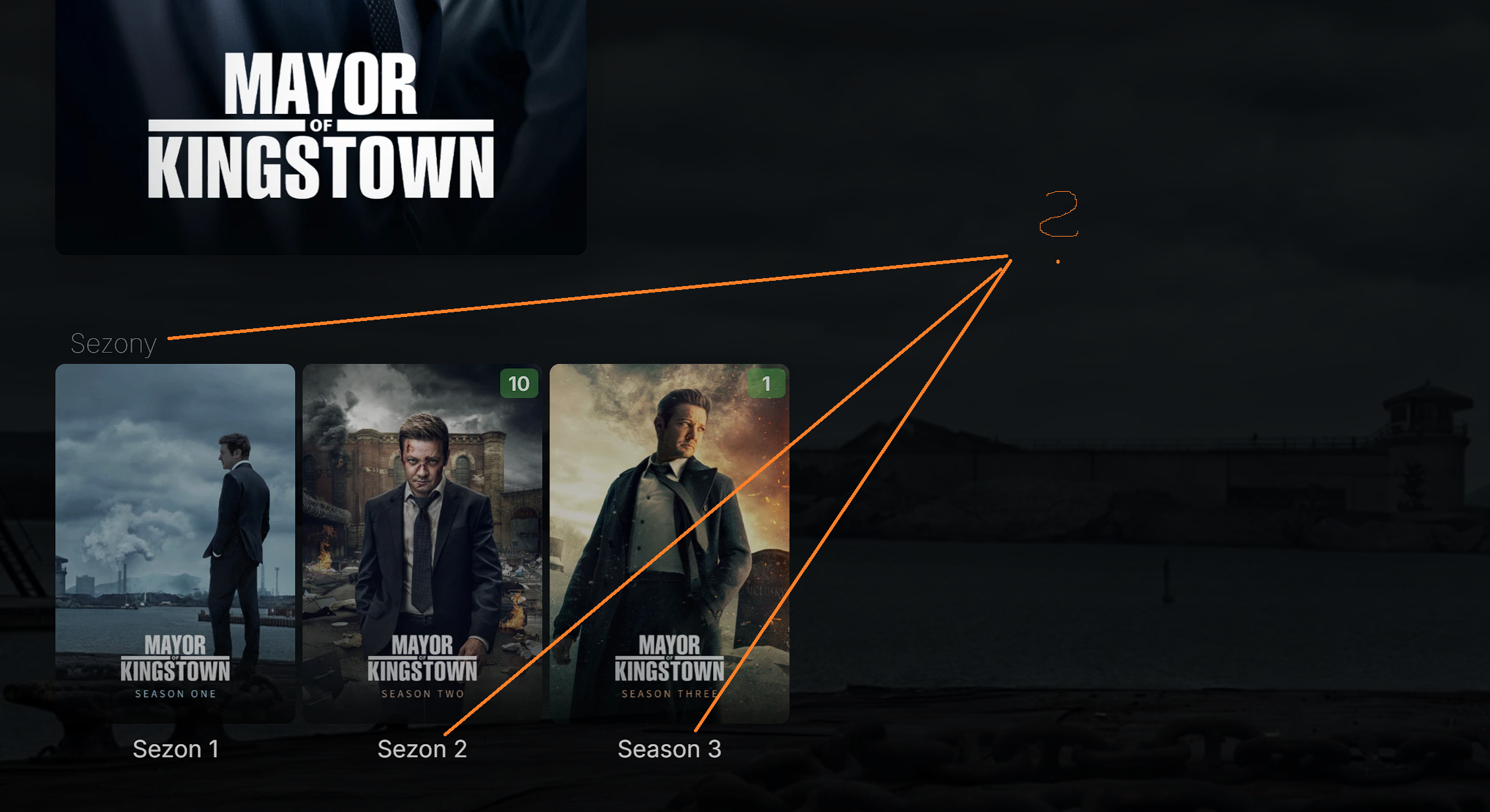

cochize1 55 Posted June 11, 2024 Posted June 11, 2024 So, I have just noticed but from what I see looking at the media I added the issue is quite old, name tags for the seasons are in 2 languages: - I have all my metadata set per library, tv show, movie and everywhere I saw that option set to English - I have Preferred display language in Dashboard --> Settings set to Polish (my native language) - I have some Polish tv shows that I change default metadata language per show and refresh that metadata after I add an episode to try pull the data in Polish language. But again, season tags are also in mixed languages. One small hint: I believe that the font is slightly different for both languages. Could that have happened when Emby changed the default font some time ago and that impacted one language but not the other? My question is of course why is that happening and secondly, how can I batch change to be consistent in one language or the other but not a mix of both (without refreshing all metadata for all tv shows)?

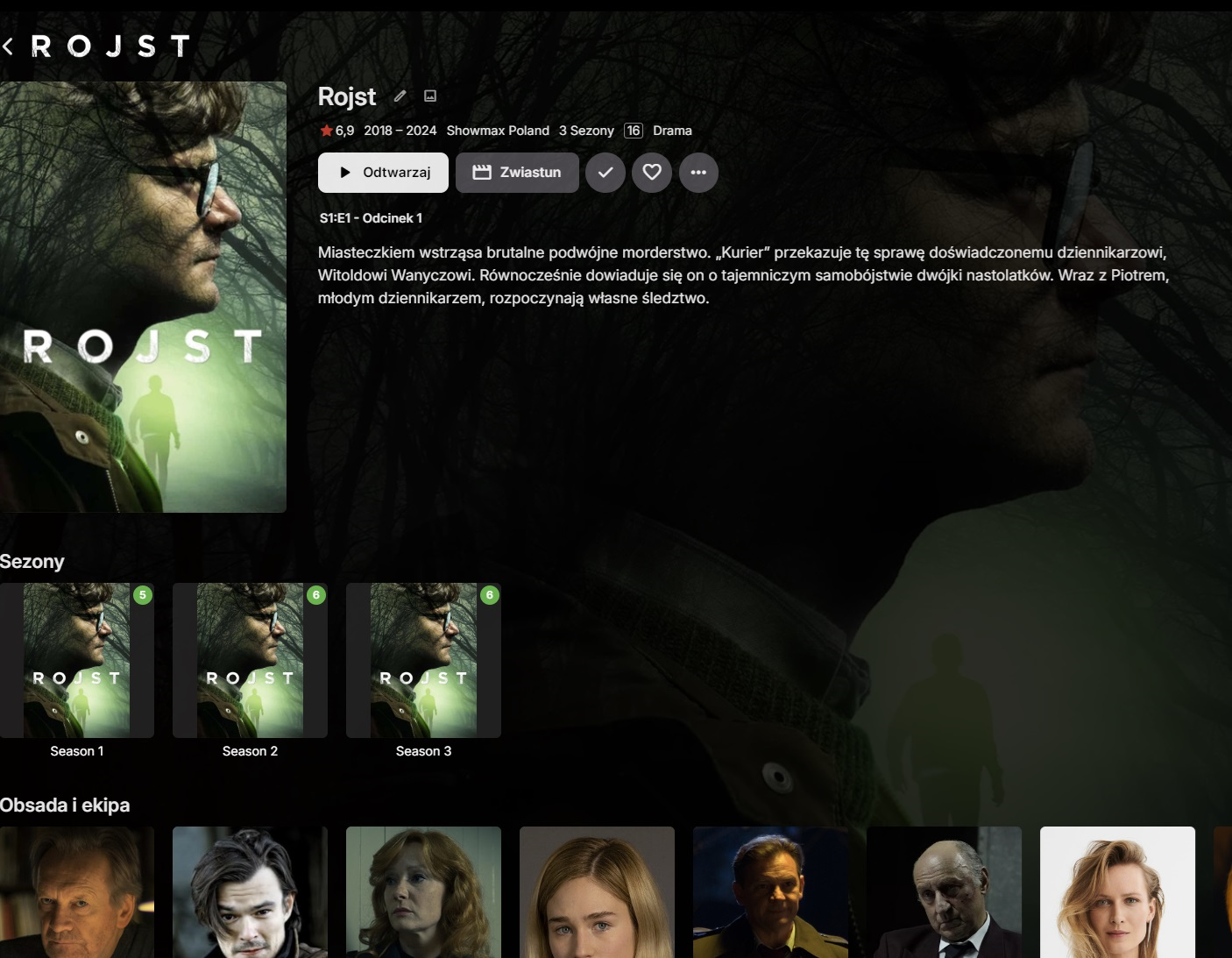

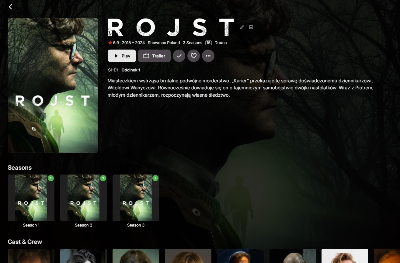

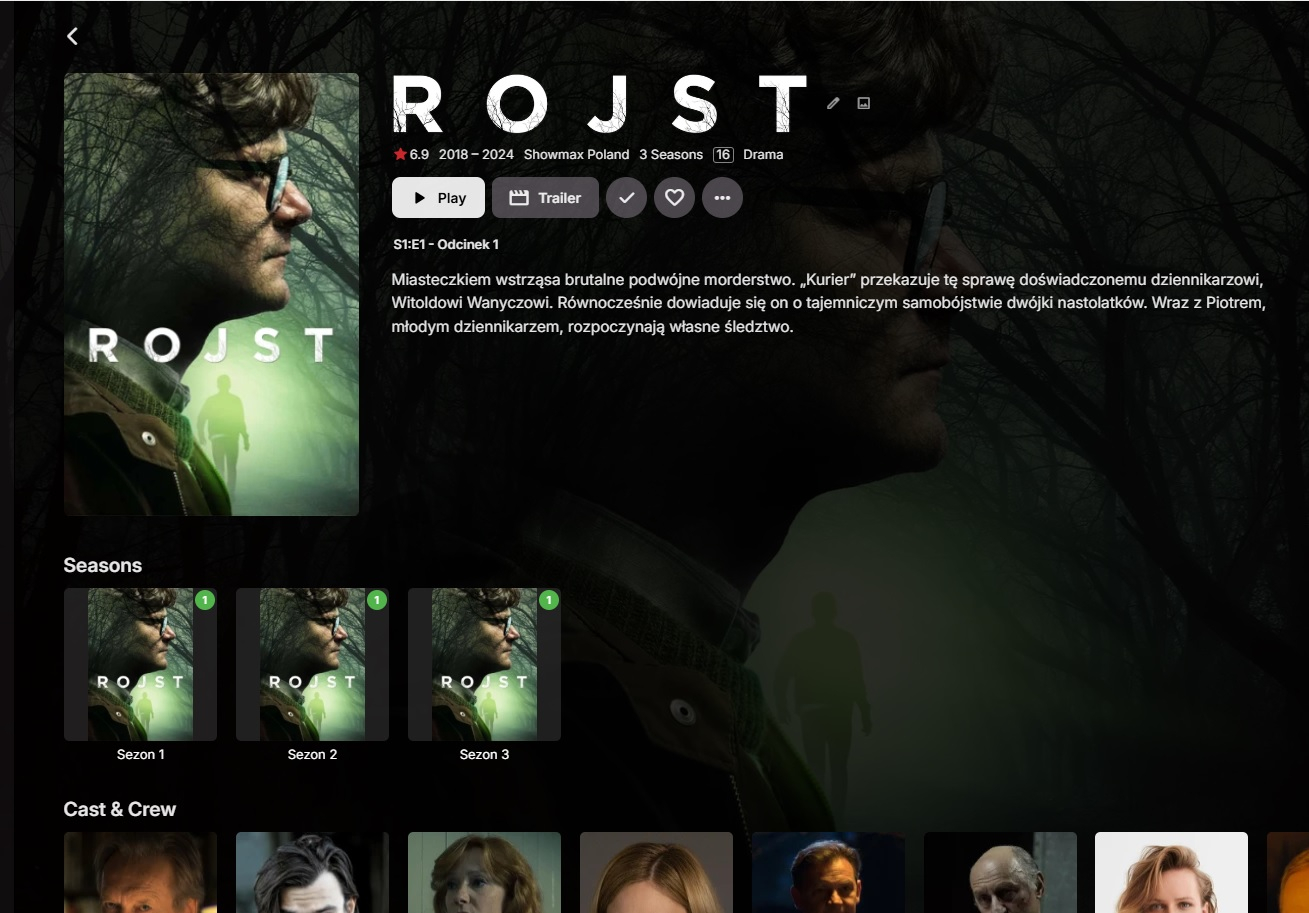

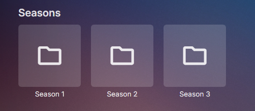

sa2000 703 Posted June 11, 2024 Posted June 11, 2024 1 hour ago, cochize1 said: I am not changing whole library metadata language. When the show is added, i go to Edit Metadata for that show, scroll all the way down, tick 2 boxes to set prefred language over there, save, than refresh and override metadata for that series. Library preferences stay the same all the time. Thanks for clarifying the steps I can see that Season titles are in English even when the metadata language is changed to Polish This screenshot follows this sequence: Setup library with English Metadata After adding the Rojst show, change the metadata to Polish by edit metadata for the show and then change display settings for the Emby Web app to be Polish My test was using beta 4.9.0.23. I will follow this up.

sa2000 703 Posted June 11, 2024 Posted June 11, 2024 Some more tests: I created a new library with default metadata being Polish and added Rojst show. The season titles were all in Polish I deleted the library and created a test library with default metadata being English and added the Rojst show. Then I edited metadata for the show and the season titles remained in English I will discuss this with the development team

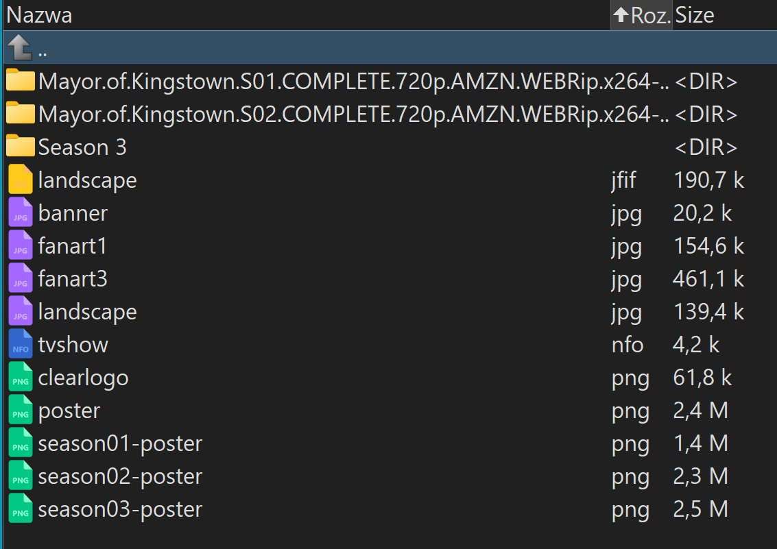

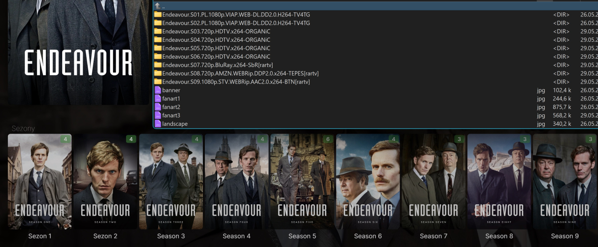

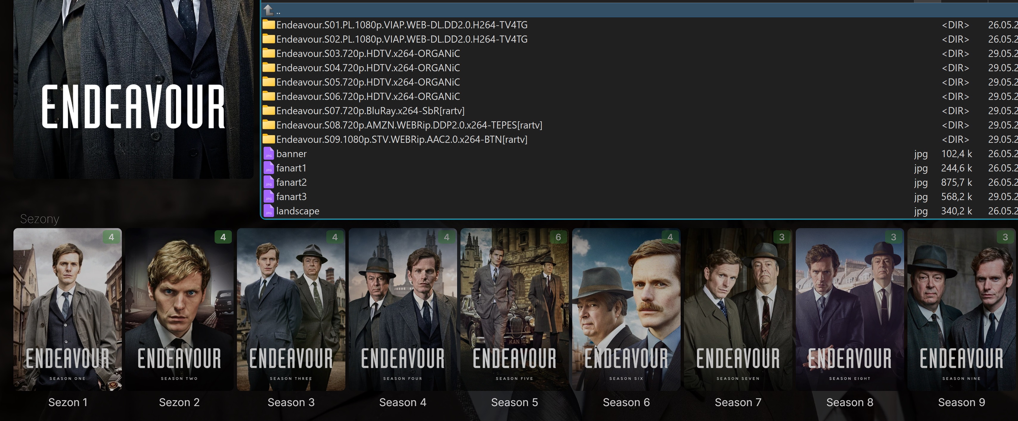

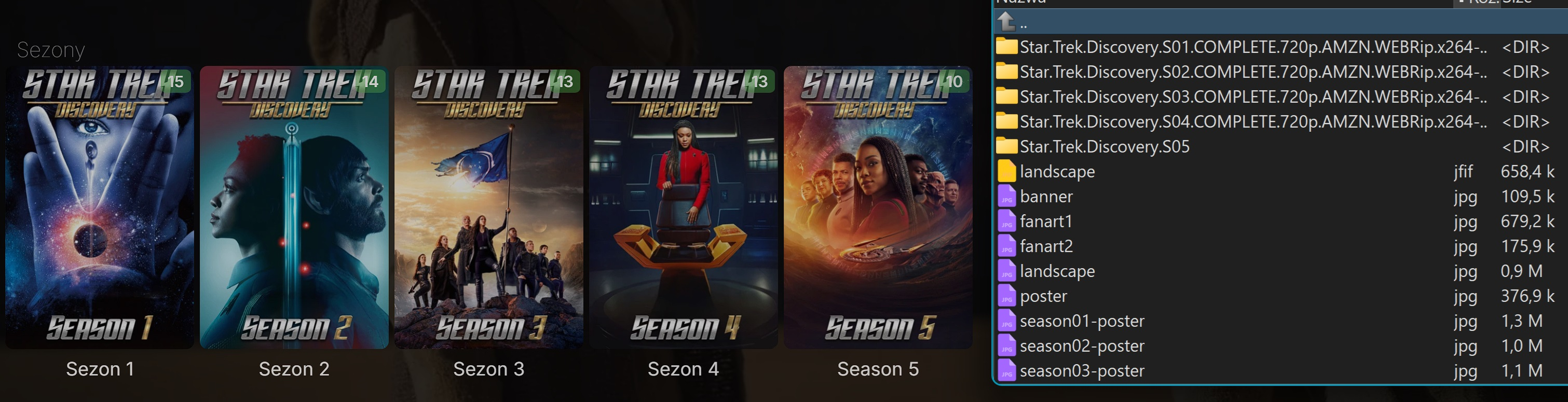

cochize1 55 Posted June 11, 2024 Author Posted June 11, 2024 When it comes to seasons I am not very consistent about it but they always include 'S01' or 'Season.01' somewhere along the lines (never in Polish language 'Sezon.01'. Below please find some examples where the problem occurs:

sa2000 703 Posted June 12, 2024 Posted June 12, 2024 (edited) Confirming what I found initially and what @Happy2Play has also confirmed. The Edit Metadata does not replace all metadata after switching language and refresh In my test, the media files/folders with just one episode per season for the test, were: \Rojst (2018) \Season 01 \Rojst (2018) - S01E01 - Episode 1.mp4 \Season 02 \Rojst (2018) - S02E01 - Episode 1.mp4 \Season 03 \Rojst (2018) - S03E01 - Episode 1.mp4 With Initial library setup with Preferred metadata download language set to Polish, Country to Poland and Preferred image download language Polish, season titles are correctly switched to Polish but if initially setup as English and then the TV Show Edit Metadata is used to switch to Polish and Poland and then refresh metadata is run to replace all metadata and images, the season titles remain as English. It ought to be the same behaviour and all metadata that was set initially in Polish for the Polish library should also be in Polish after Edit Metadata and switching TV Show language and refreshing metadata @Luke My tests for this were on beta 4.9.0.24 - Same was on 4.8.8.0 from my earlier tests Edited June 12, 2024 by sa2000
Happy2Play 9814 Posted June 12, 2024 Posted June 12, 2024 (edited) 4 minutes ago, Luke said: How are your session folders named? Naming structure is shown. But my test was the same. \Rojst (2018) \Season 01 \Rojst (2018) - S01E01 - Episode 1.mp4 \Season 02 \Rojst (2018) - S02E01 - Episode 1.mp4 \Season 03 \Rojst (2018) - S03E01 - Episode 1.mp4 As initial import is key here. So there is a slight difference from library setting getting info and Show level for language options. Easy to reproduce. Edited June 12, 2024 by Happy2Play
Happy2Play 9814 Posted June 12, 2024 Posted June 12, 2024 14 minutes ago, Luke said: How are your session folders named? Same example library set to German is correct on import Remove Identification defaults back to English and cannot be refreshed back to German. But with library not set so using system English or setting library to English and setting Show level to German will not change Season naming.
