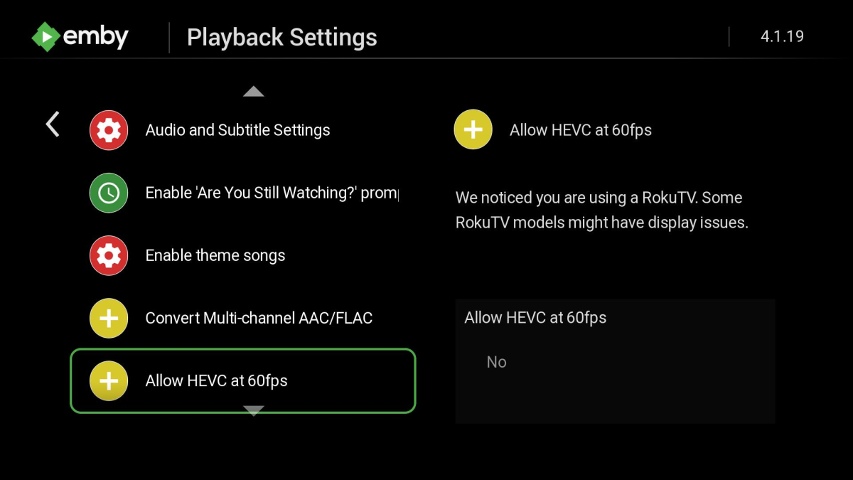

ebr 16332 Posted June 10, 2024 Posted June 10, 2024 Hi. Do you have this option in the app? If so, what happens if you toggle it?
barenada 1 Posted June 10, 2024 Author Posted June 10, 2024 Turning on "Allow HEVC at 60fps" did nothing as far as I could tell. I used to the app to turn on debug mode, and then played one of my 60fps videos. My username is dave, and I started playing the file "Saturday Thoughts.mp4" at 5:10 PM EDT on 2024/06/10. It said it sent you the log file. The video played for around 12 minutes, with the sound seeming to go at a normal pace, and the video falling more and more behind. After the audio playback was finished, the image just froze for several minutes until I hit the "back" button on my remote. The Roku is a Roku3 standalone box - not a Roku TV. It is connected to my LG TV via HDMI. My Emby server "neptune" has 96 CPUs and 516G of memory and is running CentOS Stream 9. All networking in my house is wired 1G with CAT6 cabling.
