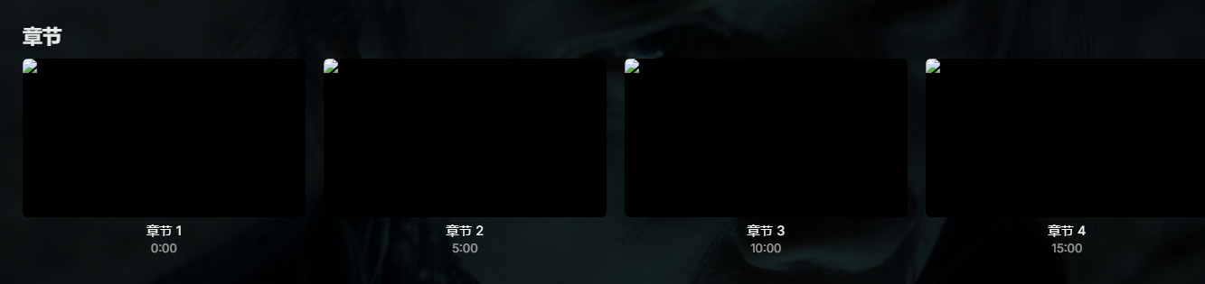

thsrite 7 Posted July 10, 2024 Posted July 10, 2024 (edited) On 6/9/2024 at 9:16 AM, Happy2Play said: Think your only option is wildcard searching the /metadata/library folder for *.bif files and manually moving them or deleting them and rerunning the task. hi,I don't want the thumbnail anymore, how can I delete these records? I looked at the records stored in Chapters3 in the library. db. Can I directly clear the Chapters3 table? *.bif files already manually delete Edited July 10, 2024 by thsrite
Happy2Play 9798 Posted July 10, 2024 Posted July 10, 2024 7 minutes ago, thsrite said: hi,I don't want the thumbnail anymore, how can I delete these records? I looked at the records stored in Chapters3 in the library. db. Can I directly clear the Chapters3 table? *.bif files already manually delete Yes that should clear the UI from showing them altogether.
thsrite 7 Posted July 10, 2024 Posted July 10, 2024 (edited) 5 minutes ago, Happy2Play said: Yes that should clear the UI from showing them altogether. I downloaded library. db from NAS to the local system, and after modifying it, I found that it would generate a .db-wal and .db.shm file. Do I also need to replace these two files, or do I just need to replace library. db Edited July 10, 2024 by thsrite
thsrite 7 Posted July 10, 2024 Posted July 10, 2024 13 minutes ago, Happy2Play said: Yes that should clear the UI from showing them altogether. thanks I have completed it
