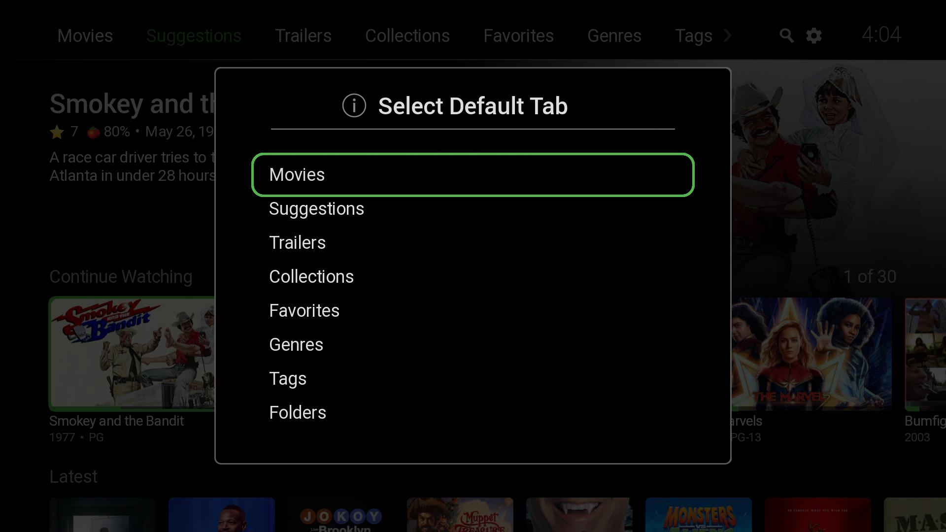

Gilgamesh_48 1243 Posted June 5, 2024 Posted June 5, 2024 (edited) Roku - 4.1.22 I just noticed that on my Roku all my libraries are starting in "Suggestions" even though I have set the default to "Movies" or "Shows" Except for Photos where it defaults to "Folders" I have reset each library to what I had before (Shows, Movies, Photos) but they reset as soon as i leave the library involved. I have restarted the Emby app, several times and I have restarted my Roku itself twice and I have restarted my server (Version 4.9.0.23 beta) twice. To put it simply the default tab is always reset to whatever is the default as soon as 4.8.0.23 was installed this AM but the web app still handles the tabs correctly. This is a matter of a couple of button presses each time I enter one of the libraries on my Roku. But it is a couple of button presses that I have not needed in the past. Please fix!!! Edit to add: I just tested and my Fire stick and my Shield TV both work correctly so this is a Roku bug. Edited June 6, 2024 by Gilgamesh_48 1

Gilgamesh_48 1243 Posted June 6, 2024 Author Posted June 6, 2024 12 hours ago, Luke said: HI, we'll take a look at this. Thanks for reporting. A little addition to the report. Before this bug reared up I would exit a library after setting things like choosing "favorites" or sort order or anything else selected from the menu on the far right of the screen and when I reentered that library the choices would be retained but now, with the bug, the choices are lost upon exit. I really think the failure is upon reentry not on the exit. It is like the settings are saved just fine but are never read upon entry. I hope that was somewhat clear, 1

speechles 2062 Posted June 6, 2024 Posted June 6, 2024 (edited) @Gilgamesh_48See the same issue on Version 4.9.0.23 beta. No matter what I set the default it doesn't stick. It will always land on suggestions when entering this library. We will get this fixed. Thanks for reporting. You rock! Reference: Issue #1617: [TabView] Select Default tab is not remembering and winds up defaulting to the default Edited June 6, 2024 by speechles
Gilgamesh_48 1243 Posted June 6, 2024 Author Posted June 6, 2024 (edited) 7 minutes ago, speechles said: @Gilgamesh_48See the same issue on Version 4.9.0.23 beta. No matter what I set the default it doesn't stick. It will always land on suggestions when entering this library. We will get this fixed. Thanks for reporting. You rock! Reference: Issue #1617: [TabView] Select Default tab is not remembering and winds up defaulting to the default But, for me, the selection of a default library does work fine in the web app and on all my clients EXCEPT my Rokus. It is ONLY the Rokus that show any problem. How can this possibly be the server's fault???? I simply do not understand at all. BTW: The link in your post ( Version 4.9.0.23 beta.) does not work to take me to anything except an error page. Edited June 6, 2024 by Gilgamesh_48
speechles 2062 Posted June 7, 2024 Posted June 7, 2024 @Gilgamesh_48I can reproduce this inside the Roku app. Same issue. Should be able to trace back what the issue is and fix whatever is causing it. We will get this fixed. The link in my post is an internal link generated by the dashboard when it shows the version.

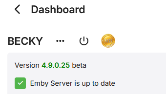

Happy2Play 9811 Posted June 15, 2024 Posted June 15, 2024 (edited) Well fixes went in that build but what they entail only devs can say or requirements users need to do. 4.9.0.25-beta Fix regression causing some Roku and android tv settings to not be saved Edited June 15, 2024 by Happy2Play

speechles 2062 Posted June 16, 2024 Posted June 16, 2024 (edited) @Gilgamesh_48 Emby Server Updated to 4.9.0.25 on BECKY 6/15/2024, 3:17:08 PM That would be roughly 2 and a half hours ago it auto-updated. 1 hour ago, Gilgamesh_48 said: @ebr, @speechles, @LukeDo any of you actually test for fixes using Roku? It sure does not look like it! It isn't a Roku issue, per se until it is. The Emby server abruptly changed some things without realize that some legacy apps on the Roku and Android TV were still using those. These things happen. Then later you find out the thing we need to do most of the custom settings disappeared overnight and no changes were done to the apps. The change was made on the server. It is expected that this move at a break-neck speed. You have to keep up with trends, and all the other stuff that attracts new users. Having the user base increase with new users requires it moves at damn near the speed of light. This is a "Move Fast, Break Things" momentum where you have to keep up with relevance. Lose speed and you start to become irrelevant. Apologies that this is happening to you and most of all that it is happening on the Roku. But these server changes are something we can only test after the Beta comes out. Just like it appears you tested and discovered it broken. Yep, I just did the same thing. Realized that it still has the same issues. I am sure Luke is very aware he is just a very busy person. A human with many many hats. One who occasionally makes mistakes. Just like all humans do. We just have to let him know that this did not fix the issue in the Beta. I tried to store both a tab preference, a custom grid with image size, image type, and sort. All of these restart at the default as if I never set anything. That is the real. No joke. No lies. We aren't here to play with your head. This is just something we need resolved. It is an issue. 1 hour ago, Gilgamesh_48 said: It "might" be supposed to be fixed but it is NOT. It really really seems that the developers are too lazy to fix a problem they are well aware of. I hate being lied to but that seems to be the chosen way to make people reporting BUGS go away. I cannot use any other media handling program but I am really getting to the point where the only thing I can trust Emby to do is lie to me. I have, obviously, restarted my server and i have exited and reentered Emby on my Roku but the bug persists. I can live with this as I am not using a release server for my main Emby usage but, eventually, if no one bothers to fix this bug. it will creep into the release as Emby seems to have no aversion to releasing buggy software and the lying to say it is working. I am becoming convinced that Emby does not care and will say anything to get users reporting BUGS to go away. It isn't that we do not care. That this isn't a bug enough issue to do something about and we can delay fixing it. This Issue specifically needs a server update. But we are all human beings. It is nice to be told that the software isn't working as intended. It is also nice to have people contribute feedback. Both of which are highly desirable and come with a cost. That cost is you are allowed to say whatever you want to us and we cannot really have that kind of back and forth on a public forum. I get it that you are highly upset. I am too. I use the Roku on a daily basis and it is broken for me too since I only run Beta server. But I understand how these things happen. I also understand there is an enormous work load and sometimes some things get overlooked. I can understand since I can kind of see where that can happen. It happens to all of us. We will get this fixed ASAP. Apologies again this happened. Edited June 16, 2024 by speechles
