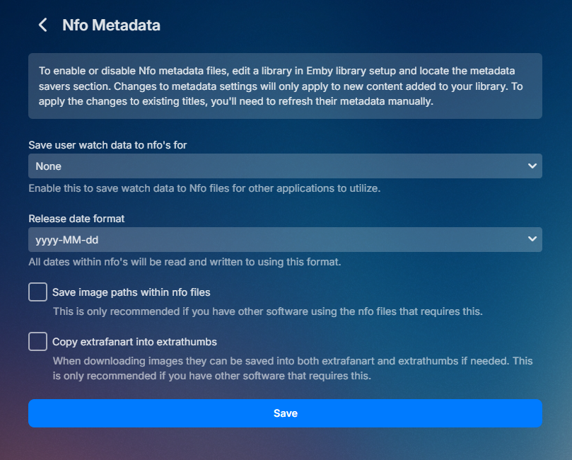

Embodiment 30 Posted May 25, 2025 Posted May 25, 2025 As a follow-up to the test I did based on our above conversation. I marked the movie " 20 Million Miles to Earth" as watched. No immediate change in .nfo file (as expected). Did a metadata refresh just on that movie. Instant update to .nfo file. But while it must have made some change, IT did not change the watched status. Still set to ''false' and no reference anywhere to the movie being watched. So Emby does not change the watched state in .nfo files upon a refresh metadata. Nor does it read the watched state as we already know. Ironically, with Kodi Omega, this is now built into the application. https://github.com/xbmc/xbmc/pull/20842
Happy2Play 9798 Posted May 25, 2025 Posted May 25, 2025 3 minutes ago, Embodiment said: But while it must have made some change, IT did not change the watched status. Still set to ''false' and no reference anywhere to the movie being watched. So Emby does not change the watched state in .nfo files upon a refresh metadata. Nor does it read the watched state as we already know. Did you configure the NFO plugin (click on the plugin) to write that user watched status? As Emby being a multi user platform it sort of becomes useless at least to Emby.
Luke 42176 Posted May 26, 2025 Posted May 26, 2025 Yes you need to do that to get Emby to save the data to nfo files. But it will only do that for one user, and Emby is a multi-user system. We added support for that so that you could have Kodi import the data, but it is not really suitable for Emby's uses.
Embodiment 30 Posted May 26, 2025 Posted May 26, 2025 That was the trick! Didn't know that plugin had that ability. I am just now looking at profiles for Emby; but my wife watches little and I have just set tags for things I think she would be interested in so we have just one profile on Kodi. See only sees tagged items from the customized home screen on Kodi on her TV. Thank you for helping me see this trick. It worked, changed the nfo file and Tiny Media Manager recognized the status change. 1
