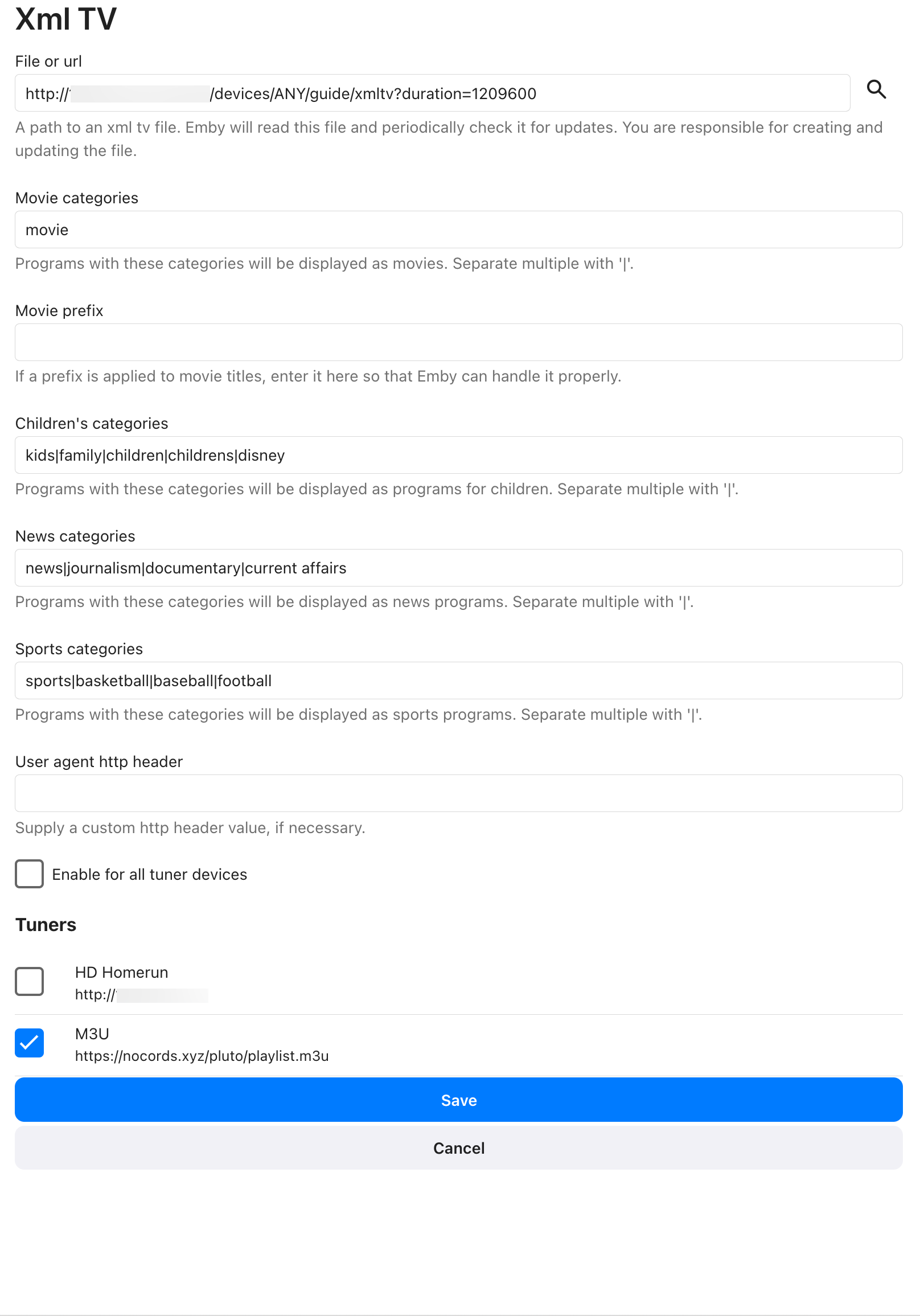

daldana 126 Posted January 29, 2025 Posted January 29, 2025 So you've already setup an M3U tuner for Pluto in Emby? You can try setting up an XmlTV Guide Data Source with this url; http://xxx.xxx.xxx.xxx:8089/devices/ANY/guide/xmltv?duration=1209600. Use the ip address from your Macbook and make sure your M3U tuner for PlutoTV is the only one selected. 1
EkoOne 5 Posted January 29, 2025 Posted January 29, 2025 @daldanaIt worked, thank you so much! What's interesting is when I access the Pluto TV website on my laptop live tv rarely loads regardless of the browser, even with ad blockers disabled. It's a flaky mess but it works fine on mobile for some reason. I was concerned I might have the same problem accessing Pluto live tv via Emby but it works great. Go figure. I have no idea why but at least I can watch Pluto on my laptop once more. Thanks again.

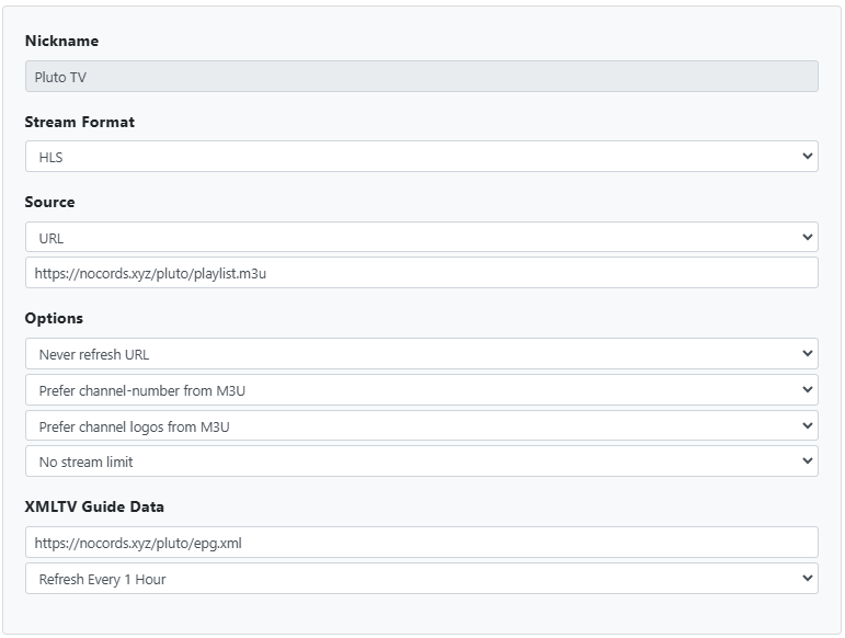

daldana 126 Posted January 30, 2025 Posted January 30, 2025 @EkoOne Here is my Channels source. I haven't had that issue come up.
EkoOne 5 Posted January 30, 2025 Posted January 30, 2025 @daldanaMy Channels (Pluto) settings didn't exactly mirror yours so I updated them to match. As for Emby (Pluto) Live TV can you share your Source and Guide Data settings? I want to be sure mine are correct.
daldana 126 Posted January 30, 2025 Posted January 30, 2025 @EkoOneIt might be easier if you show me your Emby M3U tuner for Pluto. You already have the Guide settings I use. Do you have Favorite channels marked in the Pluto lineup in Channels? The reason it might be easier is that I don't have a separate tuner for Pluto.

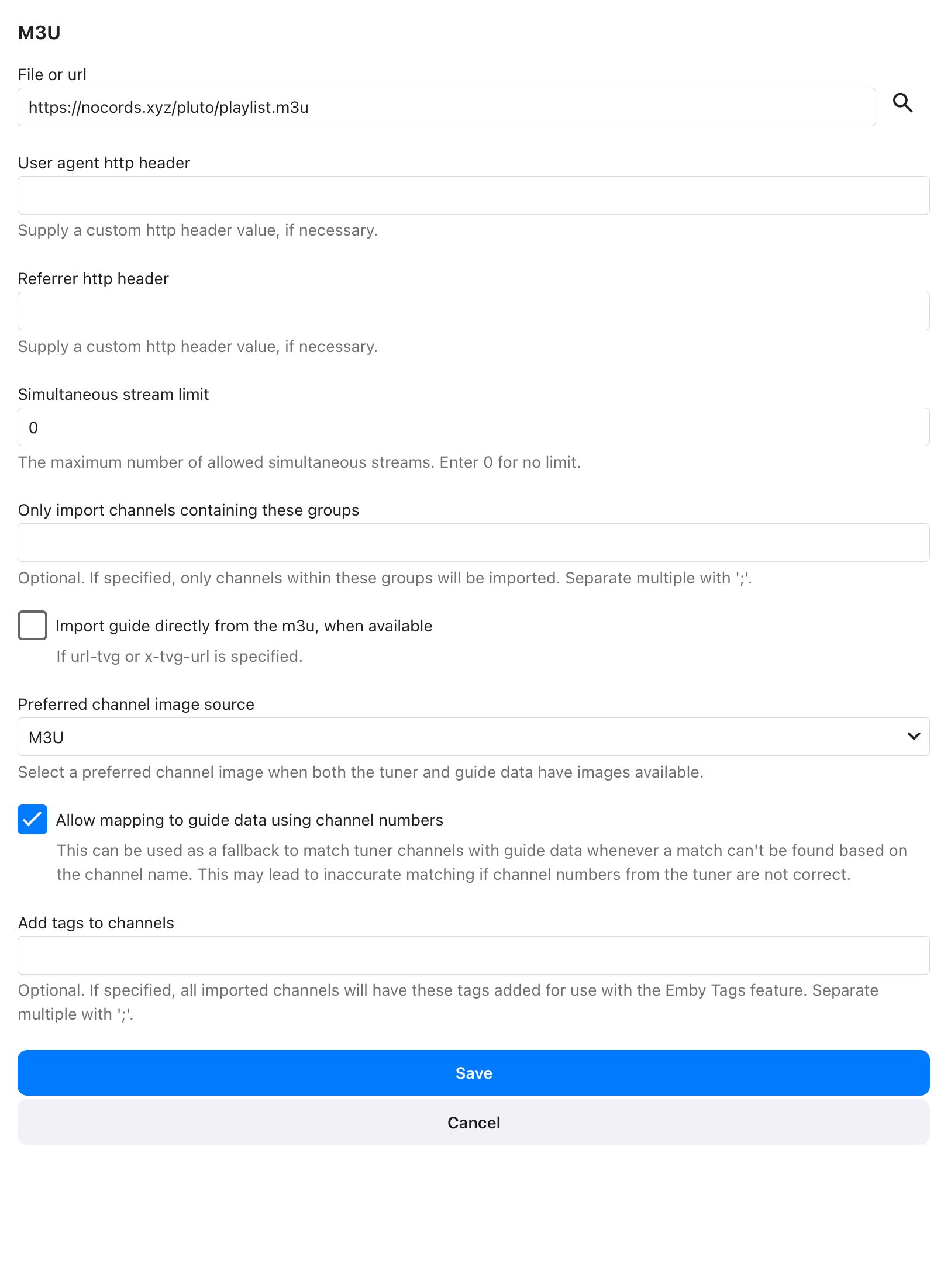

EkoOne 5 Posted January 30, 2025 Posted January 30, 2025 Here are the Emby/Pluto Source and Guide settings.
daldana 126 Posted January 30, 2025 Posted January 30, 2025 @EkoOneTry this as the M3U url instead; http://xxx.xxx.xxx.xxx:8089/devices/M3U-PlutoTV/channels.m3u?format=ts. The way you have it setup now, it's not pulling through Channels. 1
