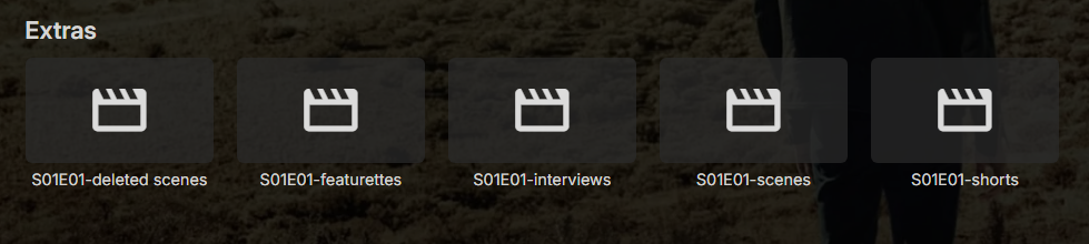

Happy2Play 9798 Posted May 10, 2024 Posted May 10, 2024 Should season level extras appear in Specials/Season 0 and the Season they are applied in? Extras applied in Season 3 but appear in both 0 and 3. What is the official rule for episodes? Is it -featurette and/or subfoldered episodes with featurettes folder? Do all the same variables apply to the dash naming and subfolder episode level naming? Support for specials right next to the episode files: Doctor Who (1963) S01E01 - Episode Title-featurette.mp4 But further documentation will be needed for what will work against specific episode. Doctor Who (1963) S01E01 - Episode Title-Deleted Scenes.mp4 Or if nested episode structure will work. Doctor Who (1963)\Season 1\Doctor Who (1963) S01E01\Doctor Who (1963) S01E01.mkv Doctor Who (1963)\Season 1\Doctor Who (1963) S01E01\Extras\Deleted Scenes S01E01.mkv Along with documentation for multi-version episodes and extras.
Luke 42184 Posted May 12, 2024 Posted May 12, 2024 Both methods should work for episodes. The folder method requires the episode to be in its own subfolder.
Happy2Play 9798 Posted May 12, 2024 Posted May 12, 2024 14 hours ago, Luke said: Both methods should work for episodes. The folder method requires the episode to be in its own subfolder. Yes but what are all the dash extensions available? Are they pretty must the same subfolder names? I know -extras/-extra does not work as it multiversions. So episode conditions are still unknown. But testing shows -extras (doesn't work) -specials (doesn't work) -shorts -scenes -featurettes -behind the scenes (doesn't work) -deleted scenes` -interviews As not much has really changed in the KB as the example is just aliased Specials/Season 0 structure ie Show/Series level. But yes does mention same applies to season level but true examples are still needed along with specific episode info/examples.
Luke 42184 Posted May 16, 2024 Posted May 16, 2024 extras and specials are for subfolders, not the dashes. behind the scenes with a dash would be without spaces. @sa2000can update the doc. Thanks.
