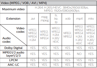

shadowtheimpure 12 Posted June 4, 2024 Author Posted June 4, 2024 A Philips 'smart TV' from a number of years ago (Model 55PFL5402/F7). It struggles with playback via DLNA in the default configuration. I've attached the Video section from the manual. What I really want to accomplish with a custom profile is to engage a transcode to a compatible format rather than failing to start playback.

shadowtheimpure 12 Posted June 10, 2024 Author Posted June 10, 2024 So, have no formats in direct play and define a transcoding format that complies with the chart from the manual?
