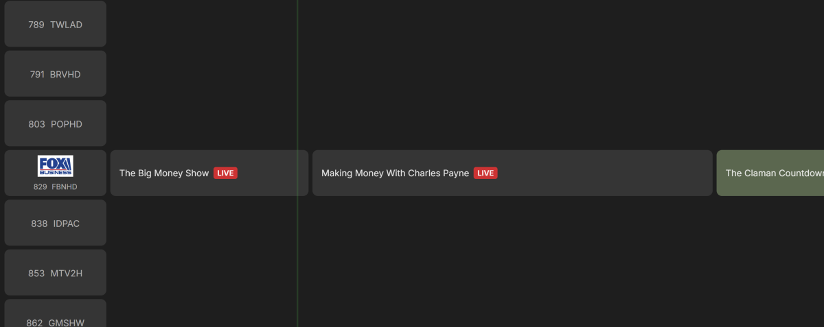

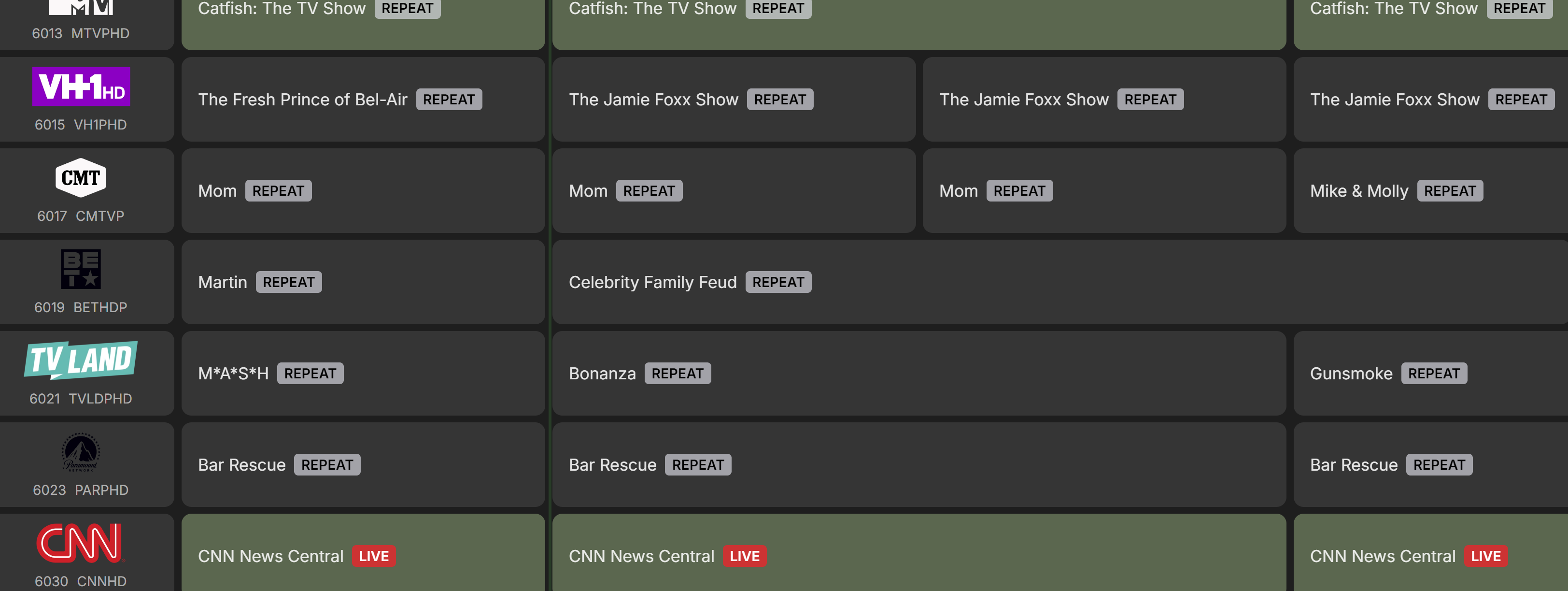

Sammy 791 Posted June 7, 2024 Author Posted June 7, 2024 Already set it up and disabled the HDHomeRun Primes and did a guide refresh but a lot of channels linger. How long before these clear? Thus far in limited testing the guide looks to be solid though: Pretty sure I'll be doing some renumbering and sorting. Well after 13 years from Windows Media Center to Emby I will disconnect my Primes and return two CableCARDs and Tuning Adapters. Goodbye to an era, it's been a good run! The best Spectrum could do was going to cost me about $40 a month more so I dropped TV and bumped my internet to Gig. With YTTV and Channels it will still cost me about $5 LESS than I was currently paying. And they wonder why they're bleeding customers in the linear TV market!

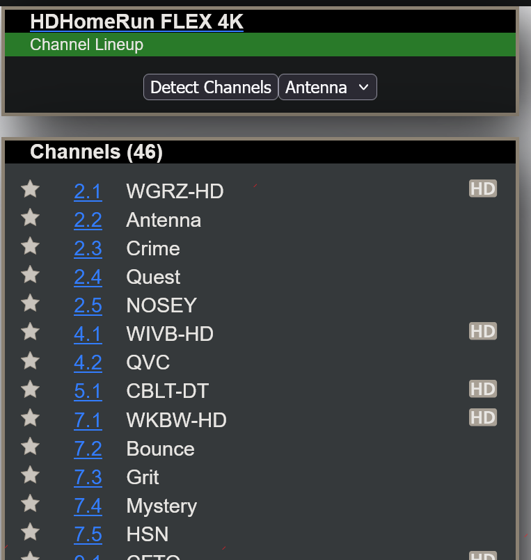

TMCsw 259 Posted August 21, 2025 Posted August 21, 2025 You can test if it’s worth it with something like this TV Antenna, (direct hookup to a TV with an ATSC tuner built-in for testing) something like that’s all I need and it picks up channels from 2 cities (Toronto & Buffalo) : If you get a decent number of channels, then you can look at getting a better antenna for the attic or roof and a HDHR to get it to emby. Note: if it has a booster, try it with and without the booster installed (some of the cheap boosters, boost the noise more than the signal).
Ronstang 294 Posted August 22, 2025 Posted August 22, 2025 5 hours ago, TMCsw said: You can test if it’s worth it with something like this TV Antenna You know that was actually the strategy I decided on late last night. I would just order a cheapie antenna like the one you suggested and if I get any kind of signal that gives me promise I will return it and buy one of the bigger nicer ones that install in the attic and then install that. Then if I can get the channels I care about with good signal I will go ahead and order an HDHomerun Flex 4K that has 4 tuners and be done with it. It will be about the same as 1 month of cable so after next month it's paid for but I get to use it for years. I am used to 4 tuners minimum so I will just suck it up and buy the good one.
