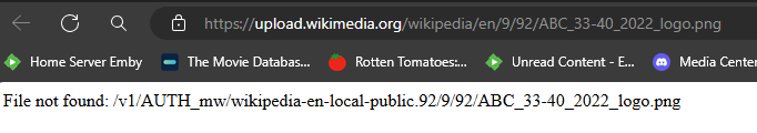

Happy2Play 9811 Posted June 5, 2024 Posted June 5, 2024 But that url can not be opened. But there are lots of wiki images this way as that is not the correct link. 1
Happy2Play 9811 Posted June 5, 2024 Posted June 5, 2024 And how about this one? As it is a different url. https://upload.wikimedia.org/wikipedia/commons/9/92/ABC_33-40_2022_logo.png 1
