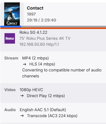

Lessaj 477 Posted June 3, 2024 Posted June 3, 2024 That log is unfortunately not the most useful since it's only the hardware detection. That stream is only transcoding the audio which is a very lightweight operation so this shouldn't be transcoding related. I'm not familiar with Roku if there's any settings related to playback, if it advertises support for HEVC it should be able to handle a 2 Mbps stream... 1
