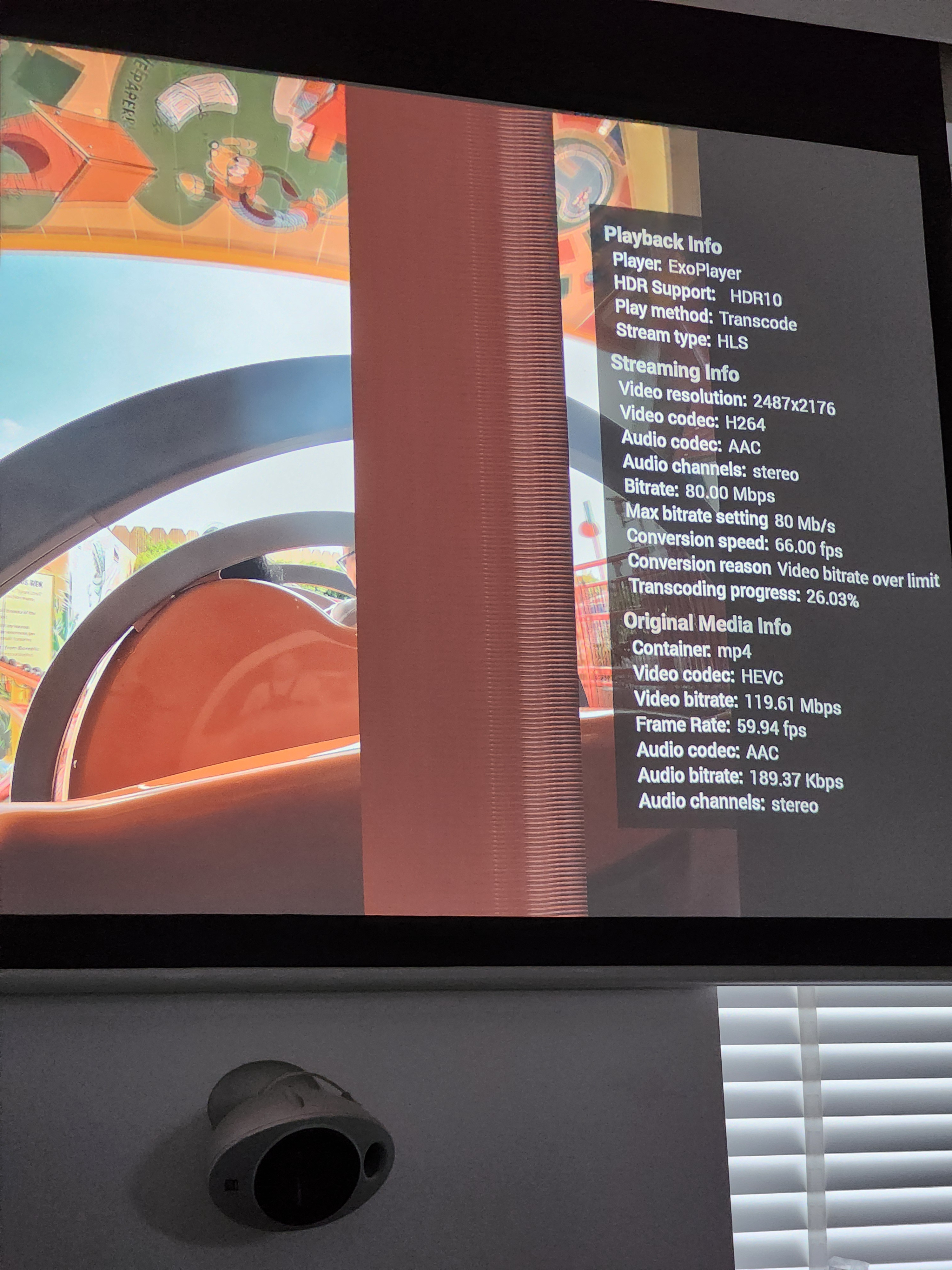

mrbenjaminryder 4 Posted June 1, 2024 Posted June 1, 2024 Hello, When viewing videos that I filmed on my GoPro at 120Mbps/4K I get a thick bar through the screen. The original footage doesn't have this bar. It plays correctly in Windows both via the original file or via Emby in a browser window and also on my Android phone, it just appears to happen when watching via the Fire TV. I've also tried the Playback Correction and it doesn't make a difference. Image attached. Any idea how I can get then to play back correctly? Many thanks. Ben.
Luke 42243 Posted June 1, 2024 Posted June 1, 2024 Hi. Can you try searching for our standard android app (Just "Emby" on Amazon and "Emby for Android on Google) on the same device's app store and see how that compares? Thanks.
mrbenjaminryder 4 Posted June 1, 2024 Author Posted June 1, 2024 25 minutes ago, Luke said: Hi. Can you try searching for our standard android app (Just "Emby" on Amazon and "Emby for Android on Google) on the same device's app store and see how that compares? Thanks. OK so a very very quick test and the bar is gone, but getting lots of dropped frames however I've readded the library so that could well be the issue. I'll try again later to confirm whether it plays back successfully. 1
