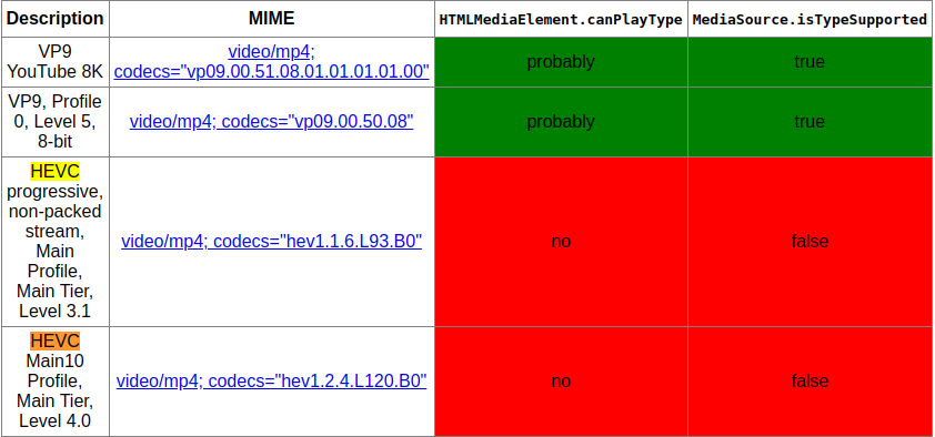

softworkz 5121 Posted May 30, 2024 Posted May 30, 2024 16 minutes ago, Lessaj said: My browser doesn't even support HEVC and yet always picks the 4k HDR in HEVC rather than the 1080p in H264. Which one is that? What result do you get when visiting this page? https://cconcolato.github.io/media-mime-support/#other_video_codecs AFAIR, we're using the same method for checking.

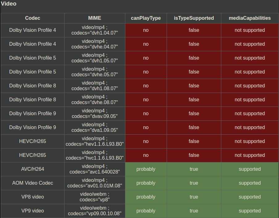

Lessaj 477 Posted May 30, 2024 Author Posted May 30, 2024 15 minutes ago, softworkz said: Which one is that? What result do you get when visiting this page? https://cconcolato.github.io/media-mime-support/#other_video_codecs AFAIR, we're using the same method for checking. Chromium 125.0.6422.60 on Linux. These are the only HEVC entries on that page. I recall seeing this page linked before as well https://ott.dolby.com/codec_test/index.html

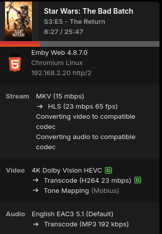

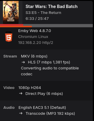

Lessaj 477 Posted May 31, 2024 Author Posted May 31, 2024 (edited) 3 minutes ago, softworkz said: Wait - you said that it would remux or directplay HEVC even though your browser doesn't support it, no? It would transcode the HEVC file. The 1080p version is generally h264, so that would direct play or remux the audio. In this example when I navigated to the episode it automatically selected the 4k HDR which required a transcode to play, the 1080p just remuxes the audio. Edited May 31, 2024 by Lessaj

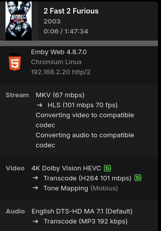

Lessaj 477 Posted June 1, 2024 Author Posted June 1, 2024 (edited) 18 minutes ago, softworkz said: Do you still see this happening? I thought we had fixed this from happening some time ago (like a year)... Yes I believe so, this is what is reported on my dashboard and within the user sessions page. TS chunks are averaging probably 38-40 MB so for a movie that's 107 minutes (6420 seconds) that's 2140 chunks which works out to 85.6GB but the original file is 50.4GB. EDIT: Added ffmpeg transcode log as well. ffmpeg-transcode-6c207ad7-ce84-4211-af28-507ed6388c2d_1.txt Edited June 1, 2024 by Lessaj

softworkz 5121 Posted June 1, 2024 Posted June 1, 2024 (edited) 12 minutes ago, Lessaj said: Yes I believe so, this is what is reported on my dashboard and within the user sessions page. TS chunks are averaging probably 38-40 MB so for a movie that's 107 minutes (6420 seconds) that's 2140 chunks which works out to 85.6GB but the original file is 50.4GB. 101 Mbps for a H264 HLS stream is definitely not healthy, not even for 4k. I think there's still some crude logic which assumes that it takes double (earlier) or 1.5-times the bandwidth for an H264 stream to match the quality of an HEVC stream, but this doesn't take into account the fact that HEVC is 10but whereas H264 output is not HDR and neither the plane packing which may be 444 or 422 while it's always 420 for H264 (making it impossible to match HEVC not matter how much bandwidth you allow). That needs adjustment. @Luke Edited June 1, 2024 by softworkz 1
softworkz 5121 Posted June 1, 2024 Posted June 1, 2024 (edited) 8 minutes ago, softworkz said: That needs adjustment. @Luke More specifically: A formula rather than just a factor change . Besides the implications I mentioned above, it also needs discrimination between high and low bandwidth orders. Edited June 1, 2024 by softworkz
