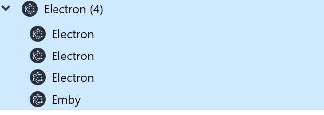

Luke 42235 Posted July 6, 2024 Posted July 6, 2024 Does any window come up at all? Do you have instances of electron.exe running?

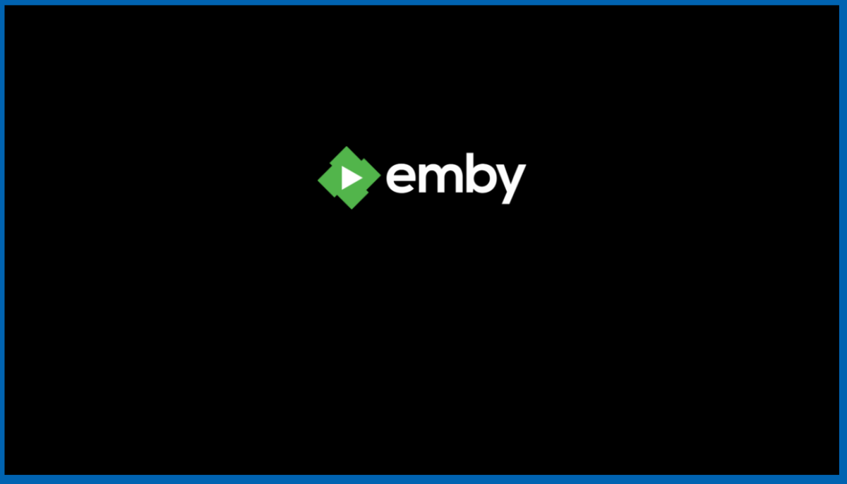

R0oF! 1 Posted July 7, 2024 Author Posted July 7, 2024 (edited) As I wrote in the initial post: When I start the application it's just stuck at the splashscreen. When I start Emby i got 3 instances of electron running and one instance of emby. thats how the splayscreen looks: seamless and it stays like this forever. Edited July 7, 2024 by R0oF!

Luke 42235 Posted July 13, 2024 Posted July 13, 2024 On 7/7/2024 at 7:35 AM, R0oF! said: As I wrote in the initial post: When I start the application it's just stuck at the splashscreen. When I start Emby i got 3 instances of electron running and one instance of emby. thats how the splayscreen looks: seamless and it stays like this forever. Hi, can you reboot the machine and try again? Are you still having this issue?
