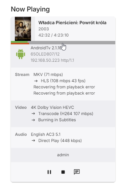

rashV 1 Posted May 31, 2024 Author Posted May 31, 2024 HI! If I reenable those, I'm getting the same issue I was having on plex, it doesn't crash, but it stops direct playing, starts transcoding, and in doing so it loses the HDR. That is the reason why I wanted to try out emby in the first place. I'm attaching the screenshots from the dashboard, before and after transcoding starts, and new logs. Is there any way we could make direct playing work? embyserver.txt ffmpeg-transcode-dbff2295-cb8c-4b42-9e4e-cdb8e8b0b35f_1.txt ffmpeg-transcode-eaf0caca-0bbf-43ca-a0f4-4114c1962aa9_1.txt

rashV 1 Posted May 31, 2024 Author Posted May 31, 2024 I tried another file, and there is a new situation now. The dashboard says its direct play, however the movie is clearly being displayed without dolby vision. The movie stopped being played, loader was showing for 30s, then it started again, this time, the dolby vision is clearly gone, all colors are washed out. But the dashboard is still displaying Direct Play. Logs are also showing that it started to transcode. But the dashboard is claiming to direct play, it must be showing it incorrectly.
ebr 16337 Posted May 31, 2024 Posted May 31, 2024 Something about these files is causing errors when trying to direct play. This is indicated in your screen shots. Can you try searching for our standard android app (Just "Emby" on Amazon and "Emby for Android on Google) on the same device's app store and see how that compares? Thanks.
