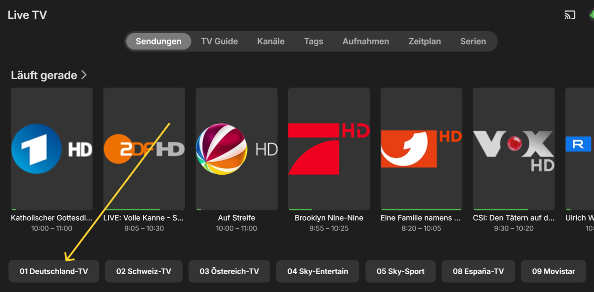

hdsuisse 14 Posted May 30, 2024 Posted May 30, 2024 (edited) When I switch to Live-TV in the Samsung app, the lower channel groups are all empty. it works with the web browser Samsung model number: QE55Q60RATXXC Samsung firmware version: T-MSMDEUC-1420.0 Samsung Emby client version: 1.7.0 Emby server version: 4.9.0.22 Beta Edited May 30, 2024 by hdsuisse
Luke 42239 Posted May 30, 2024 Posted May 30, 2024 Hi, that's really odd. It could be a defect in that Emby Samsung version I suppose. Are you able to try installing the latest via USB? https://emby.media/emby-for-samsung-smart-tv.html
