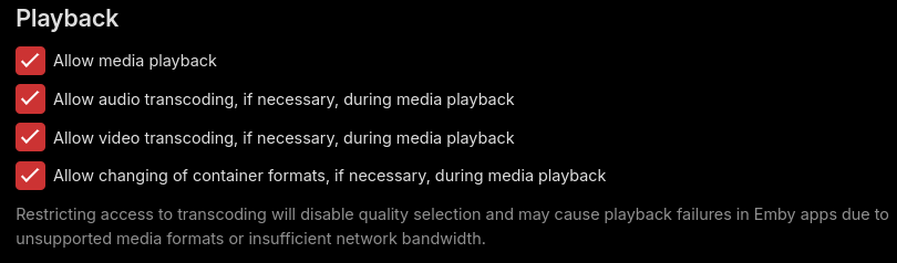

Lessaj 484 Posted May 29, 2024 Posted May 29, 2024 (edited) It looks like you need to review the user settings for this profile because you've disabled any transcoding or remuxing - the key here is likely remuxing, the devices might not support an audio format for example and it needs to be remuxed rather than direct played. This is a minimal CPU overhead operation. Quote User policy for moez. EnablePlaybackRemuxing: False EnableVideoPlaybackTranscoding: False EnableAudioPlaybackTranscoding: False Something else of note, you said you have a cloudflare/nginx reverse proxy setup with certificates but all the traffic in this log is HTTP not HTTPS, so I don't think you're actually taking advantage of this setup. EDIT: Actually looking a little closer I see some information in the headers about it being https so I guess you're just proxying to the HTTP port and that's why it still comes up as an http URL. I know within a home environment you shouldn't really need to proxy to an HTTPS port but it's just a habit I've gotten into from my professional experience with enterprise networks. Edited May 29, 2024 by Lessaj 1 1
intersect 5 Posted May 29, 2024 Author Posted May 29, 2024 (edited) Interesting, the issues are no longer there. I added the remote address into emby and restored the user permissions now it works. Thanks mate appreciate your efforts! Edited May 29, 2024 by intersect 2
