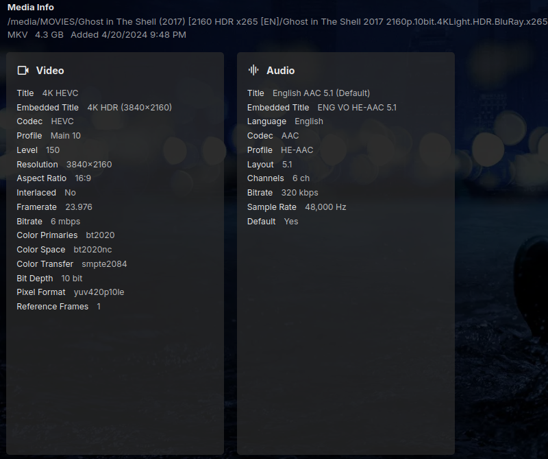

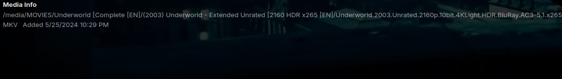

I have noticed this regarding the videos details :
This file was there before the update :
This file was added after the update :
I have no information on the file.
On the TV, the files with all the information works fine and the others just don't work.
On the PC, not a single file works.
