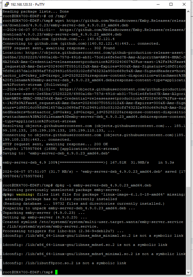

Luke 42242 Posted June 7, 2024 Posted June 7, 2024 @TDriverwhile you wait, I do have a question. Can you try to install our existing Debian package? From some quick google searching it looks like Ugreen is based on Debian. It might already work as it is.

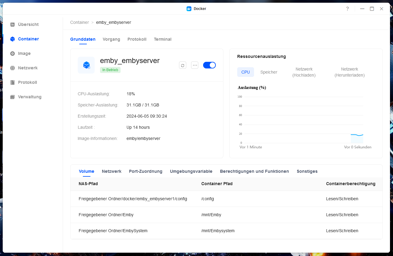

TDriver 53 Posted June 7, 2024 Author Posted June 7, 2024 (edited) Good morning, yes I can install Debian packages. At the moment I have Emby running in a Docker, it works great I will post a guide later. Edited June 7, 2024 by TDriver 1
TDriver 53 Posted June 7, 2024 Author Posted June 7, 2024 (edited) Yes, I can do that. I'll let you know as soon as I've tried it. Do you just need the information whether it works or also log files? Â Â Â Â Edited June 7, 2024 by TDriver

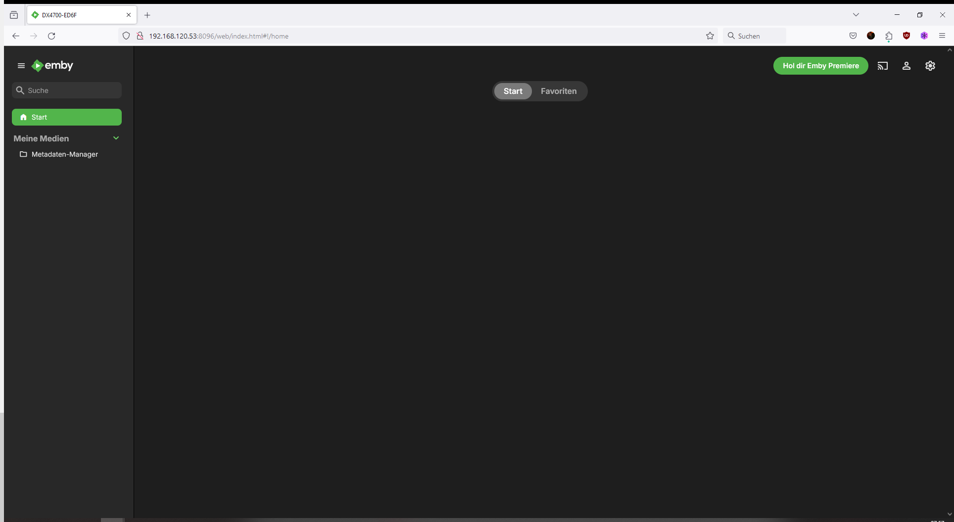

TDriver 53 Posted June 7, 2024 Author Posted June 7, 2024 (edited) The installation works without any problems.I have now carried out the installation on my test box a Ugreen DX4700. embyserver(3).txt hardware_detection-63853343573.txt Edited June 7, 2024 by TDriver 1

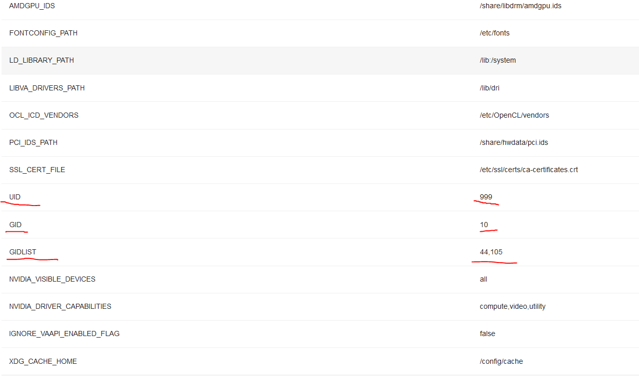

Svennie 4 Posted June 10, 2024 Posted June 10, 2024 Docker is not a nice solution on UGreen 4800+ I can't scan the folders and no new medians are shown. 1

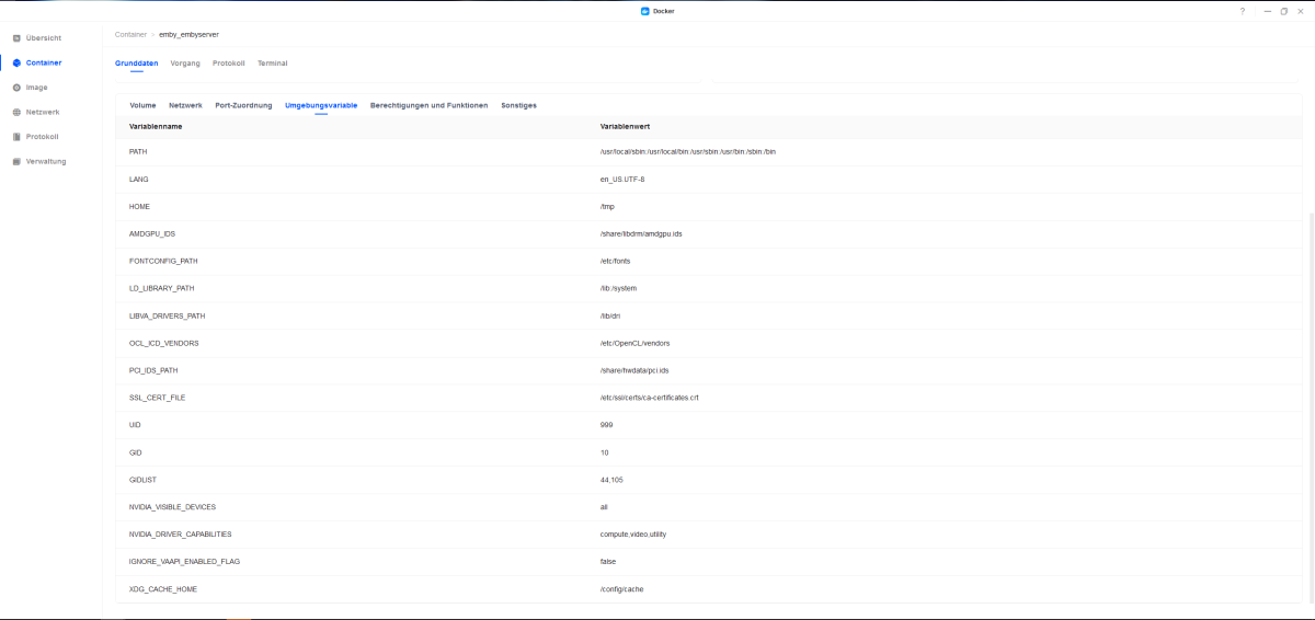

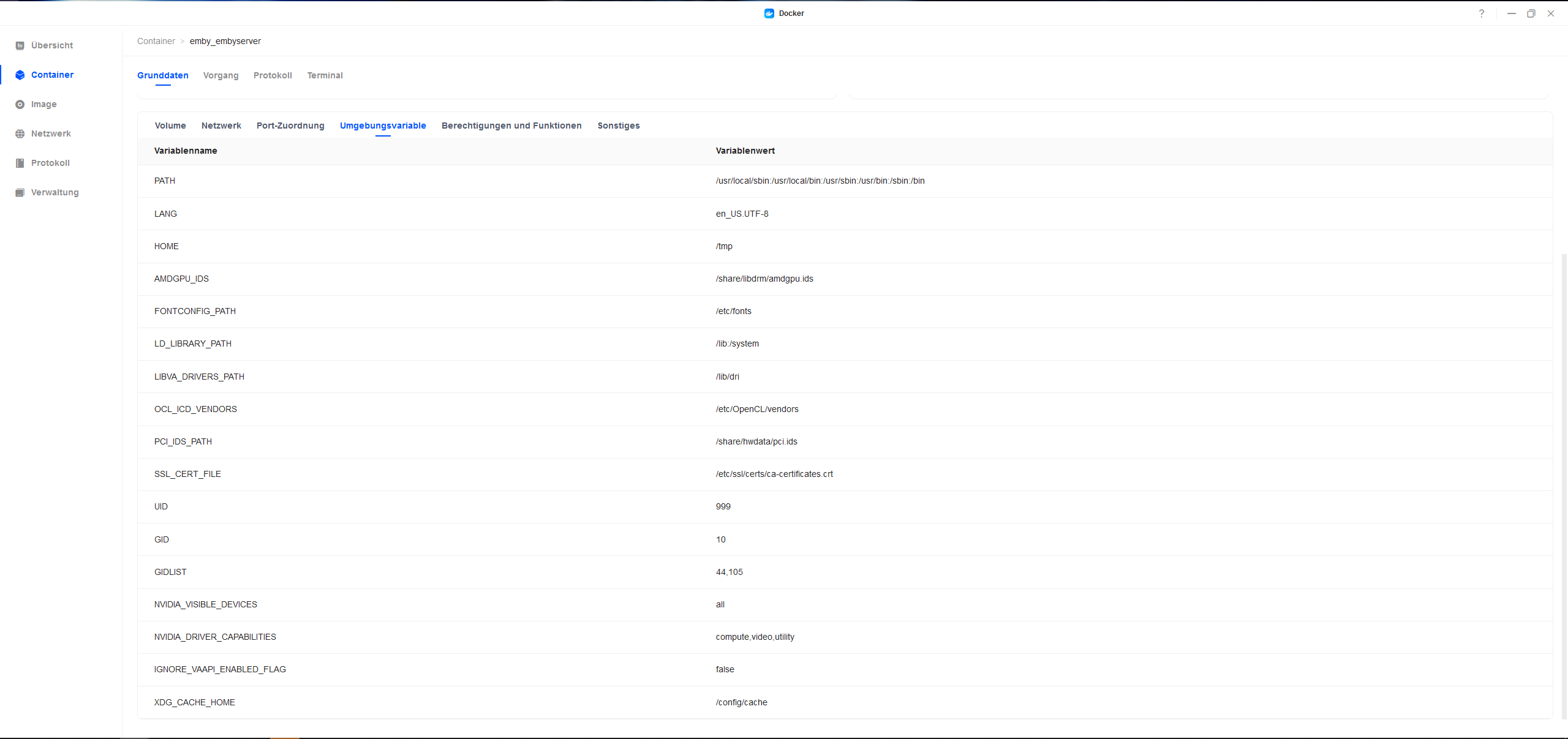

TDriver 53 Posted June 10, 2024 Author Posted June 10, 2024 (edited) I can't understand the problem, what do you have entered here? Docker --> Container --> Emby server --> Environment variable The user who has access to the media folder must be entered under UID / GID. The first user on the Ugreen NAS has the UID 999 and GID 10. If the first user also has access to this folder, you can use this UID and GID. This can also be found in the manual for the container, but unfortunately most people don't read the manuals https://hub.docker.com/r/emby/embyserver Which Docker image are you using? https://hub.docker.com/r/emby/embyserver @LukeI would like to make a guide for installing Emby in Docker on a UGreen NAS. Should I post this here in the general area or can you make another "Ugreen" category? Â Edited June 10, 2024 by TDriver

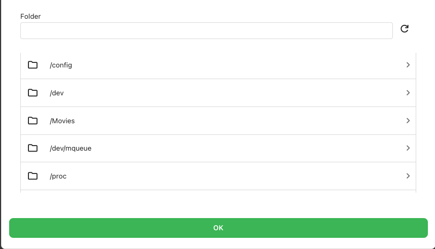

byamaato 0 Posted June 11, 2024 Posted June 11, 2024 Creating my media folders in Emby and I see the shared folders that I have my media in but for some reason, they are not selectable when I try and create a media folder in Emby.  Any ideas why the folders can't be selected? I'm at a loss... Â
TDriver 53 Posted June 11, 2024 Author Posted June 11, 2024 Same problem, same solution. See my previous post  Â

Jägs 86 Posted February 24, 2025 Posted February 24, 2025 On 6/11/2024 at 2:55 PM, byamaato said: Creating my media folders in Emby and I see the shared folders that I have my media in but for some reason, they are not selectable when I try and create a media folder in Emby.  Any ideas why the folders can't be selected? I'm at a loss...  Were you able to figure this out? If you are running the Debian package, the way I worked around this was to first create a group and add the "emby" user to it, since UGOS does not list the "emby" user in the interface (the "emby" user is created during the installation process). In that way, I can manage its permissions in UGOS. 1.) Create a User Group in UGOS (Control Panel —> User Management —> click on the User Groups tab on the top. I called mine "media." 2.) Via the command line, edit the /etc/group file (e.g., "sudo nano /etc/group"). 3.) Find the group you created in step one and add the "emby" user to the end of the list of users 4.) Now, go back into UGOS's File Manager, navigate to the folder in question, right-click on it and select Properties. 5.) Click on the "Permissions" and you should see the group you just created. You can now set its permissions in any folder for this group and Emby will have those permissions.
