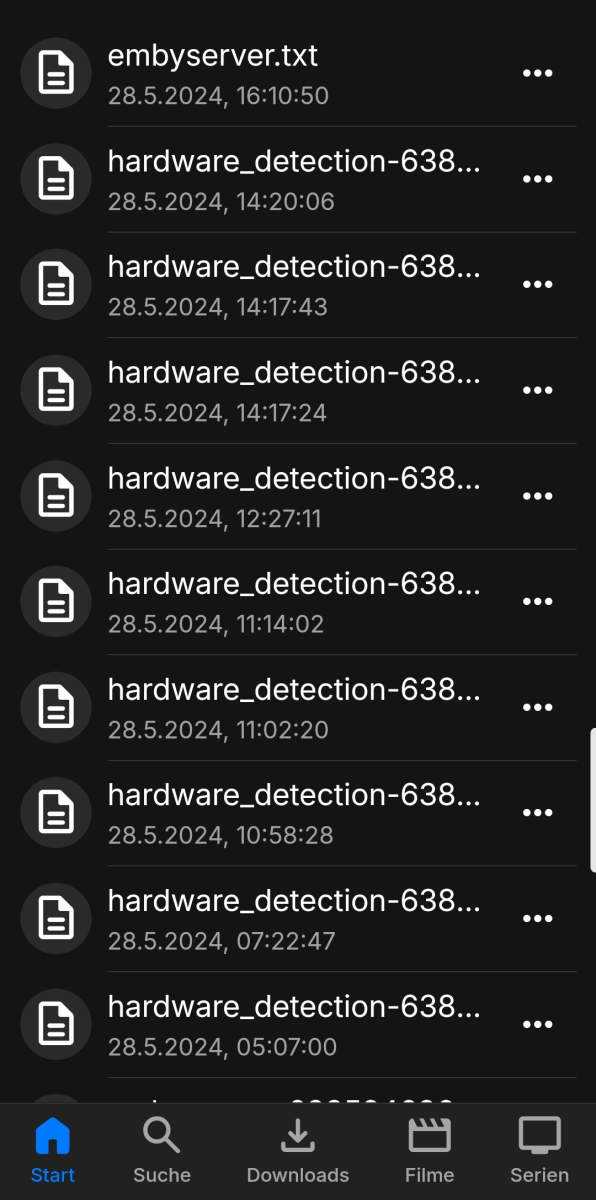

WeAreBasstards 0 Posted May 28, 2024 Posted May 28, 2024 Hello dear Emby Community, I have noticed in the past few days that Emby is creating quite a lot of hardware detection logs. Is this normal? It seems to vary by day; sometimes it doesn't create any, and other times it creates quite a few. The operating system is Windows Server 2022. The Emby version is listed in the log. All drivers and respective updates are up to date. I look forward to your responses. I have attached the log. hardware_detection-63852469620.txt

Lessaj 486 Posted May 28, 2024 Posted May 28, 2024 Might need to see some other server logs, but I think hardware detection is being triggered because the display settings changed? Quote 2024-05-28 07:22:36.869 Debug SystemEvents: SystemEvents_DisplaySettingsChanged .... 2024-05-28 07:22:46.871 Debug TaskManager: SystemEventTrigger fired for task: Hardware Detection 2024-05-28 07:22:46.871 Debug TaskManager: Queueing task HardwareDetectionScheduledTask 2024-05-28 07:22:46.871 Debug TaskManager: Executing Hardware Detection
WeAreBasstards 0 Posted May 28, 2024 Author Posted May 28, 2024 But why so often during the day? The ad settings certainly don't change that often
Lessaj 486 Posted May 28, 2024 Posted May 28, 2024 The log you provided only goes to 9:03 so I don't know what events are near 10:58, 11:02, 11:14, etc. Need the latest log.

Lessaj 486 Posted May 28, 2024 Posted May 28, 2024 (edited) Yes it's reporting the display settings are changing. Check in your event viewer maybe the display driver is crashing or something? The hardware detection runs about 10 seconds after these events. Quote 2024-05-28 10:58:18.054 Debug SystemEvents: SystemEvents_DisplaySettingsChanged 2024-05-28 11:02:10.120 Debug SystemEvents: SystemEvents_DisplaySettingsChanged 2024-05-28 11:13:52.244 Debug SystemEvents: SystemEvents_DisplaySettingsChanged 2024-05-28 12:27:01.153 Debug SystemEvents: SystemEvents_DisplaySettingsChanged 2024-05-28 14:17:13.808 Debug SystemEvents: SystemEvents_DisplaySettingsChanged 2024-05-28 14:17:33.056 Debug SystemEvents: SystemEvents_DisplaySettingsChanged 2024-05-28 14:19:56.103 Debug SystemEvents: SystemEvents_DisplaySettingsChanged Edited May 28, 2024 by Lessaj
