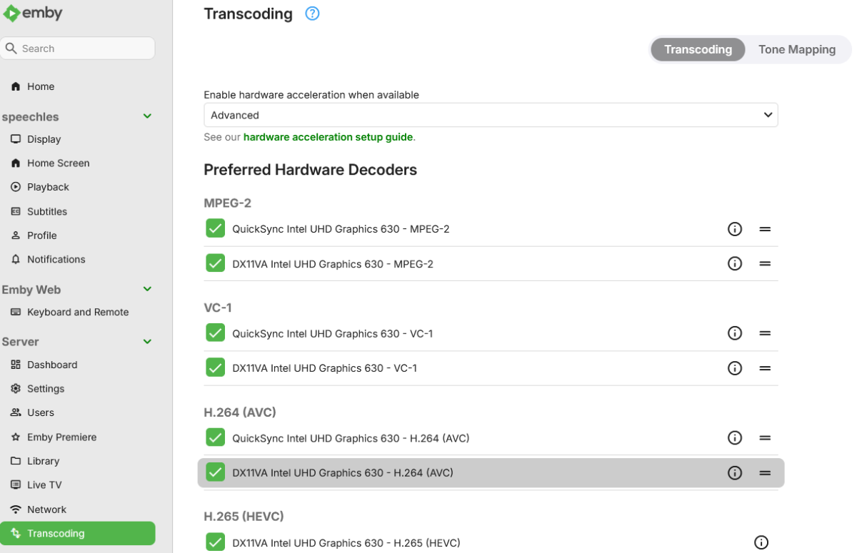

speechles 2062 Posted May 27, 2024 Posted May 27, 2024 It might be the way hardware transcoding is applied. >>>>>> Hardware Decoders for h264 [X] VAAPI GeminiLake UHD Graphics 600 - H.264 (AVC) [X] QuickSync GeminiLake UHD Graphics 600 - H.264 (AVC) >>>>>> Hardware Encoders for h264 [X] VAAPI GeminiLake UHD Graphics 600 - H.264 (AVC) [X] QuickSync GeminiLake UHD Graphics 600 - H.264 (AVC) If move up QuickSync above VAAPI does it still have an issue?
speechles 2062 Posted May 27, 2024 Posted May 27, 2024 Just just left click and hold then drag one above the other. Or just uncheck one of them to try the other. Quicksync works best with me and the Roku.
chrisrobbins1970 82 Posted May 28, 2024 Author Posted May 28, 2024 ok i made the switch... I'm assuming I leave it on advanced, if I go back to YES then all switches back..

chrisrobbins1970 82 Posted May 29, 2024 Author Posted May 29, 2024 @speechlesI think you might have something there with the changing the decoders. So far no one has said anything to me...but i'll keep you posted. The one with the TV still has not informed me either yes /no if that is the solution..BUT..i have noticed my CPU usages has gone down 1 1
chrisrobbins1970 82 Posted May 31, 2024 Author Posted May 31, 2024 @speechlesGood News.. That seems to of been the trick. User has watched movies and tv shows with NO video freezing.... Thank you
