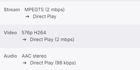

Brian_Oblivion 4 Posted May 27, 2024 Posted May 27, 2024 Hi, Having a problem that just recently popped up when I added some IPTV channels to my TVHeadend server that my Emby server is connected to via the tvheadend plugin. All of this is on the same machine that I also have an OTA tuner card in. It's running the latest ubuntu 24 LTS. My server is VERY lightly used with typically 1 user connect directly on my home network. It's quite likely this has been happening for sometime for my OTA liveTV channels but never got to the be point of being super annoying. But I've added new IPTV channels to tvheadend and it takes 30+ seconds to tune one of those channels. Investigating the problem, I naturally looked if it is transcoding. On the client, an Amazon FireCube, stats for nerds reports direct stream on both audio and video. On the emby dashboard, it also reports direct streaming for audio/video when watching any livetv channels (OTA or IPTV). I do NOT have "live seeking" enabled, to confirm if I press pause it prompts me if I want to switch playback mode to live seek. The client settings has the enable live seek checkbox unchecked. However, when I go into the emby transcoding temp folder on the machine, it very clearly is creating a new folder and that contains .ts files every time I tune a channel - either OTA OR IPTV. Then when I tune away from it, I can see the folder get deleted/cleaned up. I've tried about everything I can think of, but I can't make it stop. I suppose it might be related to my tvheadend config. There is another thread about livetv buffering I'm watching, as this problem seems a little related Any suggestions for things to try?

Brian_Oblivion 4 Posted May 29, 2024 Author Posted May 29, 2024 Interesting... didn't even know that was available. I did install it and test it and the slow tuning performance is improved dramatically using the "android app". More typical <5 second tuning and doesn't take a minute etc... however the picture/sound quality is noticeably poorer. So, hmmm, maybe it is transcoding somewhere? Using the non-android version on my firecube, emby dashboard and the client stats for nerds says it's direct streaming. The "mux" the tvheadend server (also on the same machine) is using is streamlink (also running on the same server). Don't know if that helps any.
Luke 42241 Posted May 29, 2024 Posted May 29, 2024 Quote I did install it and test it and the slow tuning performance is improved dramatically using the "android app". More typical <5 second tuning and doesn't take a minute etc... however the picture/sound quality is noticeably poorer. So, hmmm, maybe it is transcoding somewhere? Hi, did you explore the stats feature in the video player to learn if it was transcoding or not?
Brian_Oblivion 4 Posted May 29, 2024 Author Posted May 29, 2024 Yes. With the "Android" version streaming one of these troublesome channels, it reported direct streaming across the board on the client and on the emby dashboard. I still do see files being created in the transcoding temp directory for emby. And those files grow and new ones get added while watching (*.ts files). It's easy to see since I am the sole person watching a channel :-). When I tune away, the directory/files all disappear (cleaned up).
