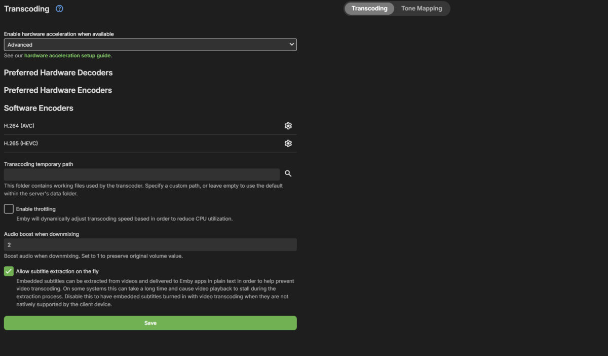

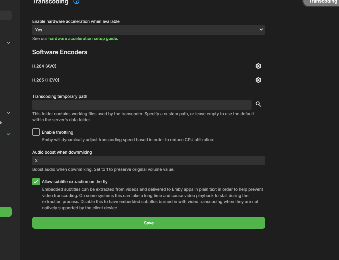

MrBonk 0 Posted May 31, 2024 Author Posted May 31, 2024 Hey @Luke, I originally was trying to solve stutter by converting, as I noticed transcoding was 100% CPU utilization, think I have a different problem. I am using a Synology DS1520+ and I do not have any options under the Transcoding settings. Also, I attached the hardware report. With this particular system I thought there was a hardware transcoder VAAPI? hardware_detection-63852708802.txt
Luke 42241 Posted May 31, 2024 Posted May 31, 2024 That display is normal when you select Yes. It's only when you select Advanced that you see more options.
