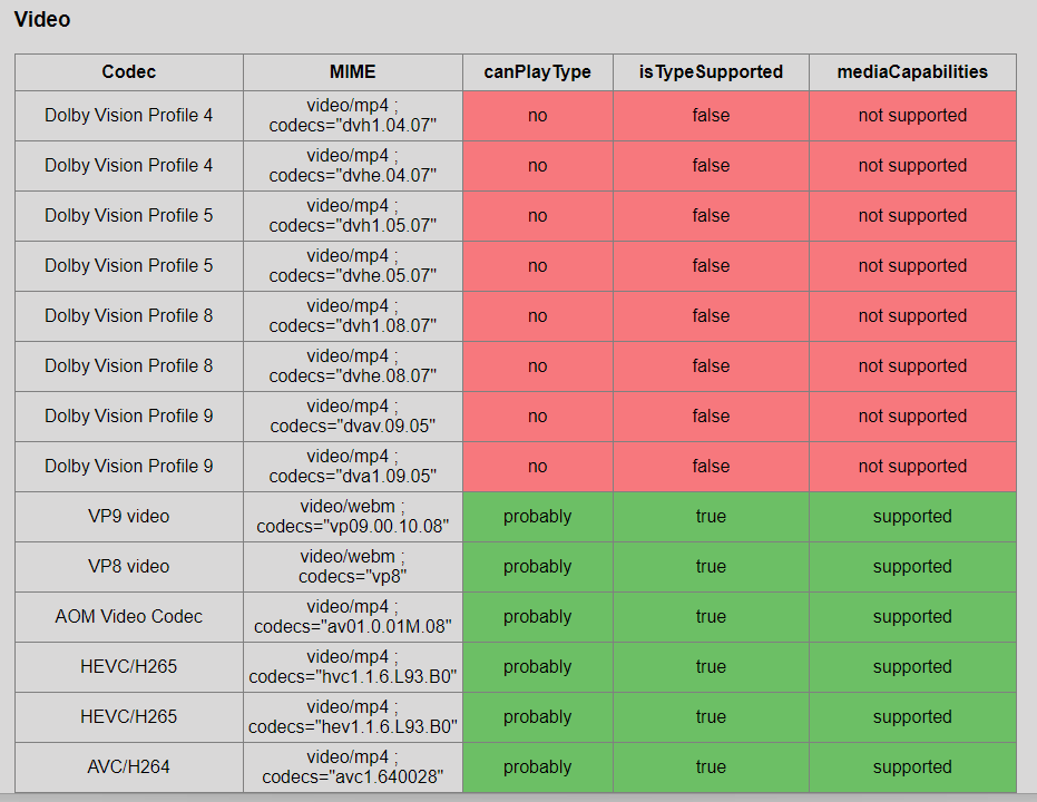

Happy2Play 9811 Posted May 27, 2024 Posted May 27, 2024 In reference to Chrome it is more about your hardware but yes every browser will/can have different supported codecs. my Chrome/Edge per that test site I linked You may have better luck using Desktop ET if you are a Premiere user. 1
