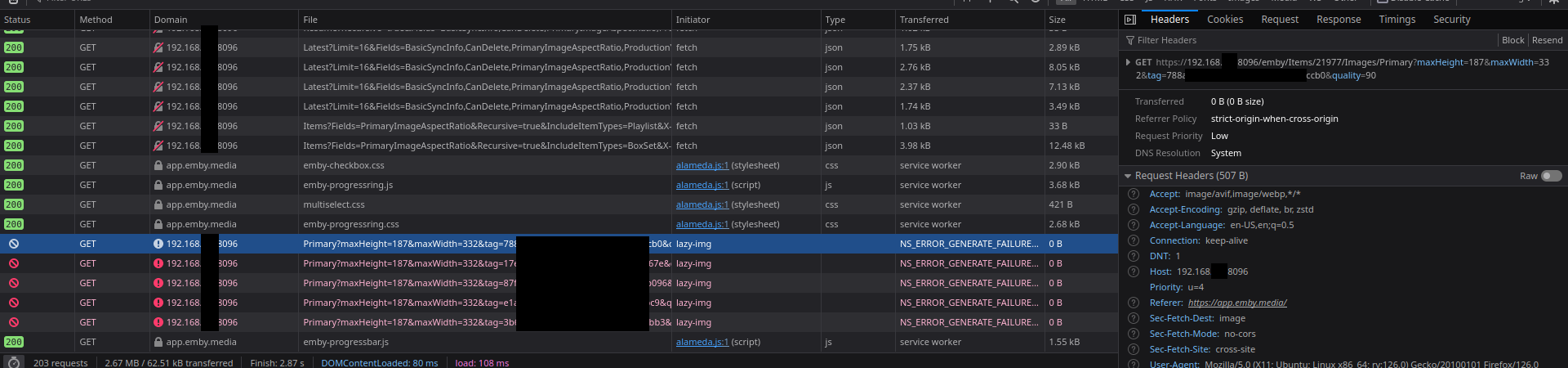

iissmart 0 Posted May 27, 2024 Author Posted May 27, 2024 14 hours ago, Luke said: Are the data requests using https? I think I see two sets of requests. First there is a set of requests for http://192.168.x.y:8096, looks like that succeeds but with an insecure icon (lock icon with a red slash through it), then another set of requests for https://192.168.x.y:8096 that fail with NS_ERROR_GENERATE_FAILURE(NS_ERROR_MODULE_SECURITY, SSL_ERROR_RX_RECORD_TOO_LONG).
Lessaj 484 Posted May 27, 2024 Posted May 27, 2024 Yea it's trying to use https on port 8096 but that won't work since that listener only responds to http requests, it needs to be using 8920 if it's going to try https, so you might just want to connect to the server on 8920 instead which is always https.
