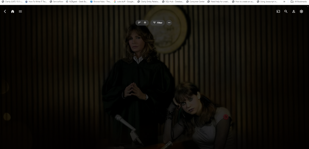

bwarthen 13 Posted June 1, 2024 Author Posted June 1, 2024 I mean that I'm making the names based off of which movies or shows have been watched the last 3 of each to be precise and when I set the name the way I was the result was a mixture of shows and movies as seen in my screenshot. I've figured that part out I believe but I need to figure out how to display tv series with the episodes that belong to that series.
Luke 42234 Posted June 1, 2024 Posted June 1, 2024 You mean the name of the entire channel? If so, that's never been done before so I'm not sure if that will be a problem or not. But you can do that for content underneath the channel.
