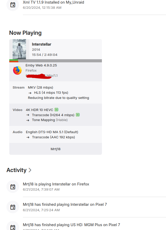

mrtj18 4 Posted June 21, 2024 Author Posted June 21, 2024 (edited) So when I watch movies already on my server I have no issues with transcoding. ( See first screenshot and log 5fe9 logffmpeg-transcode-5fe9c284-86e1-40a3-84bf-97f75af519cb_1.txt) But when I watch live tv. Emby just ignores my settings and I continue to have no audio. And when I do, im afriad to restart Emby docker because the saves may not persist. ( see transcode 489 logffmpeg-transcode-4894ca9e-a226-4432-a5ef-8f2d53722d6e_1.txt) It keeps selecting VP8 or VP9 instead of h.264 or h.265 which is what I have selected on my transcode settings. I have done some digging around and saw that it could be an issue with hardware detection so I switched from Emby stable to various beta builds. But i kept having the same issue that "Failed to initialize VA /dev/dri/renderD128. Error -1"hardware_detection-63854538868.txtto find my GPU. I just dont know how to fix this issue. I am running unraid latest build with a rtx 3080 gpu running a 5950x AMD CPU. Live TV provided by tvheadend plugin Edited June 21, 2024 by mrtj18
